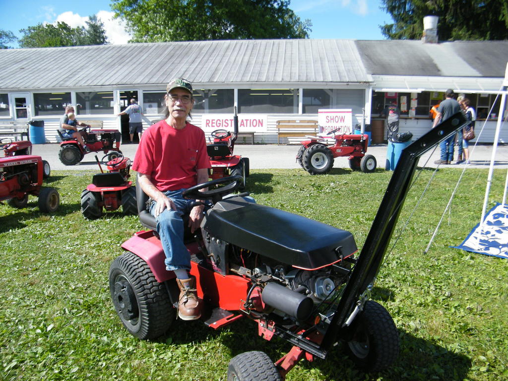

JAinVA 4,638 #3 Posted May 29, 2019 (edited) I mounted a Pred 13 on an 416-H.The base bolt pattern is way different than a Kohler.I ended up mounting the 13 horse to an Onan base plate.The hood needed to be modified to clear the carb and I ended up cutting the headlight mount out to allow for the exhaust. It helps to raise the engine to match the crank centerline of the Kohler. Edited May 29, 2019 by JAinVA Share this post Link to post Share on other sites

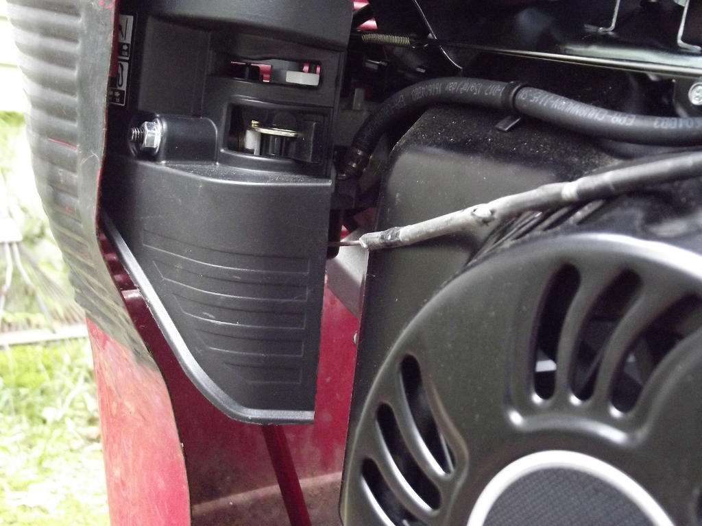

Lee1977 7,807 #7 Posted May 30, 2019 I used a 420 Predator no my home built Shortdog. This is how I hooked up the choke. There is a 1/8" metal strip with the 1/4" nuts welded to it inside the plastic. Share this post Link to post Share on other sites

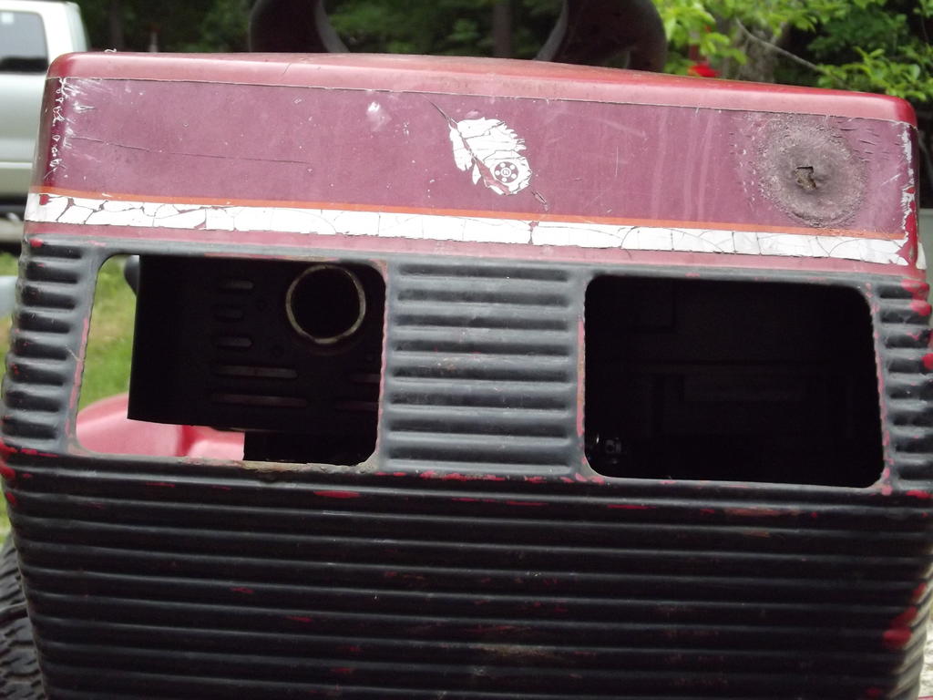

JAinVA 4,638 #9 Posted July 1, 2019 (edited) Eric, I used 1 1/8' square tube at first then switched to 1 1/8 long round spacers to make changing oil easier.While not seen the Onan plate is notched under drain fitting as well.I have run a 42" deck and there was plenty of power.No noticeable end play which is to be expected as the crank has ball bearings.The Pred is now on the 520h crane tractor,I ended up changing the exhaust so as not to burn the paint off the hood.If you plan on running a hood count on having to do some modification.If you run the stock Pred exhaust and the hood has the V brace up front it will need to be removed.I also cut the head light bucket out and the left side of the hood needs to be bulged to clear the carb.That is shown in one of the photos.I had a junk hood to ruin but a stock hood will not fit. Edited July 1, 2019 by JAinVA 1 1 Share this post Link to post Share on other sites
