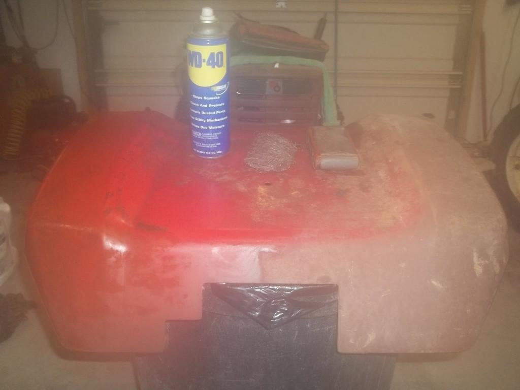

953 nut 66,573 #3 Posted May 26, 2019 I have used WD-40, 0000 Steel Wool and 600 Wet/Dry sand paper with nice results. 2 Share this post Link to post Share on other sites

JCM 11,165 #5 Posted May 26, 2019 I recently did what you are contemplating doing, I cleaned the surface with a large grout sponge with simple green cleaner and then clean water, let dry and then used a scotch brite pad to remove minor rust,clean again ,let dry and spray WD 40 on a clean rag and rub it into the original finish and have been very pleased with the results,you can take a look at the results on the topic of original patina with shiny wheels, good luck, I think you may be happy with the results. The tractor is a 1977 C-120 under JCM. Good luck. Share this post Link to post Share on other sites

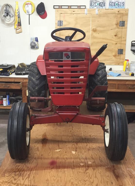

cschannuth 3,821 #8 Posted May 27, 2019 (edited) I used 0000 steel wool and Windex to clean my surfaces and then more Windex and rags to do final cleaning. Then I used a matte spray clear on it and it looked just like it did before I started, but cleaner. It wasn’t artificially shiny and it doesn’t attract dirt and still looks exactly like it did the day I applied it a couple years ago. Edited May 27, 2019 by cschannuth 4 Share this post Link to post Share on other sites
