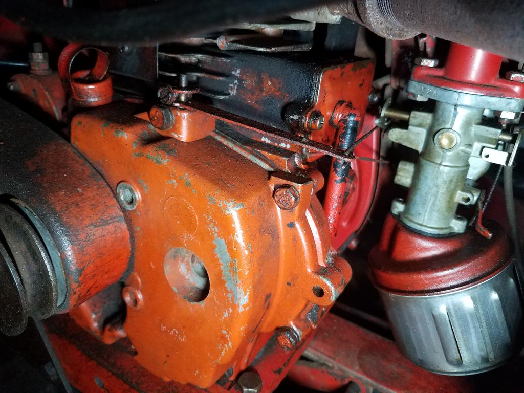

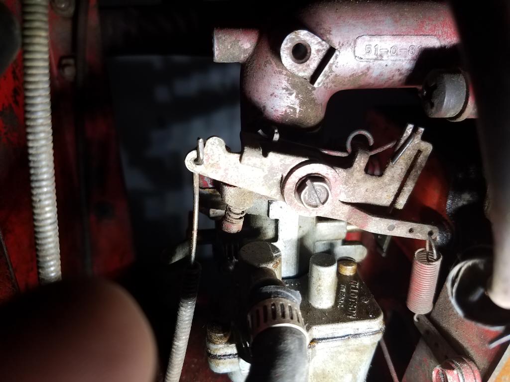

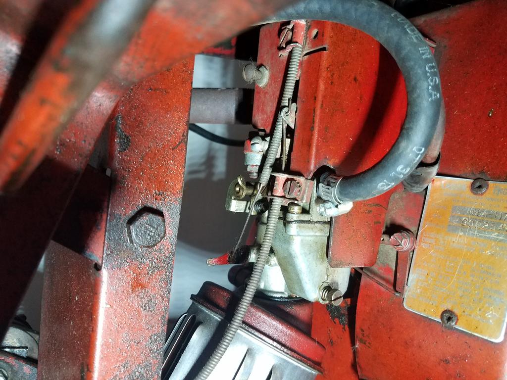

formariz 12,381 #29 Posted May 31, 2019 @Shynon Thank you. Great reference photos. 1 Share this post Link to post Share on other sites

formariz 12,381 #31 Posted May 31, 2019 @gwest_ca, Gary perhaps it would not be a bad idea to put @Shynon photos of the Tillotson linkages with the other information already existing for that carburetor. That is information that is hard to come by for the 60 Suburban unless you have a working one with that set up. Share this post Link to post Share on other sites
gwest_ca-(File Mod) 12,372 #32 Posted June 2, 2019 On 5/30/2019 at 10:17 PM, formariz said: @gwest_ca, Gary perhaps it would not be a bad idea to put @Shynon photos of the Tillotson linkages with the other information already existing for that carburetor. That is information that is hard to come by for the 60 Suburban unless you have a working one with that set up. Does this work? https://www.wheelhorseforum.com/search/?&q="Engine Lauson Carburetor"&type=downloads_file&search_and_or=or Garry 1 2 Share this post Link to post Share on other sites
formariz 12,381 #33 Posted June 3, 2019 Awesome. Thank you Garry. Share this post Link to post Share on other sites

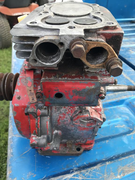

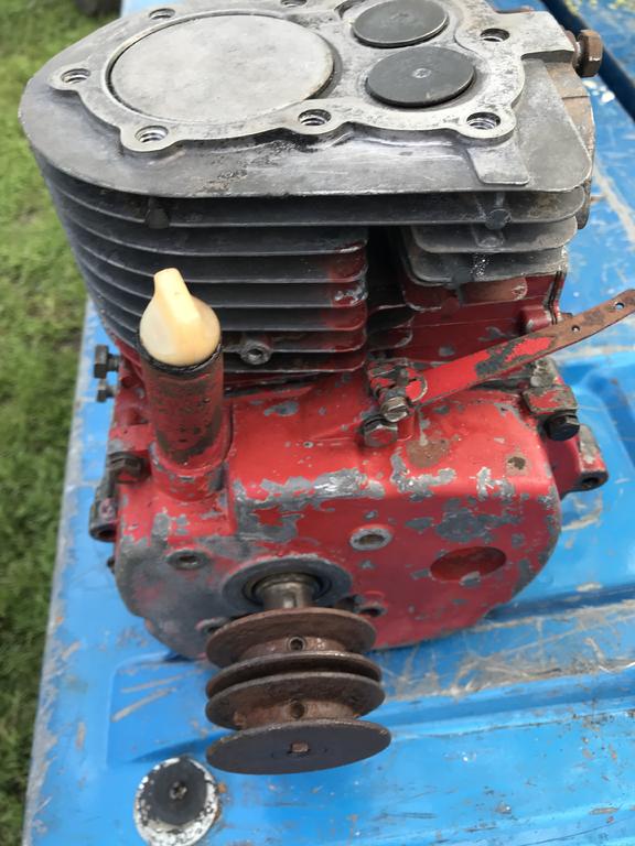

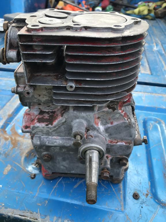

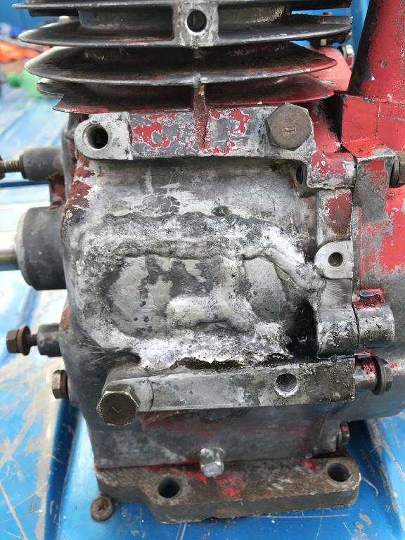

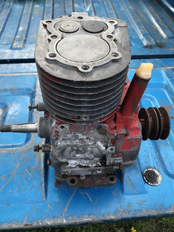

Jennifer 1,878 #34 Posted June 3, 2019 (edited) I have the engine close to being ready to get bored. Bad thing after I cleaned it up some I realize a repair job on the block hidden! What’s your thought? Also why is there treads in the block on carb. Side? Edited June 3, 2019 by Jennifer Share this post Link to post Share on other sites
formariz 12,381 #35 Posted June 3, 2019 Too many surprises on that one. There may be more. Personally I am not sure that I would invest any time or money on re boring it. That block may be seriously compromised. Probably time better spent looking for another one if you want to keep tractor original. As far as threads on carburetor side, I have seen that done before on one that came my way, an H60 where they switched things over, exhaust on right and carb on left. I am not sure how well that would workout. Exhaust valve still on wrong side that way and port and valve dimensions are not the same. Interestingly enough that engine also had all kinds of torture done to it. 1 Share this post Link to post Share on other sites
Jennifer 1,878 #36 Posted June 3, 2019 (edited) 40 minutes ago, formariz said: Too many surprises on that one. There may be more. Personally I am not sure that I would invest any time or money on re boring it. That block may be seriously compromised. Probably time better spent looking for another one if you want to keep tractor original. As far as threads on carburetor side, I have seen that done before on one that came my way, an H60 where they switched things over, exhaust on right and carb on left. I am not sure how well that would workout. Exhaust valve still on wrong side that way and port and valve dimensions are not the same. Interestingly enough that engine also had all kinds of torture done to it. I was being to wonder that my self... heart breaking I bought it because that engine! Then had it shipped to me... you win some and you lose some. If you here of one for sale I am looking... if nothing more I have learned a lot. Thanks you and everyone else for there time and knowledge !!!! Edited June 3, 2019 by Jennifer Share this post Link to post Share on other sites
