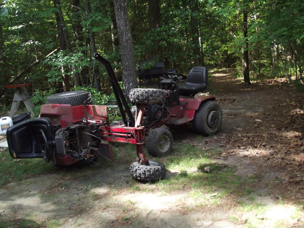

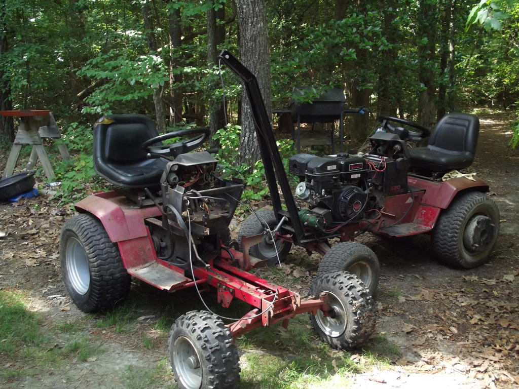

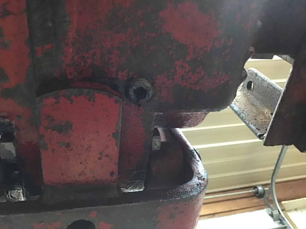

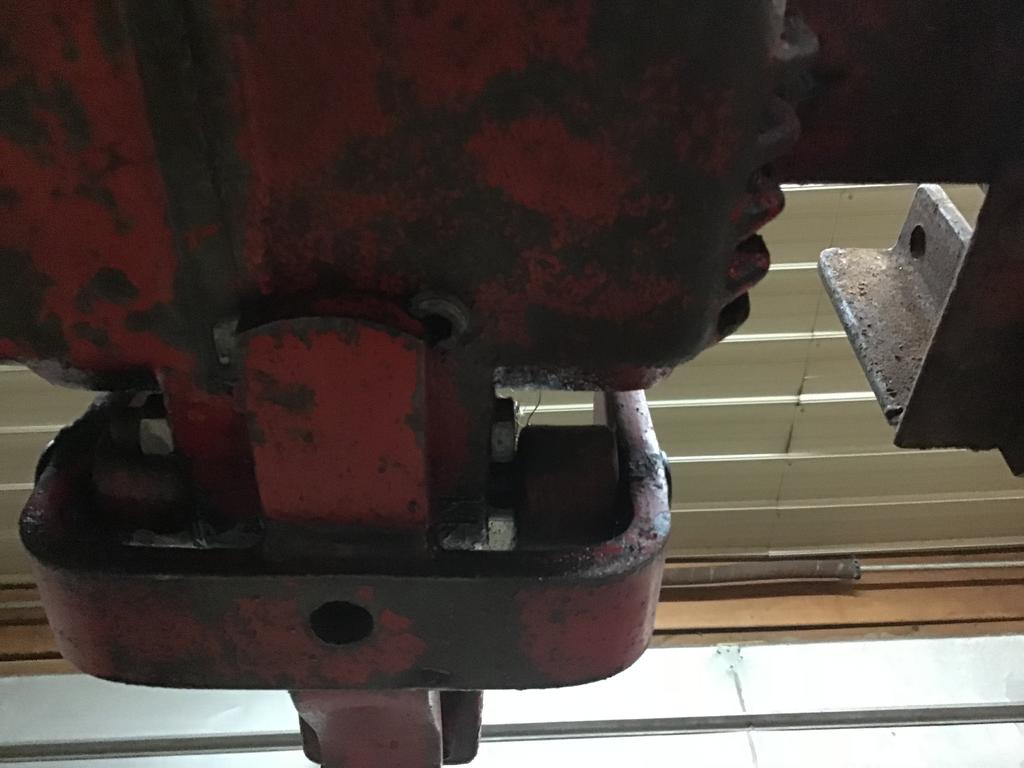

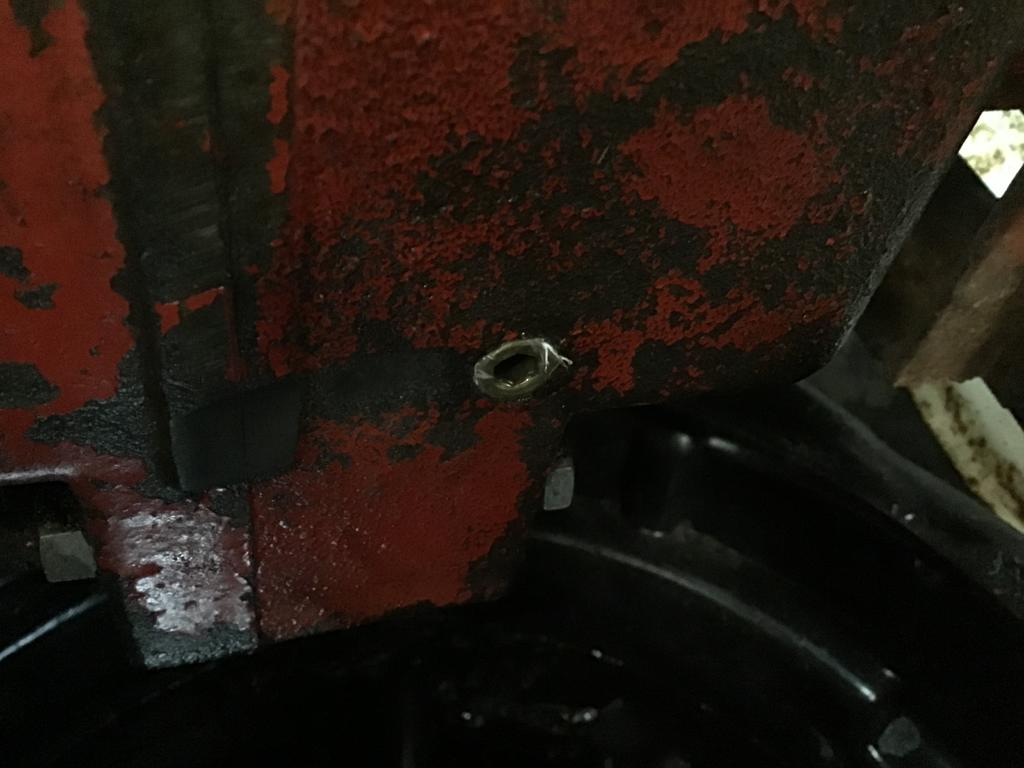

JAinVA 4,638 #1 Posted May 21, 2019 Last fall Big Ugly started leaking at both axle seals.When I went to drain the oil out the drain plug hex stripped.This tractor never saw any cover before I got it and the plug probably was never taken out before.The thought of getting under the rear of the tractor and drilling out the plug was not appealing.I have dodged hot steel shavings all my adult life.The thought of pulling the trans out was not fun either.So this made life easier.Since the engine was off already the 520 wasn't that heavy. 3 3 Share this post Link to post Share on other sites

Pollack Pete 2,273 #6 Posted May 22, 2019 I had to do the same with one of my C-175's.Lots easier drilling that plug out that way.I always replace the drain plug with an external square plug.Use Teflon tape too.Much easier to remove the next time. 2 Share this post Link to post Share on other sites
ericj 1,580 #7 Posted May 22, 2019 52 minutes ago, Pollack Pete said: Use Teflon tape too. becareful what kind of Teflon tape you use. oil will eat normal Teflon. There are some kinds that will work. When I worked for the oil company on oil burners I was told always use pipe dope becuase of this. I have also seen this first hand since then. good luck eric j 4 1 Share this post Link to post Share on other sites
ebinmaine 80,600 #8 Posted May 22, 2019 56 minutes ago, ericj said: becareful what kind of Teflon tape you use. oil will eat normal Teflon. There are some kinds that will work. When I worked for the oil company on oil burners I was told always use pipe dope becuase of this. I have also seen this first hand since then. good luck eric j I'll second that. I've seen the White, water style Teflon tape go bad in petroleum fluids. Share this post Link to post Share on other sites
clueless 3,438 #9 Posted May 22, 2019 Yellow Teflon for petroleum. 2 Share this post Link to post Share on other sites
Pullstart 71,207 #10 Posted May 22, 2019 The things you learn on this site... 1 Share this post Link to post Share on other sites
ebinmaine 80,600 #11 Posted May 22, 2019 18 minutes ago, clueless said: Yellow Teflon for petroleum. I used to think that was exclusively true but a year or two ago I tried to buy some and I bought the yellow stuff because I "knew" that was going to be correct. I got it home and discovered that it was NOT OK for use with petroleum fluids. It was natural gas tape. I don't know if it would have worked okay anyway but I brought it back to the store and got one that had liquid petroleum in writing. Share this post Link to post Share on other sites
lynnmor 9,037 #12 Posted May 22, 2019 2 hours ago, Pollack Pete said: I had to do the same with one of my C-175's.Lots easier drilling that plug out that way.I always replace the drain plug with an external square plug.Use Teflon tape too.Much easier to remove the next time. A square head plug will interfere with some implements. Even the hex socket type should be flush. Share this post Link to post Share on other sites
JAinVA 4,638 #13 Posted May 22, 2019 (edited) I used a square head brass plug .The original steel plug stuck out about an 1/8".I may get flamed for this comment but the Teflon tape is more of a lubricant than a sealer.Teflon under pressure creeps. Edited May 22, 2019 by JAinVA Share this post Link to post Share on other sites
Pullstart 71,207 #14 Posted May 22, 2019 (edited) 21 minutes ago, lynnmor said: A square head plug will interfere with some implements. Even the hex socket type should be flush. I agree that it’ll interfere with a drawbar hitch! I found a brass plug that fit flush to the case laying around in the shop because of that. As you see, I also used PTFE. Maybe I’ll have to go ahead and change that before I top it off! Edited May 22, 2019 by pullstart PTFE 1 Share this post Link to post Share on other sites
clueless 3,438 #15 Posted May 22, 2019 1 hour ago, ebinmaine said: I used to think that was exclusively true but a year or two ago I tried to buy some and I bought the yellow stuff because I "knew" that was going to be correct. I got it home and discovered that it was NOT OK for use with petroleum fluids. It was natural gas tape. I don't know if it would have worked okay anyway but I brought it back to the store and got one that had liquid petroleum in writing. Yes, it needs to say for petroleum fluids on it, oil. Don't use it on any liquid gas connections . Share this post Link to post Share on other sites
JAinVA 4,638 #16 Posted May 22, 2019 On the Eaton 1100 that plug is a country mile away from the drawbar hitch. Share this post Link to post Share on other sites
