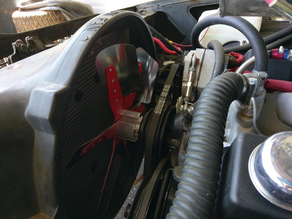

Razorback 1,148 #12 Posted June 26, 2019 Got the windshield washer system installed and working again! Went to a You-Pull-It yard and got a combination radiator expansion/washer reservoir tank and pump..... for $16!!! Then got a washer nozzle kit from O’Reilly..... all works like a champ now! Also, took the Falcon to my local shop today to get the AC system serviced, hoping that all it needed was a charge. They put it on their machine, verified pressure and vacuum were good! Added almost 2lbs of R134, now it’s good to go! The radiator shroud is missing..... hoping that the shroud that I kept from our 1981 Bronco will fit it. 1 Share this post Link to post Share on other sites

Razorback 1,148 #14 Posted June 26, 2019 28 minutes ago, ebinmaine said: I've had some older cars that had no shroud. Did yours have one originally or are you adding one? I really don’t know. Looking at the old Bronco shroud, I believe I can make it work. Might add a fan clutch while I’m at it..... 1 Share this post Link to post Share on other sites
ebinmaine 74,516 #15 Posted June 26, 2019 Fan clutch would be recommended if you know you can get a good one that doesn't seep out the back seal that faces the engine. Save you a little bit of fuel. 1 Share this post Link to post Share on other sites
Razorback 1,148 #16 Posted June 26, 2019 1 minute ago, ebinmaine said: Fan clutch would be recommended if you know you can get a good one that doesn't seep out the back seal that faces the engine. Save you a little bit of fuel. I’ll check and see where I purchased a fan clutch for my 7.3L PowerStroke several years ago. It has been a good one. Share this post Link to post Share on other sites

WVHillbilly520H 10,376 #19 Posted June 26, 2019 1 hour ago, Razorback said: I really don’t know. Looking at the old Bronco shroud, I believe I can make it work. Might add a fan clutch while I’m at it..... Honestly on your set-up there I would get one of those double electric fan/shroud sets like Jegs/Summit sells, and forget trying to get a clutch fan and shroud, I wish I had went that route on my car... I actually have an electric pusher fan plus the SFI flex fan in a shroud and still runs "warm" in "parade" traffic. 2 Share this post Link to post Share on other sites
ebinmaine 74,516 #20 Posted June 27, 2019 18 minutes ago, WVHillbilly520H said: Honestly on your set-up there I would get one of those double electric fan/shroud sets The man's got a point there. Electric fan would be more efficient and reliable... 1 1 Share this post Link to post Share on other sites
Razorback 1,148 #21 Posted June 27, 2019 Thanks for that..... you have helped convince myself that I should proceed with my original plan of installing a “3-row equivalent” aluminum radiator and a Flex-a-Lite thermostatically controlled electric fan setup like I put on our Bronco. 1 Share this post Link to post Share on other sites
ebinmaine 74,516 #22 Posted June 27, 2019 Just now, Razorback said: Thanks for that..... you have helped convince myself that I should proceed with my original plan of installing a “3-row equivalent” aluminum radiator and a Flex-a-Lite thermostatically controlled electric fan setup like I put on our Bronco. That would not be the worst decision you ever made. Share this post Link to post Share on other sites
