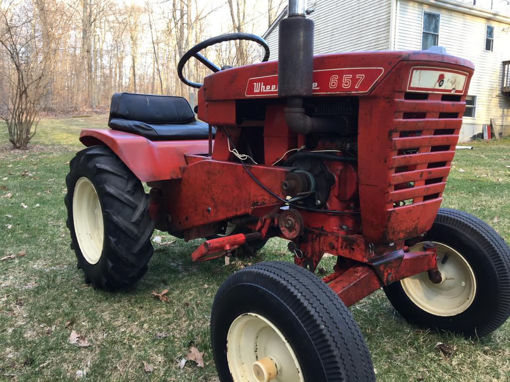

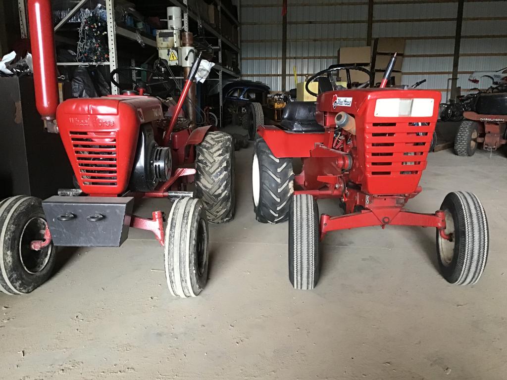

Sparky-(Admin) 24,540 #5 Posted May 13, 2019 I’m a fan of stacks. Never had the type that your looking into tho. Both my 8hp Kohlers have 1” threaded exhaust outlets. My stacks are small diameter, light and not to tall so I did not add a support. 1 Share this post Link to post Share on other sites

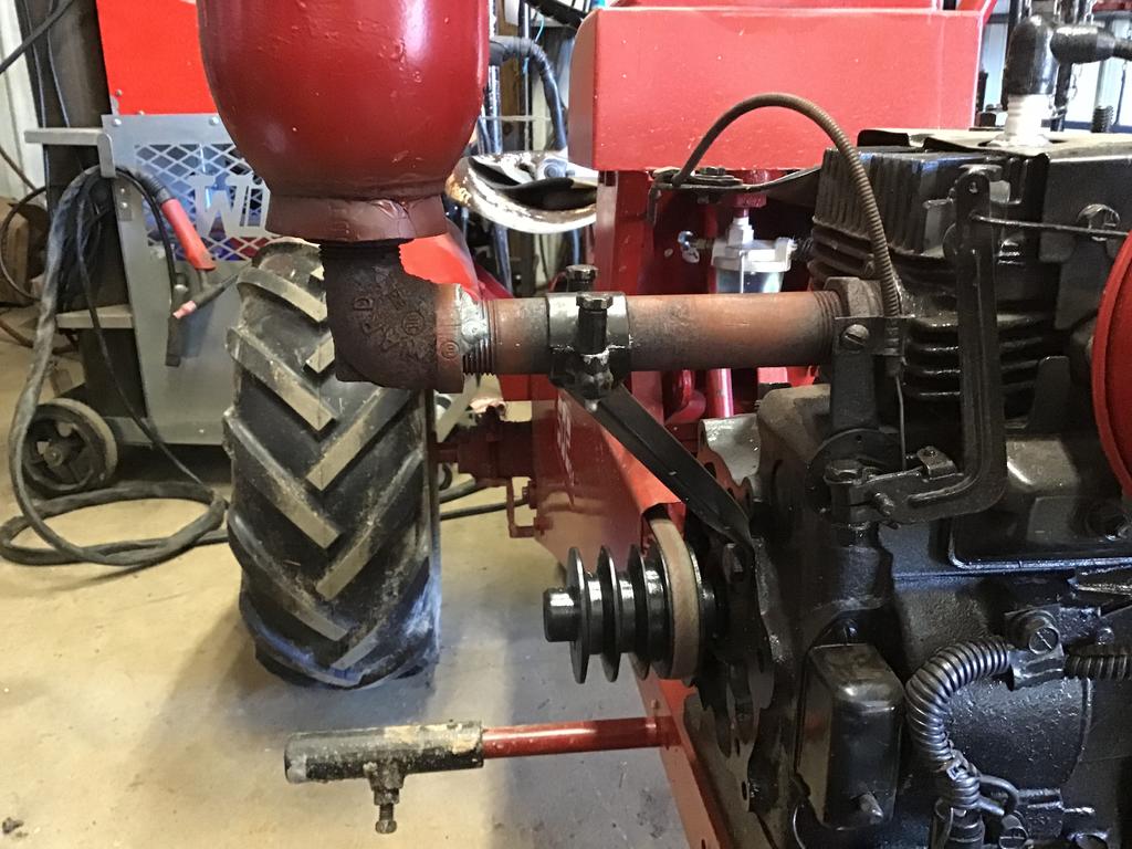

Pullstart 68,769 #7 Posted May 13, 2019 The block either has a 1” or 3/4” npt pipe thread, most likely. Putt Putt has a Cherry Bomb, and I welded the silencer core of my Honda Shadow 750 into the outlet and added a tractor flap cap. I added some support from the engine block to a two piece clamp and welded the top half of the clamp to the pipe nipple. 1 3 Share this post Link to post Share on other sites

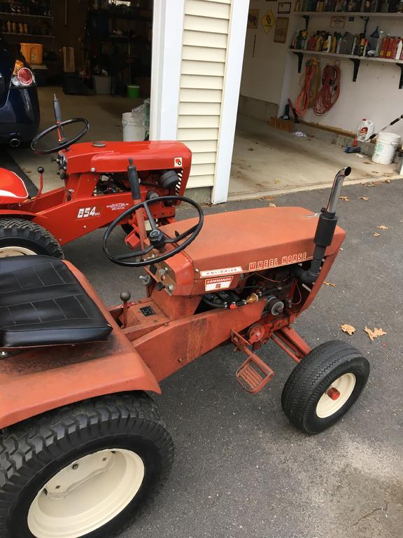

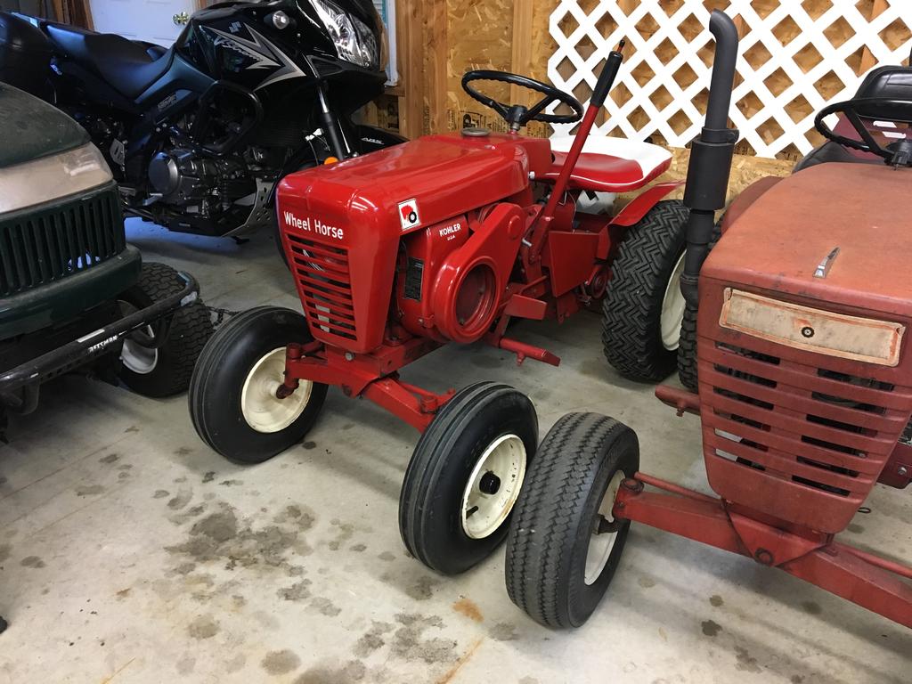

WHGuy413 2,851 #8 Posted May 14, 2019 2 hours ago, Sparky said: I’m a fan of stacks. Never had the type that your looking into tho. Both my 8hp Kohlers have 1” threaded exhaust outlets. My stacks are small diameter, light and not to tall so I did not add a support. The one on that commando looks similar to a bud Andrews stack. I have one on my 603. Share this post Link to post Share on other sites
Felix 145 #9 Posted May 14, 2019 Some nice looking exhaust there! I need to try and source some the pipe work and fittings over here. then I’ll make a start fabricating something. Some nice ideas there thanks. 👍🏻👍🏻👍🏻 1 Share this post Link to post Share on other sites
Sparky-(Admin) 24,540 #10 Posted May 14, 2019 10 hours ago, WHGuy413 said: The one on that commando looks similar to a bud Andrews stack. I have one on my 603. Good eye Matt! It is a Bud Andrews built stack. 1 Share this post Link to post Share on other sites
