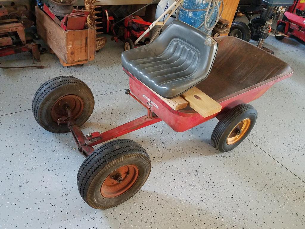

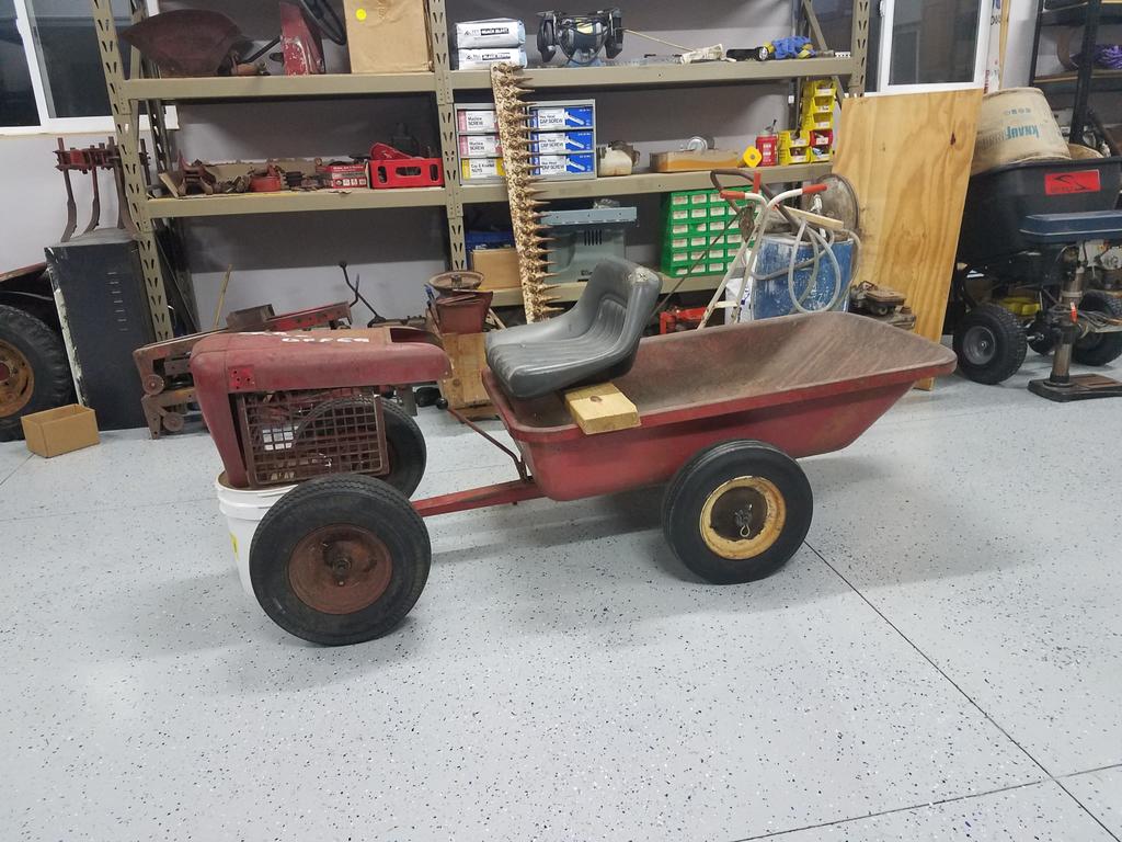

Tractorhead 9,217 #26 Posted May 12, 2019 @71_Bronco Yap, you‘re right, thinkin the same. looks close to a 1932-ford-sedan about the shape 👍 1 Share this post Link to post Share on other sites

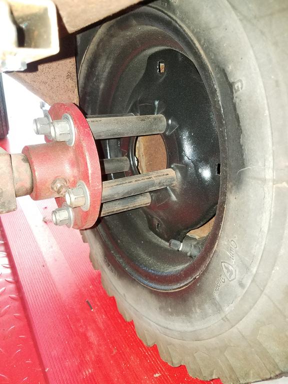

prondzy 3,890 #27 Posted May 12, 2019 5 hours ago, 71_Bronco said: The shot from the front reminds me of the '32 high boy fords. Out of curiosity, how did you extend out the rear wheels? And do you think it will be strong enough? Right now i just have spacers and they are bolted between the hub and rim, seems to be holding up right now and i have been bouncing this thing around the yard in 3rd gear. That being said i have plans to weld plates between the spacers sinilar to the WH dual spacers. 4 Share this post Link to post Share on other sites
JERSEYHAWG / Glenn 4,589 #28 Posted May 12, 2019 VERY COOOL, I like the whole concept. Glenn 1 Share this post Link to post Share on other sites
ebinmaine 80,465 #29 Posted May 13, 2019 @prondzy How much space do you have there? 4 inch? 5-inch? On one of my tractor's I have 3 inch aluminum spacers and they work perfectly fine. I think if you were to weld those together you would be in great shape. 1 Share this post Link to post Share on other sites
prondzy 3,890 #30 Posted May 13, 2019 23 minutes ago, ebinmaine said: @prondzy How much space do you have there? 4 inch? 5-inch? On one of my tractor's I have 3 inch aluminum spacers and they work perfectly fine. I think if you were to weld those together you would be in great shape. 5 in Share this post Link to post Share on other sites
bds1984 1,518 #31 Posted May 13, 2019 On 5/12/2019 at 8:25 AM, AMC RULES said: Needs more engine... thinking, big ol' Kohler twin should do it proud. Yes. K662 or K341/361. 2 Share this post Link to post Share on other sites

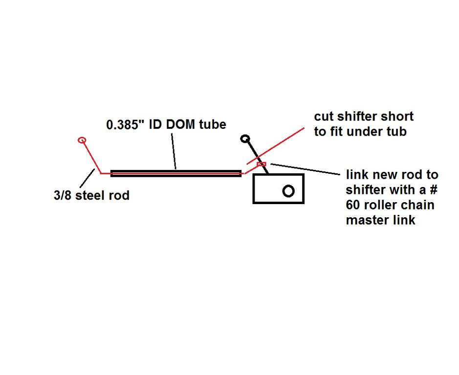

RedHorse54 578 #33 Posted May 16, 2019 (edited) That thing is awesome!! This gives me the idea to make a wheel horse "pickup truck" out of a regular round hood like an 854. The tub cart as the "bed" of the truck. I wonder how it could be done though with the transmission under the tub cart and the seat in front of the cart itself. Anyone have any ideas? Edited May 16, 2019 by RedHorse54 2 Share this post Link to post Share on other sites
wallfish 20,553 #34 Posted May 16, 2019 1 hour ago, RedHorse54 said: Anyone have any ideas? Here's a quick idea for the shifter. Had that same exact idea but the build turned into a little 2 seater clown car. Made 2 of those but never did get to the "pickup" build. The chain link to connect the long rod to the shifter will allow swivel and movement for moving it front and back in the neutral slot but it's stiff enough for the lateral movement side to side into the gears. Some creative welding on the ends of both the new rod and the shifter can make a strong connection. 4 Share this post Link to post Share on other sites
