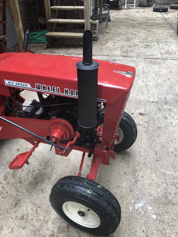

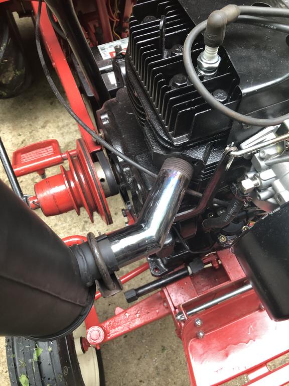

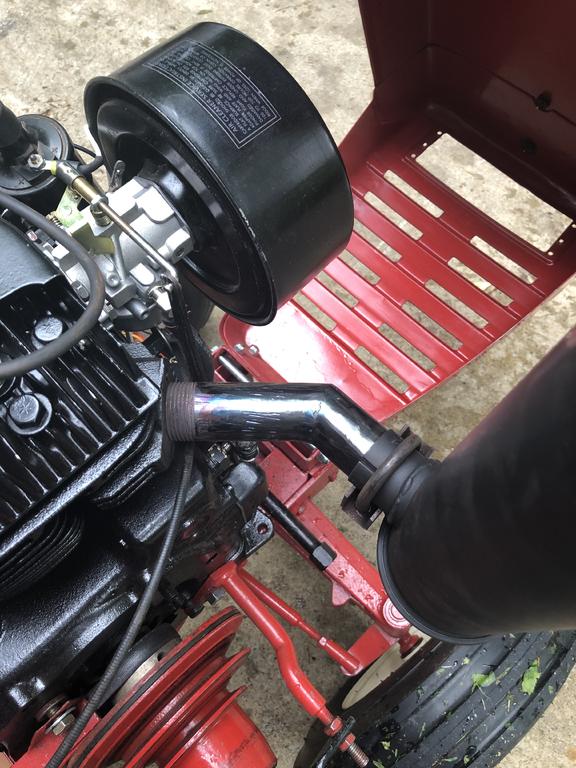

Herder 2,356 #28 Posted May 12, 2019 2 hours ago, The Tool Crib said: Just got the piece welded together today and put back on the tractor with the muffler. What a sweet sounding muffler it is! It did end up moving it back some which is what I wanted it to do. Looking Sweet! That tractor come out great. 1 Share this post Link to post Share on other sites

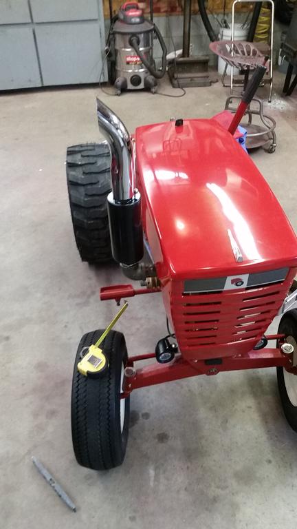

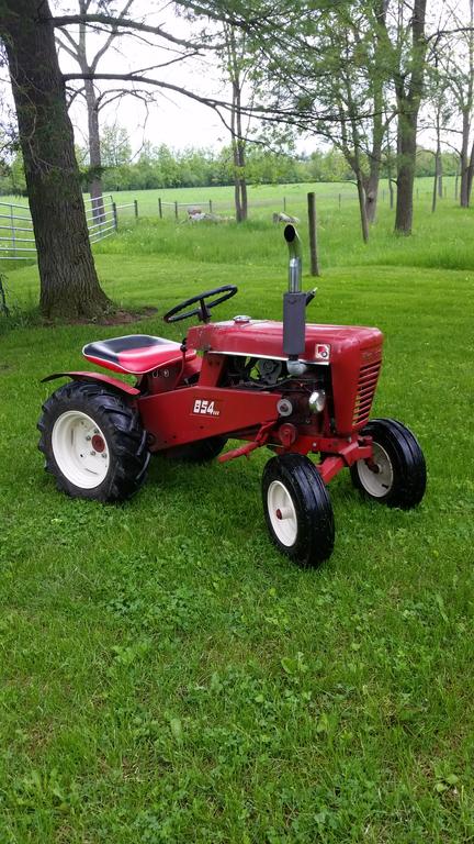

WHX?? 58,237 #30 Posted May 13, 2019 Looks nice Cribs .. I would have cheated and just used black pipe fittings but do like the custom. Nobody has mentioned these yet made and sold by Jim Kemp. a bit loud but definitely tractor sounding . Looks are hard to beat! 2 Share this post Link to post Share on other sites

The Tuul Crib 7,354 #33 Posted May 13, 2019 4 hours ago, WHX22 said: Looks nice Cribs .. I would have cheated and just used black pipe fittings but do like the custom. Nobody has mentioned these yet made and sold by Jim Kemp. a bit loud but definitely tractor sounding . Looks are hard to beat! Thanxs. That 22 1/2 degree is hard to find atleast around here . I would have had to go to the other side of town to get it so this is what l came up with. I have seen Jim Kemps mufflers still on fleabay. They do look good though! 1 Share this post Link to post Share on other sites
rjg854 13,384 #34 Posted May 14, 2019 I have 2 of Jim Kemp's stacks, one on an 8hp and the other a 16hp, both sound great. I like their sound so much, I won't use hearing protection on either of those tractors. I wouldn't think of not using hearing protection on the zero-turn. 1 1 Share this post Link to post Share on other sites

WHX?? 58,237 #38 Posted May 14, 2019 13 hours ago, rjg854 said: I like their sound so much, Ditto on Jim's stack ....I'll see about getting a video up once if I ever get it done! 1 1 Share this post Link to post Share on other sites
71_Bronco 1,072 #39 Posted May 14, 2019 Just ordered a stack from Jim Kemp. Quick question. When mounting it, should I put the stack directly into the 90 degree elbow? This will put the muffler can next to the hood (as shown in WHX22's picture). Or, should I add a piece of pipe in the vertical section, with a coupling, to get the muffler portion higher than the top of the hood? Does it make any difference? Or more of a personal preference? Thanks! Share this post Link to post Share on other sites
ebinmaine 80,776 #40 Posted May 14, 2019 Just now, 71_Bronco said: Just ordered a stack from Jim Kemp. Quick question. When mounting it, should I put the stack directly into the 90 degree elbow? This will put the muffler can next to the hood (as shown in WHX22's picture). Or, should I add a piece of pipe in the vertical section, with a coupling, to get the muffler portion higher than the top of the hood? Does it make any difference? Or more of a personal preference? Thanks! the most important thing is to try to keep the muffler at least a good solid inch away from the paint and decals. Other than that, I'm thinking personal preference. Share this post Link to post Share on other sites
rjg854 13,384 #41 Posted May 14, 2019 (edited) 11 hours ago, 71_Bronco said: How does the 8hp sound with that stack? I have a Commando 8 I need a new muffler / exhaust for, and was looking at those chrome / black ones I truly like the mellow tone it has. I don't think it's as loud as the stock muffler that the other 8hp has. And it has the look that compliments the tractor. Edited May 14, 2019 by rjg854 Add picture 2 Share this post Link to post Share on other sites
adsm08 5,167 #42 Posted May 17, 2019 Well the old muffler came off easy. I just started the engine, grabbed it with the big channel locks, and held pressure on it until it moved. The pipe not so much. It put up a valiant fight, was mutilated, the whole front of the tractor was lifted by it, the governor got knocked loose, the torch became involved, but in the end it did come out. I called it quits and went to Loads for a longer piece of pipe. I'll finish it tomorrow. Share this post Link to post Share on other sites
The Tuul Crib 7,354 #43 Posted May 17, 2019 I had the same problem with Irv The short pipe was a bugger to get out. I had visions of cracking the head. Pipe wrench heat and tapping repeatedly it broke loose! Phew! Share this post Link to post Share on other sites
ET160 30 #44 Posted May 18, 2019 On 5/16/2019 at 9:49 PM, The Tool Crib said: I had the same problem with Irv The short pipe was a bugger to get out. I had visions of cracking the head. Pipe wrench heat and tapping repeatedly it broke loose! Phew! I had a bad time, too. I used a torch and a long bar over the pipe wrench. Share this post Link to post Share on other sites
The Tuul Crib 7,354 #45 Posted May 18, 2019 10 hours ago, ET160 said: I had a bad time, too. I used a torch and a long bar over the pipe wrench. Send us some pics of what you have done! Share this post Link to post Share on other sites
adsm08 5,167 #46 Posted May 20, 2019 On 5/16/2019 at 9:49 PM, The Tool Crib said: I had the same problem with Irv The short pipe was a bugger to get out. I had visions of cracking the head. Pipe wrench heat and tapping repeatedly it broke loose! Phew! I gooped antiseize all over the head connection, ran the engine hot again until it melted into the threads, and fought with it. Eventually I got it to go tighter, and then it came out easy. I just wish that had happened BEFORE I knocked the governor out of whack. Although now that I had to reset it, which wasn't hard at all, the throttle cable moves much nicer. 1 Share this post Link to post Share on other sites
ebinmaine 80,776 #47 Posted May 20, 2019 2 minutes ago, adsm08 said: Eventually I got it to go tighter, and then it came out easy. That reminds me of a really neat and very special trick that is so incredibly simple but highly valuable. Anywhere in the northern half of the country we have to deal with rust and corrosion on steel or aluminum or other metals. Back about 25 years ago I learned from a younger auto tech that he was told by a mentor of his... You can almost NEVER loosen something but you can almost ALWAYS tighten it. 1 Share this post Link to post Share on other sites
adsm08 5,167 #48 Posted May 20, 2019 On 5/12/2019 at 4:08 PM, The Tool Crib said: Just got the piece welded together today and put back on the tractor with the muffler. What a sweet sounding muffler it is! It did end up moving it back some which is what I wanted it to do. Where did you get that clamp? I have my muffler secured pretty well right now, but I could not find any exhaust clamps that small. Share this post Link to post Share on other sites
ebinmaine 80,776 #49 Posted May 20, 2019 (edited) 8 hours ago, adsm08 said: Where did you get that clamp? I have my muffler secured pretty well right now, but I could not find any exhaust clamps that small. I got one like that from my local NAPA... Warehouse, not store. Many automotive parts places sell those but do not keep them in stock. Tell them you are looking for a catalytic converter clamp and that may get you closer. You'll want to try two or three different sizes to get the best fit. The size on the box does not necessarily dictate pipe sizes. Edited May 20, 2019 by ebinmaine Share this post Link to post Share on other sites
The Tuul Crib 7,354 #50 Posted May 20, 2019 1 hour ago, adsm08 said: Where did you get that clamp? I have my muffler secured pretty well right now, but I could not find any exhaust clamps that small. It was on the muffler when l picked the motor up from a friend. Have you tried tractor supply? Share this post Link to post Share on other sites
