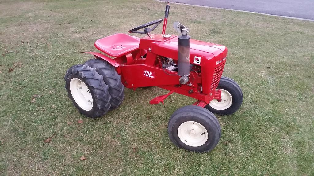

WHX?? 58,237 #2 Posted May 6, 2019 Sounds like you need a cub muffler... Tom @Shynon turned me on to them a few years back and they have a mellow tone and look nice. 4 Share this post Link to post Share on other sites

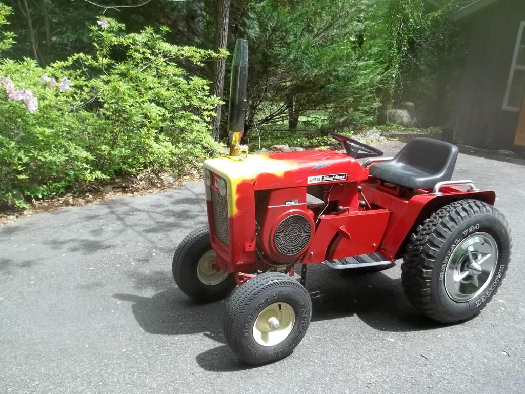

953 nut 69,574 #5 Posted May 6, 2019 A Harley Davidson muffler will give you a deep rich tone. 4 4 Share this post Link to post Share on other sites

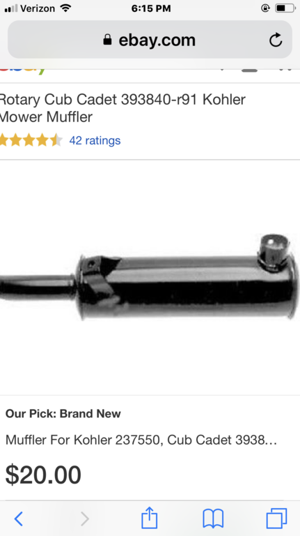

ET160 30 #13 Posted May 11, 2019 How about this one: https://www.ebay.com/itm/MUFFLER-FOR-KOHLER-TECUMSEH-OR-BRIGGS-AND-STRATTON-Inlet-outlet-are-reversible/121200272163 Share this post Link to post Share on other sites
ebinmaine 80,773 #14 Posted May 11, 2019 I can't comment on that one specifically because I've never heard it. The reason that we like the Cub mufflers in particular is because they are very quiet Share this post Link to post Share on other sites

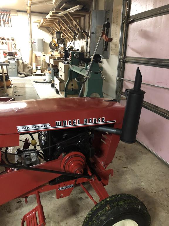

The Tuul Crib 7,354 #20 Posted May 11, 2019 1 minute ago, Herder said: Haven’t done much yet with this. Here is what I have so far. Have to do some thinking for this one. News at 11. Lol! 2 1 1 Share this post Link to post Share on other sites
ebinmaine 80,773 #21 Posted May 11, 2019 14 minutes ago, The Tool Crib said: Haven’t done much yet with this. Here is what I have so far. Have to do some thinking for this one. News at 11. Lol! Randy I think about the only thing I would change on that is maybe to put a 45-degree elbow off the engine so as to get that pipe coming straight out from underneath the hood. Otherwise that looks fantastic! 1 Share this post Link to post Share on other sites
The Tuul Crib 7,354 #22 Posted May 11, 2019 7 minutes ago, ebinmaine said: Randy I think about the only thing I would change on that is maybe to put a 45-degree elbow off the engine so as to get that pipe coming straight out from underneath the hood. Otherwise that looks fantastic! Yeah Eric that’s exactly what I was thinking I’m going to cut actually a 22 1/2° to make it come out straighter. Share this post Link to post Share on other sites
ET160 30 #23 Posted May 12, 2019 That does look cool. What extensions did you run? Is it just threaded pipe? Share this post Link to post Share on other sites
ebinmaine 80,773 #24 Posted May 12, 2019 2 minutes ago, ET160 said: That does look cool. What extensions did you run? Is it just threaded pipe? Just standard black iron pipe works great. Same as you'd use for gas pipe or a zillion other things. 1 Share this post Link to post Share on other sites
The Tuul Crib 7,354 #25 Posted May 12, 2019 20 hours ago, Herder said: Just got the piece welded together today and put back on the tractor with the muffler. What a sweet sounding muffler it is! It did end up moving it back some which is what I wanted it to do. 2 7 Share this post Link to post Share on other sites
