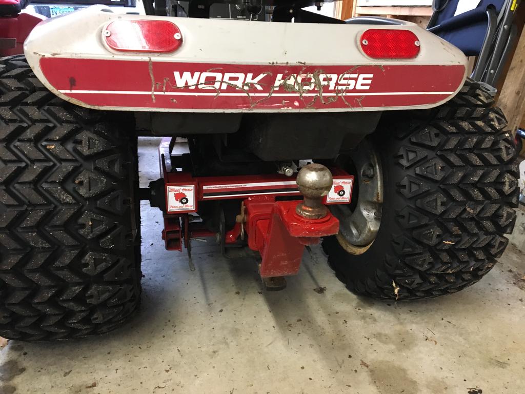

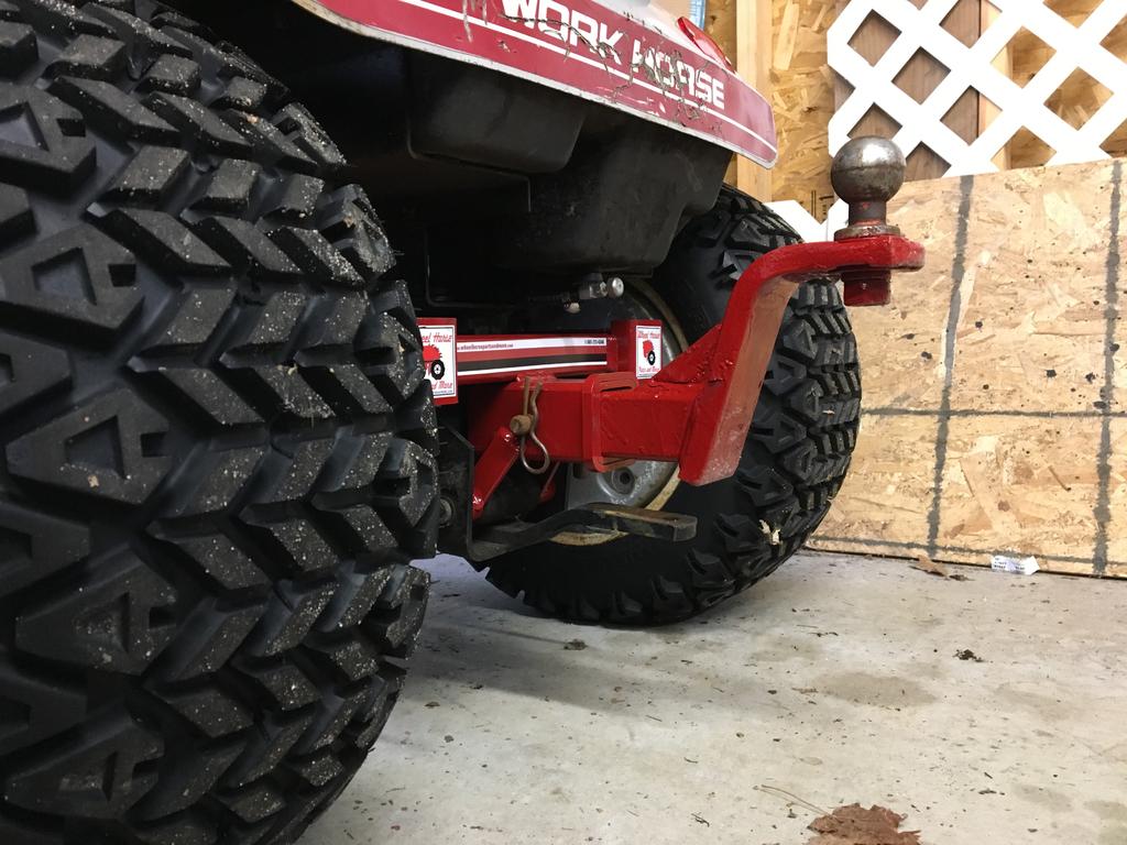

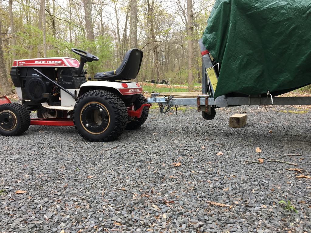

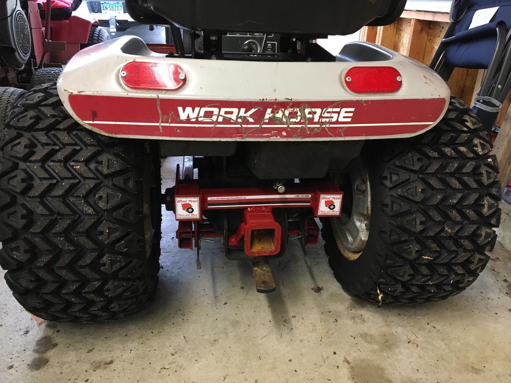

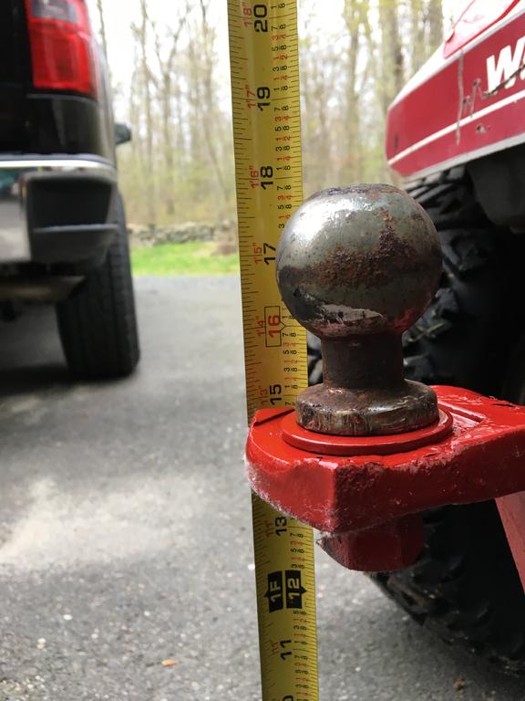

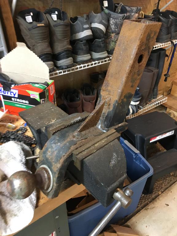

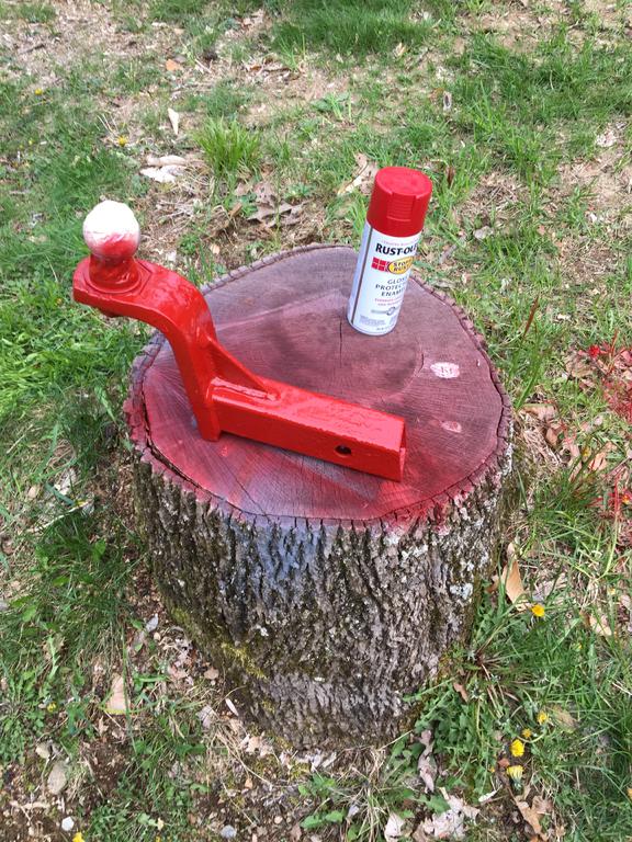

Sparky-(Admin) 26,691 #1 Posted May 3, 2019 Not exactly new, bought from @wheelhorseman at last years show. Put the hitch on awhile back....and yesterday I finally flipped the ball on one of my draw bars so I could move my boat. The drawbar is a 5-1/4” drop which when flipped gave me about 18” to the top of the ball. Went with a 1-7/8” ball since it’ll work for my 2” hitch equipped trailers as well. Pics of course... 8 3 Share this post Link to post Share on other sites

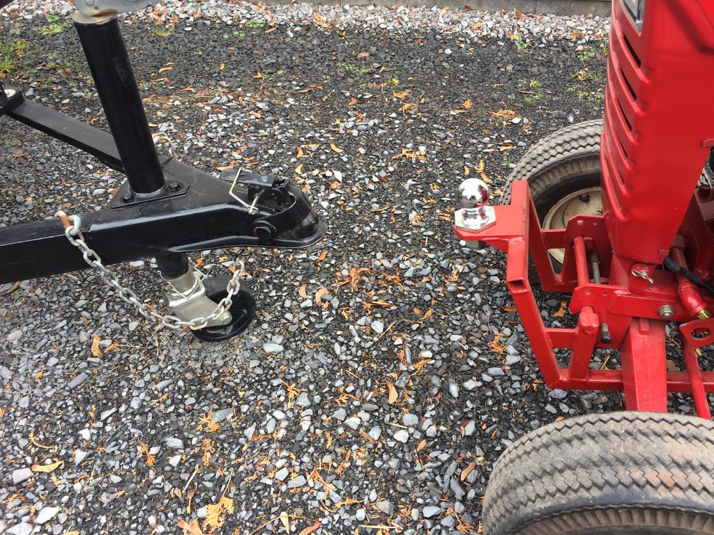

squonk 48,330 #3 Posted May 3, 2019 Home made front ball adapter thingy. I like to see where I'm going! 4 Share this post Link to post Share on other sites
Stormin 9,988 #4 Posted May 3, 2019 4 minutes ago, squonk said: Home made front ball adapter thingy. I like to see where I'm going! I've made something similar. Only uses the front tachamatic. No photo' though. Share this post Link to post Share on other sites
