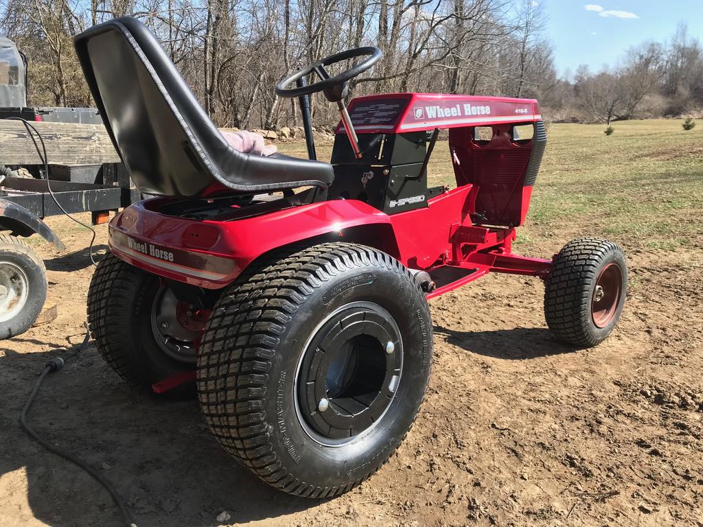

bds1984 1,519 #5 Posted May 1, 2019 There is a member here who has a 60" deck on his 416-H but he has the 6-inch wheels on it to clear it. I have a swept axle on my C165 and can definitely put a 60" deck on it. When I had my C195 w/60" deck, I was able to swap that deck on my C165 just for giggles. Share this post Link to post Share on other sites
c-series don 12,656 #6 Posted May 3, 2019 That would be me! I have the 416 with factory six inch wheels, and 60” deck. Honestly it will turn about 90% until they hit. 2 1 Share this post Link to post Share on other sites

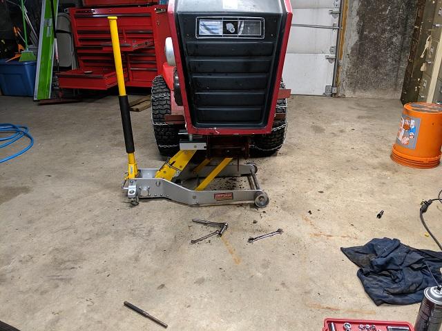

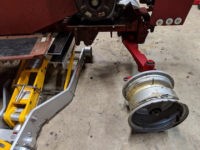

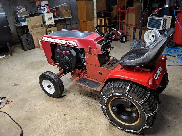

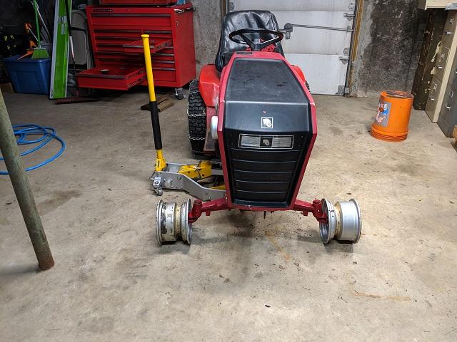

WildmanC120 615 #7 Posted May 4, 2019 I am currently working on this swap on my C-161 Twin. All I have to do if mount my tires to the rims and get a set of tie rods made up. I sent an email to wheel horse parts to see if he will make me a set of tie rods so I do not have to change the steering shaft. 1 Share this post Link to post Share on other sites

WildmanC120 615 #12 Posted August 15, 2020 3 hours ago, sgtsampay said: I know this is an old thread, but I’m curious if the original author ever got the 60in mower deck to work? I got mine to work. Just make sure you have enough horse power and the forward swept axle conversation. Share this post Link to post Share on other sites
sgtsampay 166 #13 Posted August 16, 2020 (edited) 22 hours ago, WildmanC120 said: I got mine to work. Just make sure you have enough horse power and the forward swept axle conversation. Thank you so much for the video. Looks like it working well. I have some questions: what engine is powering this? Is it still the 22hp predator? How is it lasting? it seems like you can’t drive to fast. how fast can you mow? Like how many acres you mowing and how long about does it take? Thanks for answering my questions. Edited August 16, 2020 by sgtsampay Share this post Link to post Share on other sites
