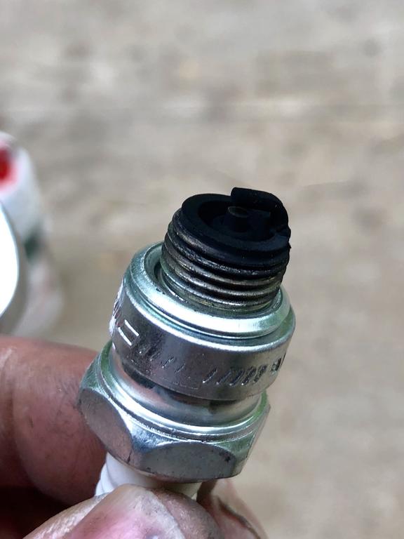

The Tuul Crib 7,354 #1 Posted April 28, 2019 Been trying to get my K321 running. I can get a fairly smooth idle but when I throttle up I sputters like crazy. I’ve tried setting the float several times and still the same thing. Its puffing out black smoke and the plug is black as well. It’s definitely on the rich side. Any ideas? Share this post Link to post Share on other sites

The Tuul Crib 7,354 #5 Posted April 28, 2019 New plug black as coal. Share this post Link to post Share on other sites
wallfish 20,031 #6 Posted April 28, 2019 It doesn't lean out at all when you tighten the high speed screw? 1 Share this post Link to post Share on other sites
The Tuul Crib 7,354 #7 Posted April 28, 2019 1 hour ago, wallfish said: It doesn't lean out at all when you tighten the high speed screw? No its not helping at all . Im going to try new points and condenser and see if that helps. Share this post Link to post Share on other sites
