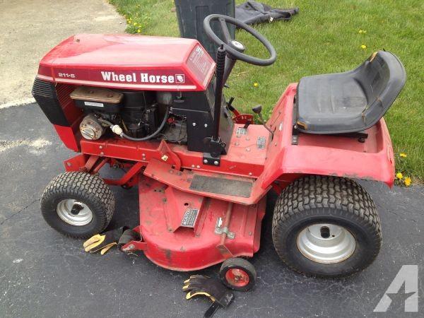

bizon 30 #1 Posted April 28, 2019 Hi, to spare my 416-8 a bit i have bought a 211 witch is complete and in good shape but differental colours , not original engine and brake has broken 😁 So this will be the mudmower and the 416-8 will be original as much as possible to mow and haul things.. now finaly on topic: who has expirience with the 211? Is it something usefull and loyable like the older and bigger brother? Ive seen that the rear axle is less thick and the diff/gearbox is aluminium.. the moweek is complete but has another system to hang on the chassis Could it be rebuilded easy to fit on the 416? It also has a vanguard V2 15hp The sound of that is like heaven 😁 here is a example picture Share this post Link to post Share on other sites

953 nut 69,164 #3 Posted April 28, 2019 1 hour ago, bizon said: moweek is complete but has another system to hang on the chassis Could it be rebuilded easy to fit on the 416? You are correct about the drive system on the mower being different. I have never done this, but I understand that the center (double) pulley can be changed out along with the lift system from your 416 deck and it will then work on the 416. Pull them both off, set them side by side and see what you think. 1 Share this post Link to post Share on other sites
Tractorhead 9,217 #4 Posted April 28, 2019 Hi bizon, Depending on your skill‘s it can be reworked to fit. Additionally a longer belt and you‘re done. On the other hand i‘m not sure, if it will be a good idea to rework the Mowerdeck. I have also a 200 series tractor, witch in my case not only as a mower is used, it runs pretty good. i expanded mine 212 with a selfmade FEL. For stronger things i use my „Beast“, (what shall be similar to your 416) because the 212 doesn‘t have enough weight for plogh or something like that. I just have troubles on weight with my 212, they be homemade, because of the FEL. On stronger slopes they driven, the Frontaxle tends to roll, because the weight of my FEL will get a touch too much weight into the front. The ability of the Frontaxle to balance uneven way‘s given the rest weakness for a flip on my machine. Without my FEL i never had any issues on mowing any slope lawn. i would use it as you self suggested, to save your 416 for spare or better uses if you have the place for. Share this post Link to post Share on other sites

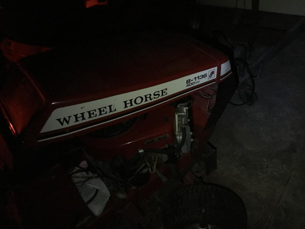

bizon 30 #11 Posted April 29, 2019 Hahaha invention is keep going forward ! 😛 The original rear brake is gone ! So i thing i am going to make a brake disc from an child atv on that.. the front axle will do for the moment but probably if the rest stays alive i will make one with thaction or with brakes from a atv of trailer cause i have atv 8" wheels with 4*100 like vw cars 🤭 Just got this winner home it lis not a 200 like a thougt Share this post Link to post Share on other sites
