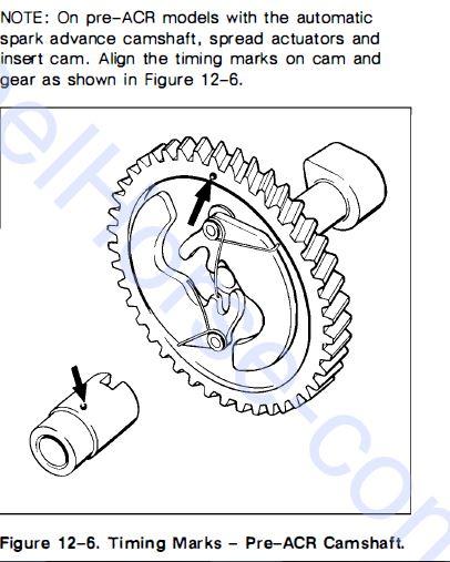

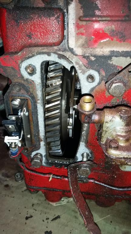

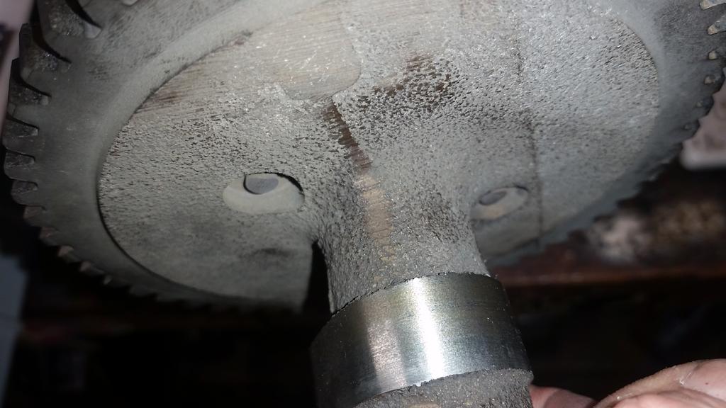

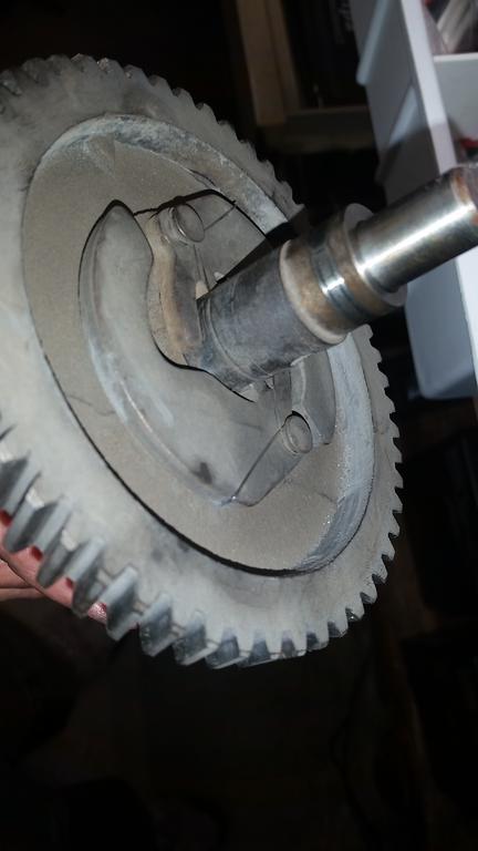

WHX?? 57,470 #1 Posted April 19, 2019 In a recent rebuild of a 241 10hp I noticed the cam did not have the ACR cam but did have the spark advance on it. Pics one and two. A second 241 that was off the same year same model tractor (1055's) did have the ACR cam. Pics three and four. My thought is Kohler changed the cam they used sometime in '65? It doesn't appear that a PO has been in either motor but only God and a PO knows that fer sure! I used the spark advance cam in my rebuild but had I known I had the ACR cam I might have used that one instead. Question is what would have been the better cam to use and why did Kohler switch from one to the other? 1 Share this post Link to post Share on other sites

WHX?? 57,470 #9 Posted April 20, 2019 Thanks for the schooling fellas. To add further confusion manual says there are timing marks on the cam. I triple checked this when assembling and found no such marks. 1 Share this post Link to post Share on other sites
