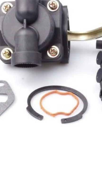

The Tuul Crib 7,354 #1 Posted April 19, 2019 Where does this snap ring belong? Can anyone shed some light on my dilemma? These don’t come with instructions Of course I can figure everything else out but this snap ring has me baffled !! Share this post Link to post Share on other sites
Herder 2,356 #2 Posted April 19, 2019 Baffling!! I have never see a snap ring used in the install of a fuel pump. And it's too big for anything in the fuel system. It's your lucky day you gotta freebie. Share this post Link to post Share on other sites
The Tuul Crib 7,354 #3 Posted April 19, 2019 1 minute ago, Herder said: Baffling!! I have never see a snap ring used in the install of a fuel pump. And it's too big for anything in the fuel system. It's your lucky day you gotta freebie. Every fuel pump on eBay like this has the same ring ! This does not make any sense to me ! Share this post Link to post Share on other sites

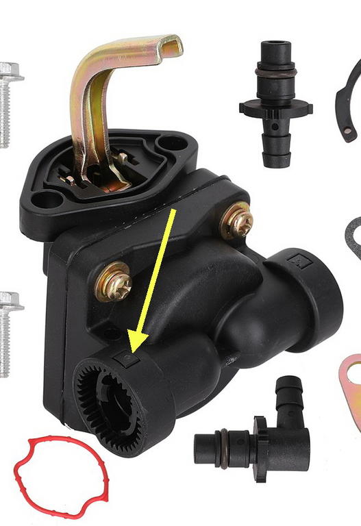

chip61 666 #7 Posted April 19, 2019 I'm not a fan of this setup, but it is used to depress the "buttons" when you install the fittings on the pump body. Depress the "buttons" with the snap ring, install the fitting at the angle you need and remove the snap ring. 5 Share this post Link to post Share on other sites
JCM 11,165 #8 Posted April 19, 2019 @chip61 I could not for the life of me remember what that snap ring was for until your post, now I remember using that when I replaced a pump 3 years ago on my C-165-8. 1 Share this post Link to post Share on other sites
The Tuul Crib 7,354 #9 Posted April 19, 2019 So do you remove the four screws on the diagram and disassemble to do this ? Share this post Link to post Share on other sites
chip61 666 #10 Posted April 19, 2019 No, look at the pump where the fittings go and you will see 2 small square indentations opposite each other. Use the snap ring to depress those and the fitting will pop right in, then remove the snap ring to lock the fitting in place. 3 Share this post Link to post Share on other sites
rmaynard 17,218 #11 Posted April 19, 2019 2 minutes ago, chip61 said: No, look at the pump where the fittings go and you will see 2 small square indentations opposite each other. Use the snap ring to depress those and the fitting will pop right in, then remove the snap ring to lock the fitting in place. 3 Share this post Link to post Share on other sites

JoeM 10,031 #16 Posted April 19, 2019 It is handy if you choose the re-index the fittings. Share this post Link to post Share on other sites
