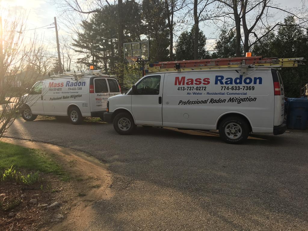

wallfish 20,724 #15 Posted April 19, 2019 (edited) Windex for me Terry made my van decals too Edited April 19, 2019 by wallfish 7 Share this post Link to post Share on other sites
