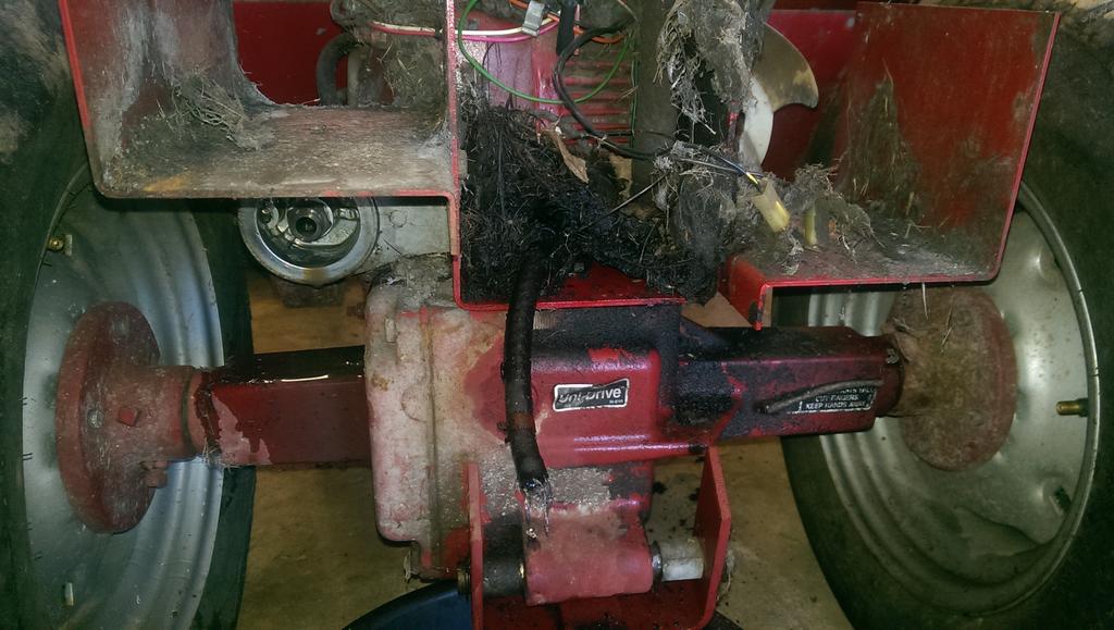

Stepney 2,356 #4 Posted April 15, 2019 27 minutes ago, peter lena said: looks like a solid unit, in addition to a BASELINE TOTAL SERVICE , GO AFTER THE ENGINE COOLING INTAKE AREA, often plugged up with debris, leading to rear cylinder over heating . seafoam your fuel , change filter , greasing and oil changing everything. show that horse some love , looks like it will benefit from it , pete Already went about that. Shrouds were mostly clean, some chaff in the front cylinder. Nothing alarming. The hydro was another deal entirely.. between under the frame and the rear end I pulled a literal trash bag full of debris. I have a feeling the knock is a buildup of carbon in the head,.. hoping its not the cam key-way failing, or the valve seats.. it's a pretty loud bit of noise. Engine's coming out in a few weeks when I find the time. For now it's just parked in the shed. 1 Share this post Link to post Share on other sites
peter lena 10,047 #5 Posted April 15, 2019 i would bet the debris is from a r/d mower deck,if you are going to use one , you can bolt on a full width discharge rubber strip to deflect the grass to ground. hopefully that knock is carbon , in addition to fuel flow cleaning you can get ethanol additive that might help. good luck with that , pete Share this post Link to post Share on other sites
Stepney 2,356 #6 Posted April 15, 2019 This has a 48"SD actually, 42" wont even fit on it. Wheels hit the back tires. The guy just never cleaned it. That and with a slight leak at the hydro valve .. just built up over the years. Share this post Link to post Share on other sites

WVHillbilly520H 10,379 #9 Posted April 15, 2019 1 hour ago, Stepney said: This has a 48"SD actually, 42" wont even fit on it. Wheels hit the back tires. The guy just never cleaned it. That and with a slight leak at the hydro valve .. just built up over the years. They are built like a 520H same 8.5" wide wheels (but a 42" RD will work "at least I have seen a couple pictures here on RS" just not a SD) and the Eaton 1100 transaxle, most people (including myself) usually spill oil when topping off or refilling from a change with the seat pan on you really can't see where all that oil and chaffe/dust ends up. 1 Share this post Link to post Share on other sites
