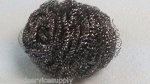

JoeM 10,317 #5 Posted April 12, 2019 I looked around and the MC guys use Stainless steel pads, They say like the Brillo pads used to scrub pots etc. I was hoping to get something in the outer perimeter of the muffler head to calm it down. going to look under the sink today! 3 Share this post Link to post Share on other sites

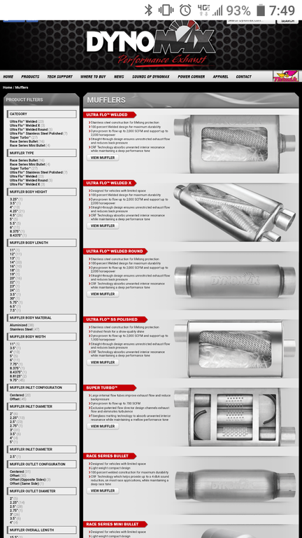

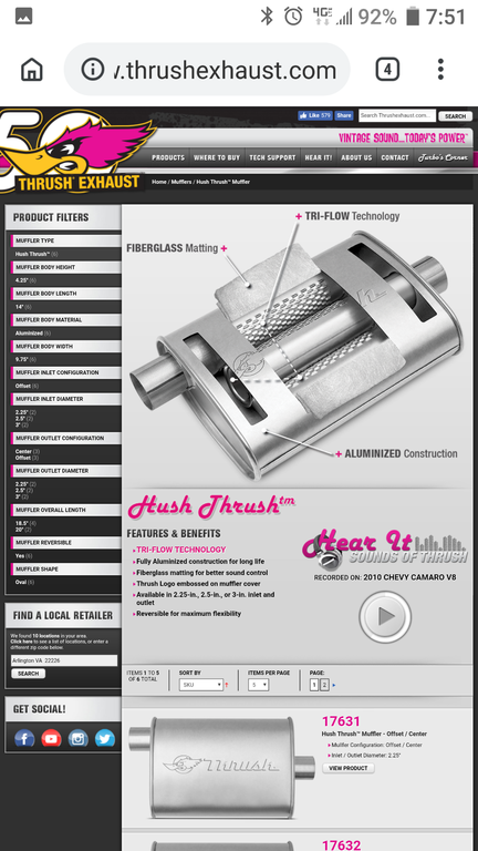

WVHillbilly520H 10,379 #6 Posted April 12, 2019 I work for one of the top aftermarket exhaust makers, just like Bob @rmaynard said the fiberglass is loosely blown in between the shell and the louvers or perf tubes "Dynomax" line, the other thing is a solid sheet of fiberglass (much like a diaper) that is wrapped around the internal louver tube assembly then the stuffed into the preformed shells (those would be our "Thrush" line. 2 2 Share this post Link to post Share on other sites
JoeM 10,317 #7 Posted April 12, 2019 found this stuff on evil bay. I did cop some Brillo from under the sink going to give it a try today I hope. Before I spend any cash on the real deal. Stainless steel wool, Type AISI 434 (316L -special order) . Highly Resistant to Exhaust Acids and High Vibration, Making it an Excellent Material for Muffler Baffling 2 Share this post Link to post Share on other sites
Stepney 2,356 #8 Posted April 12, 2019 We run a 6hp Foos hit and miss engine with a muffler packed pretty good full of steel wool. You'd never know it was running. As for a small high speed engine, I have never tried that. I've got an old Maytag 1 cyl that also has some steel woll in the exhaust hose come to think of it. 2 Share this post Link to post Share on other sites
oliver2-44 11,791 #9 Posted April 12, 2019 I thought about doing the same with Brillo pads, but remembered regular steel wool (like in Brillo pads) will burn very profusely. We used them in scouts to help start a fire with flint and steel as they can ignite with a spark. Be careful. The steel wool in muffler packing is stainless steel, it will not ignite. 1 Share this post Link to post Share on other sites

JoeM 10,317 #13 Posted April 12, 2019 (edited) I made up an adapter using a 1 inch flat washer and mig welded a pipe sleeve in place to accept the muffler. I lightly stuffed about half a brillo pad into the opening, it did help, stopped the crackle but still to loud. It didn't melt down running wide open for 5 minutes. I need to look closer and try to insert around the inner tube, surgery is necessary. I will post if I try. Edited April 12, 2019 by OILUJ52 1 Share this post Link to post Share on other sites
