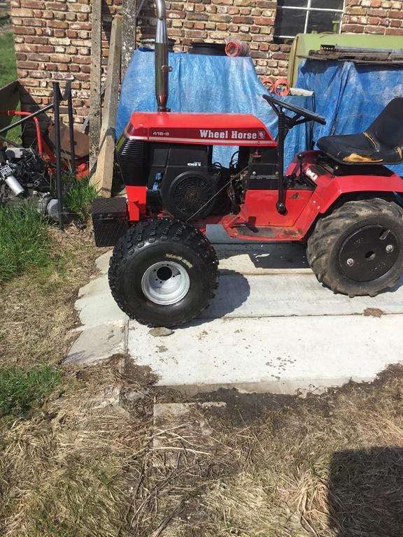

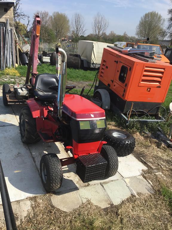

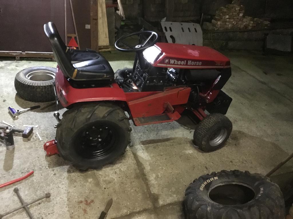

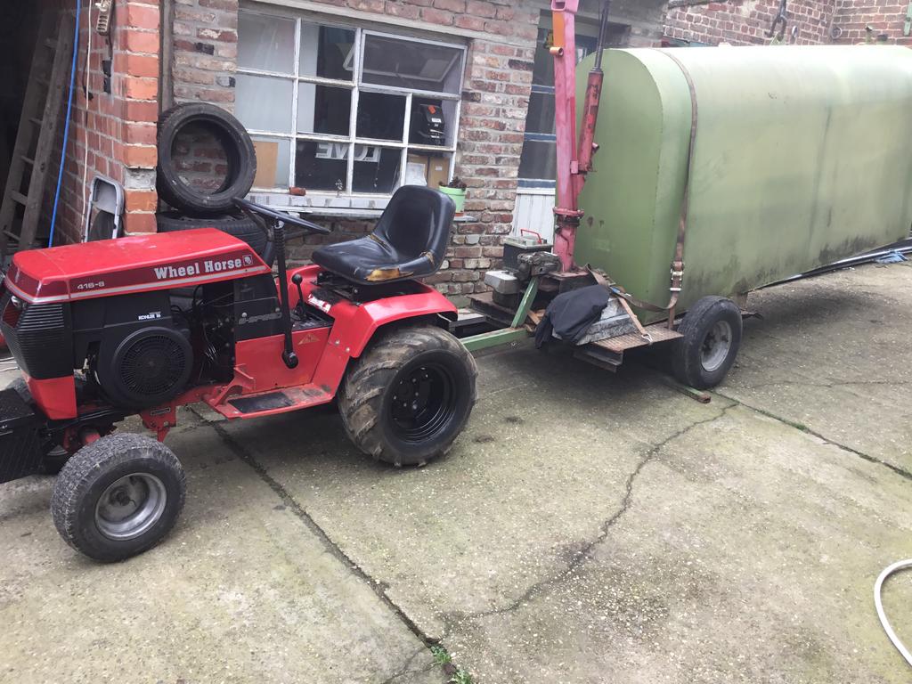

The plan with the wheelhorse is to  use it for my yard  and to pull things..  also i have wached many mudmower movies and that inspires me , so i want to make a mud tractor    A combination of a mudmower and a still usefull  and lovely tool
here are some pics       I have allready maked a tractor exhaust from a ( obviously) american harley, changed the tires and  repainted the hhood and added soms underhoods extras 😇

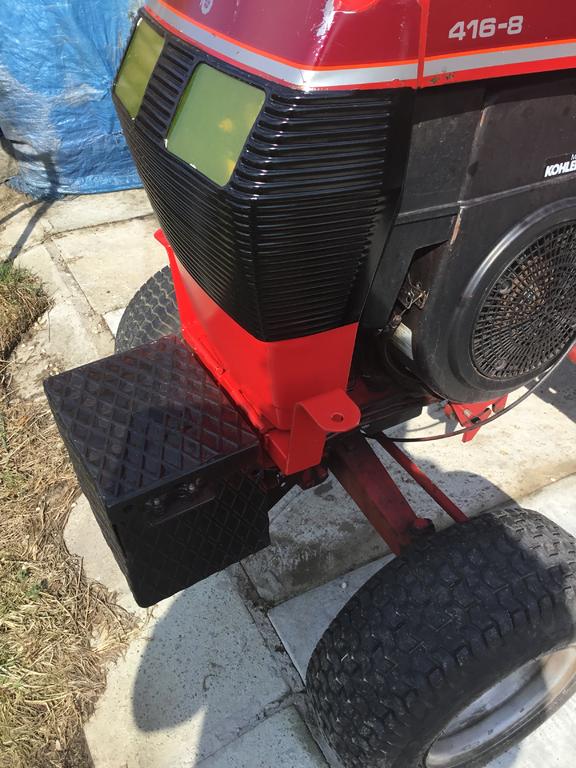

It will take some time   It is not really a project more a work tool  where i gently add some mods  hehe    Now i am searching for some other pulleys  but i want it all as original as possible,  other pulleys to go a bit faster but the original vbelt..  and the original parts i took off can all be remaked.    If you se eon the pic  i have a heavy steel batterycase to add more front wheigt  and the original place of the battery is now a toolbox      On the rear i am planning to make a lift of something but that i dont know yet.  I also dont know how moch weight the axle may handle.

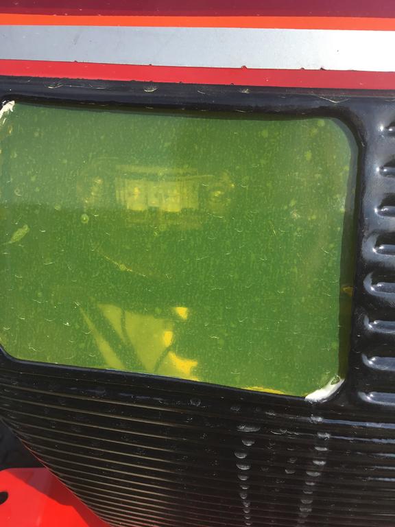

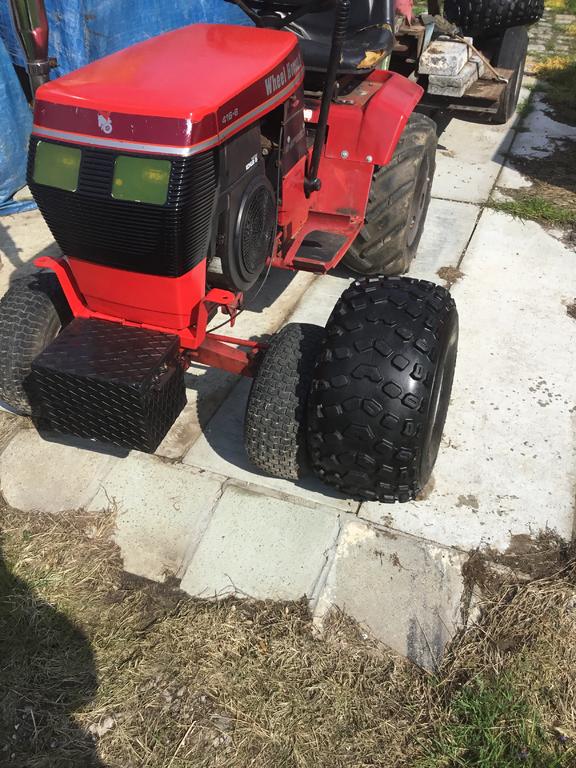

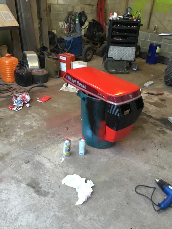

I finaly f8nished the hood   And  changes the lights into 2 leds
i also welded a support for opening the hood and to put 2lights on ..
yesterday i found some atv tires for the front  maybe a little overrated but i must try..  just because
For those who wonder  they are 21*11-8   Large balloon tires so they will float on water and mud ..  i hope

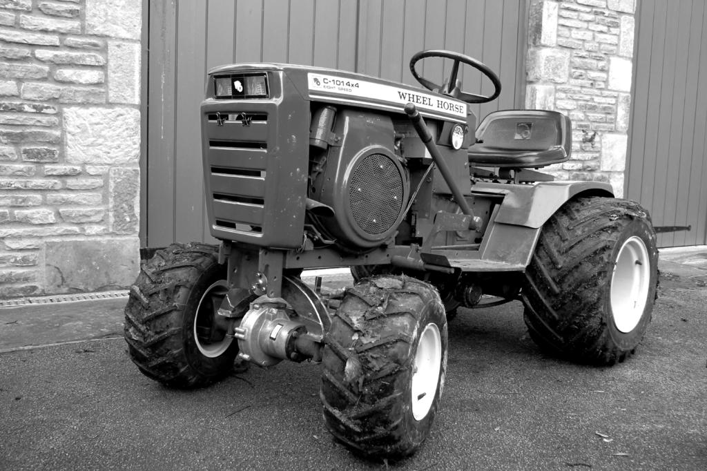

I think the original engine pulley is around 4" and the transmission pulley 6".
To keep the belt the same length you will need to either put 4" on the rear and 6" on the front - or swap both to 5". Either way increasing the front pulley will mean the belt guard fouls on the engine pulley
My 4WD C-101 has a 4" pulley on the rear and original belt - however I dropped the transmission 40mm in order to fit the bigger tyres.

That 4*4 is really nice done ! Ive seen him on youtube also and it inspired me  🤭
how does it drive with the rear 4" pulley?  Swap the both will be a bit overkill  i think but i can do something with the rear axles as well..    wich tiresizes do you have?

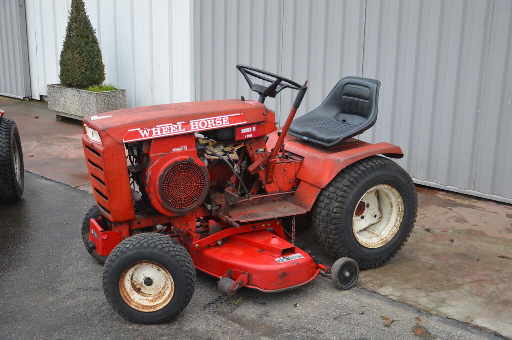

Hello, I am new here, also from Belgium: bought two in one week, knowing i was searching WH for years, just nothing pop-up online.  Everybody i know thinks i bought junk. They rather want a new chinese made mower. My Raider 10 is made in Oevel Belgium, it have to keep it running.
