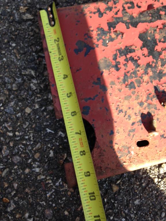

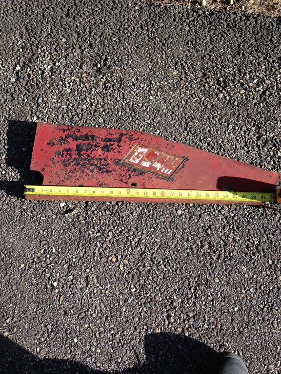

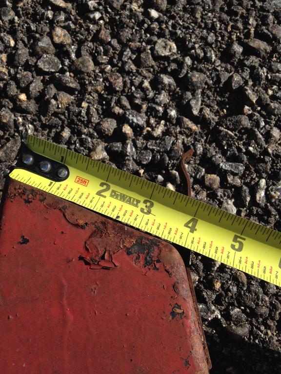

wallfish 20,035 #2 Posted April 4, 2019 I have a 654 and will get you pics and measurements of the belt guard later today if no else posts it before that 1 Share this post Link to post Share on other sites

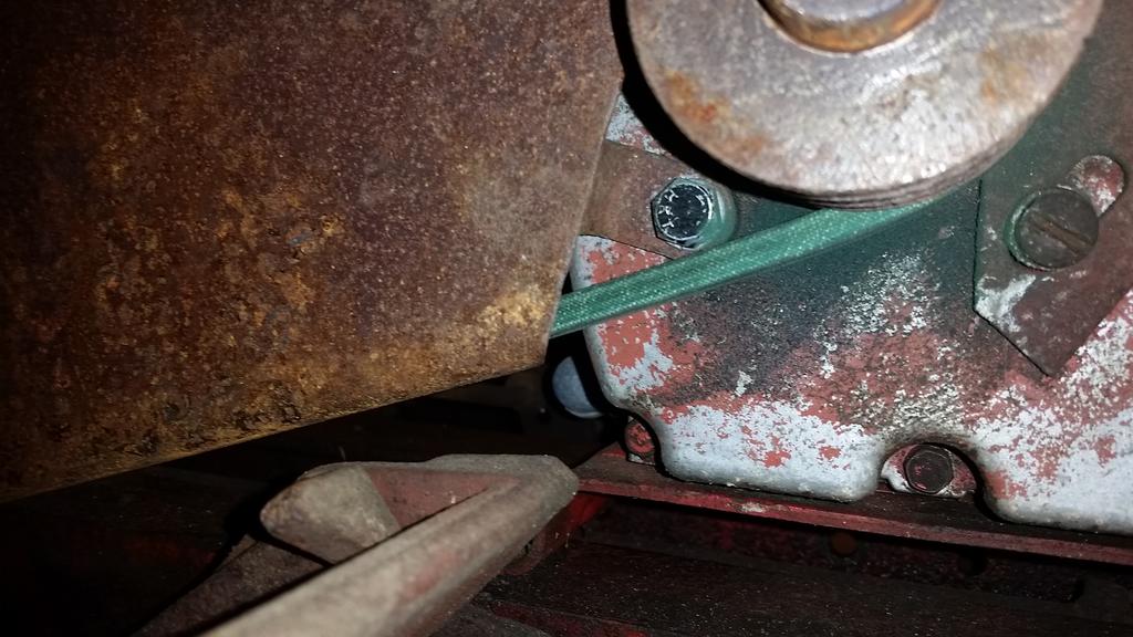

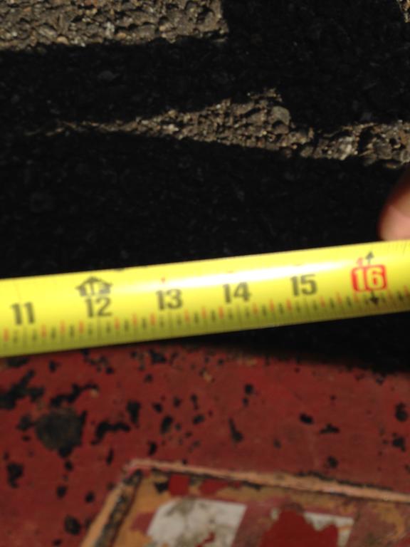

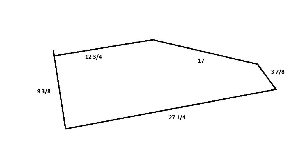

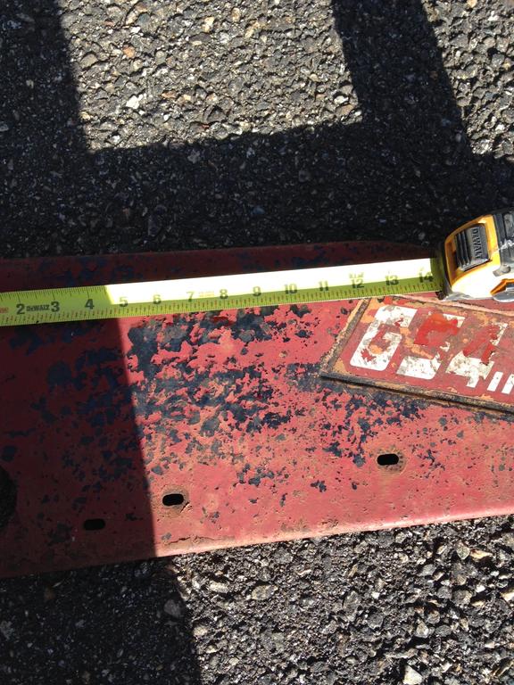

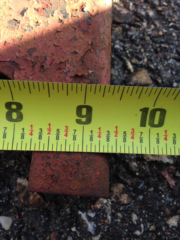

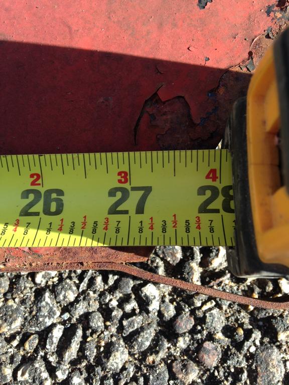

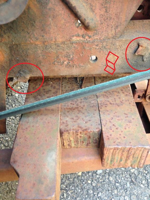

wallfish 20,035 #9 Posted April 4, 2019 The Kohler and Tecumseh belt guards are basically the same thing except the location of the mounting tab at the engine are in slightly different locations, because of the bolt pattern difference around the crank shaft of each type of engine. I have an 8hp Kohler mounted in my 654. Here's some pics The factory mounting tabs are commonly broken. They're just steel bent to a Z shape with a threaded 14-20 hole and welded to the frame 2 Share this post Link to post Share on other sites

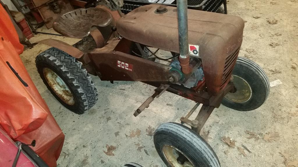

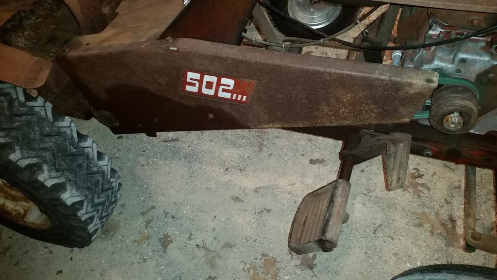

WHX?? 56,847 #14 Posted April 22, 2019 Here's a 604 and was missing the guard when it joined my herd. Found this one at he BS. Fit perfect and as luck would have it a matching patina. Didn't have the heart to change the 502 decal. 1 Share this post Link to post Share on other sites
