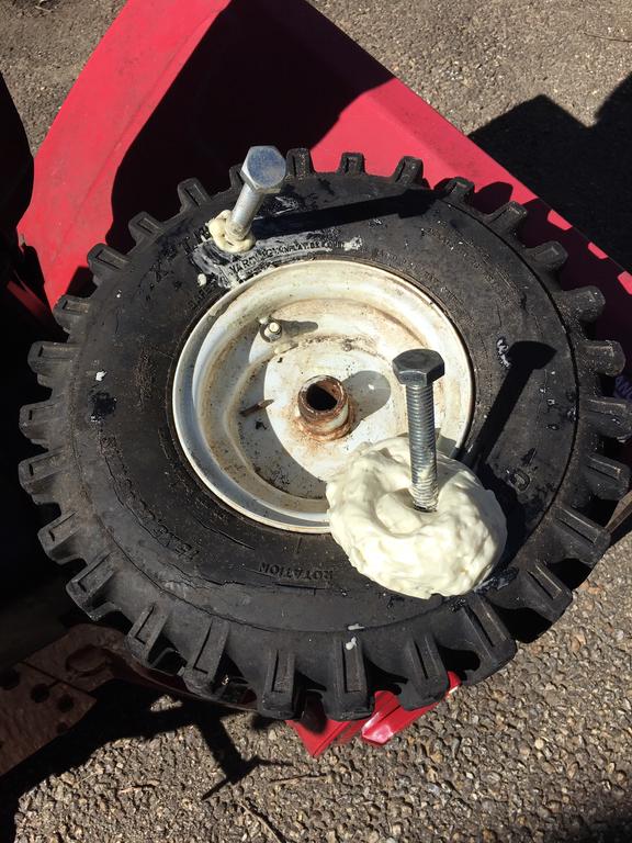

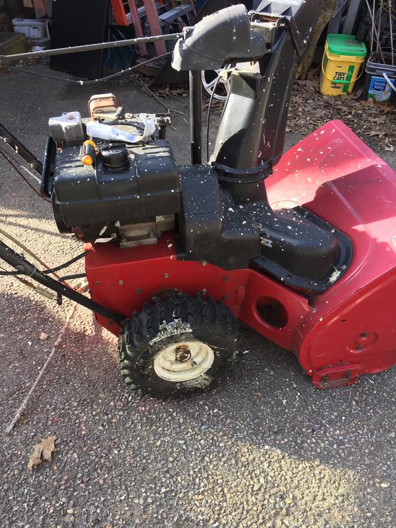

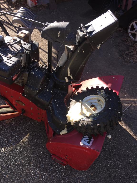

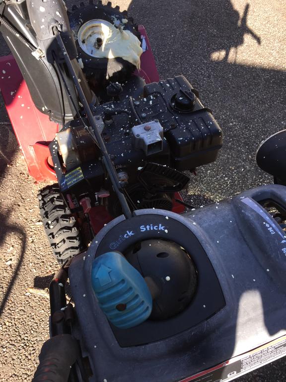

wallfish 20,576 #1 Posted March 27, 2019 (edited) So I ordered new rims and tires for the push blower since one was leaking air and both are cracked heavy. In the mean time I remembered seeing tires filled with foam so thought, "Ah what the heck, let's give it a try". Got noth'n to loose since it's going to be replaced anyway! Drilled 2 1/2 inch holes, filled with a can of foam and plugged the holes. Everything went well until I got impatient again. Pulled the first bolt out of the hole and it was good. Pulled the second and all hell broke loose. That crap flew everywhere! Kind of funny even at the time but luckily the tire was tilted away from my face by having it sit on top of the blower. If you have ever had this stuff get on you, you know how hard it is to clean off. Even carb cleaner is completely useless against this stuff. Anyway, here's the aftermath. Pics don't really show it either as I'll probably be finding foam spots all over for a year. Edited March 27, 2019 by wallfish 17 2 1 Share this post Link to post Share on other sites

wallfish 20,576 #9 Posted March 27, 2019 (edited) Wish I did have a video! I only got 2 little spots on my mustache and 3 or four on top of my hat but all over my hands. SOOOOOOOOOOO lucky it didn't get all over me. Now that would've been epic funny! BTW, the tire actually seems like it's going to work very well. So anyone giving this a try, WAIT 'til it's dry!!!!!!!!!!!!!!!!!!!!! Oh, and seal the holes with silicone or something so water doesn't get in there. Edited March 27, 2019 by wallfish 2 1 Share this post Link to post Share on other sites

wh500special 2,461 #23 Posted March 28, 2019 16 minutes ago, formariz said: Curious if the foam would have dried totally inside tire without being exposed to air. It probably would since they don’t really “dry”, they cure. These foams are are cured by reacting with the water in the air and in the substrate. CO2 is evolved in the process too and makes the bubbles that make it foam. I really heavy or dry cavities the cure can be enhanced by spritzing with a little water before the foam sets. The moisture cure cure is also why they stick so tenaciously to your skin...lots of water available. Glad it didn’t get in your eyes, John. Would have been a different kind of story. Steve 2 Share this post Link to post Share on other sites
wallfish 20,576 #24 Posted March 28, 2019 3 minutes ago, wh500special said: It probably would since they don’t really “dry”, they cure. These foams are are cured by reacting with the water in the air and in the substrate. CO2 is evolved in the process too and makes the bubbles that make it foam. I really heavy or dry cavities the cure can be enhanced by spritzing with a little water before the foam sets. The moisture cure cure is also why they stick so tenaciously to your skin...lots of water available. Glad it didn’t get in your eyes, John. Would have been a different kind of story. Steve So what if the tire was filled part way with water and used the foam to push it out? Would that work better or cure the foam too quick? Or just a little water? I had glasses on so if it went in my face you guys would've just been laughing harder at a pic of that too. 1 Share this post Link to post Share on other sites
wh500special 2,461 #25 Posted March 28, 2019 It would probably displace the water and be fine. I suspect if you cared about the cured density of the foam that adding water may alter it some by changing the size of the bubbles, but for normal use it wouldn’t matter. Might affect whether it ends up closed or open cell too. Probably would get hot. Another common water-cured everyday item is superglue. Mix enough of that stuff with water and it gets really hot. Steve Share this post Link to post Share on other sites
