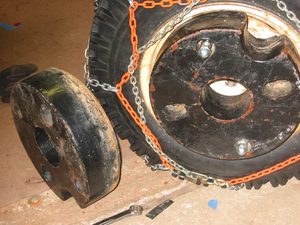

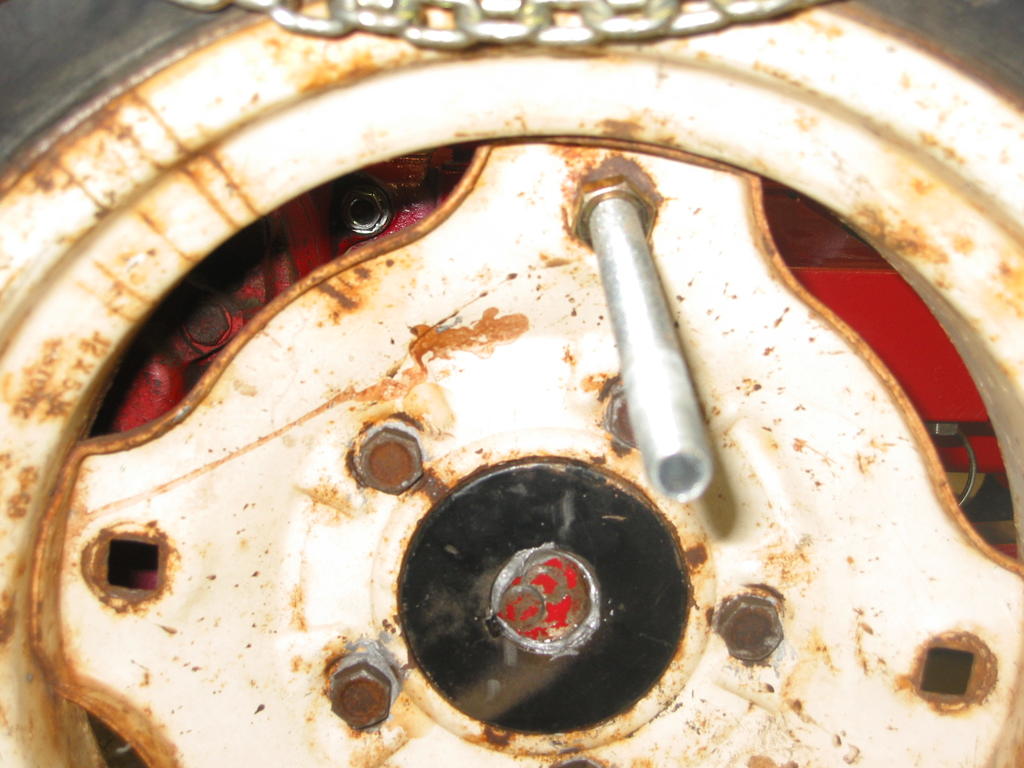

pfrederi 20,275 #1 Posted March 25, 2019 One of my least favorite pastimes is wrestling wheel weighs on and off. The carriage bolts flop around or get pushed out the back of the wheel. Never being very smart my solution was to get more wheel horses so weights would stay on a tractor forever. That idea has worked well until today. Had to pull the wheels and weights off my snow plow Charger. The steel weights weigh 66.5 lbs each and are a bear to wrestle. Put the carriage bolt through the hole and then ran a jam nut on it all the way back to the wheel. It dosen't hold it completely rigid as it hits the carriage bolt shoulder but it holds it almost straight out . Was able to slid the weight on the bolt with no drama and the nut is thin enough it doesn't contact the weight. 5 5 Share this post Link to post Share on other sites
Achto 31,603 #2 Posted March 25, 2019 Excellent idea!! We do that with our farm tractors that we use for pulling so that we can change wheel weights quickly. Never thought of doing it on a GT. 1 Share this post Link to post Share on other sites
squonk 46,133 #3 Posted March 25, 2019 I had the same issue when I installed the 100 lb Farmall weights on my Power King. What I did was get some threaded rod and made longer studs out of them. Tightened them down like you did. Then set the weight on a floor jack and raised the weight on the rods. Snugged 1 nut on the weight to hold it. Removed I rod and installed the proper carriage bolt. I removed the nut reaching inside weight hole. Tighten carriage bolt and repeated for the other one. Had the rods at 3 & 9 o'clock. Hardest part of the whole job was loading the weights in the truck. I used a chain fall to unload and set them on the jack saddle. 1 Share this post Link to post Share on other sites
