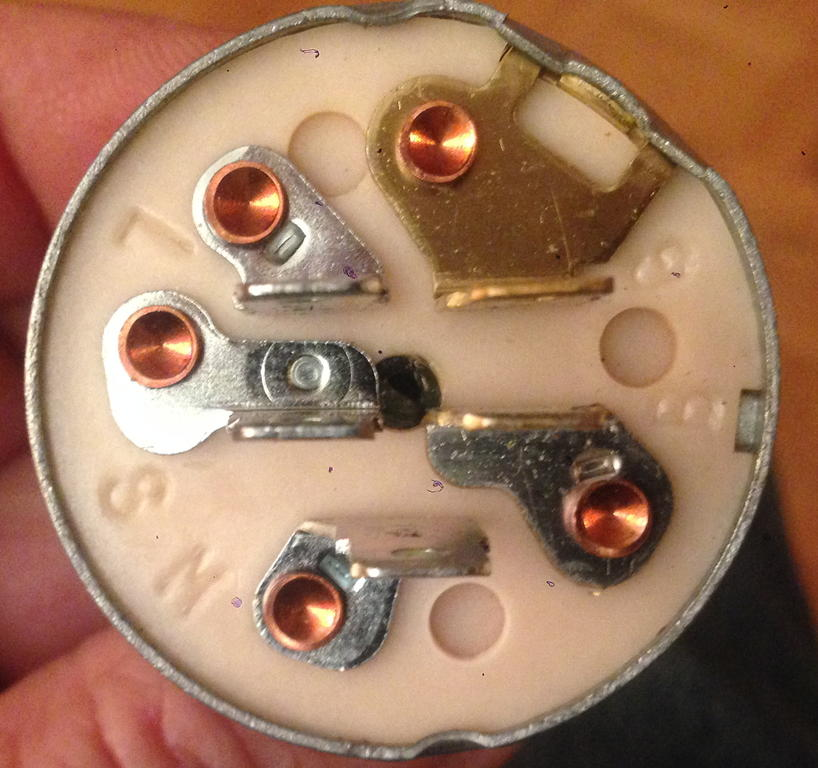

formariz 12,354 #3 Posted March 24, 2019 (edited) @gwest_ca@Lane Ranger Is this it? Edited March 24, 2019 by formariz 1 Share this post Link to post Share on other sites
gwest_ca-(File Mod) 11,990 #4 Posted March 24, 2019 1 hour ago, formariz said: @gwest_ca@Lane Ranger Is this it? Terminal locations are different. Are you trying to identify that switch? Garry Share this post Link to post Share on other sites
formariz 12,354 #5 Posted March 24, 2019 Got here by mistake. Does it fit any particular wheel horse? Seems to be for a magneto ignition with electric starter. Could actually be used on a 551 since pewr and magneto sections are independent of each other. Share this post Link to post Share on other sites
gwest_ca-(File Mod) 11,990 #6 Posted March 24, 2019 Looks like this one. Click on the picture. Some of the applications for the 23-0660 but the earlier 63-5630 are not included https://www.partstree.com/parts/toro/parts/23-0660/ Garry Share this post Link to post Share on other sites
formariz 12,354 #7 Posted March 24, 2019 Thanks Garry. That is it. Share this post Link to post Share on other sites
