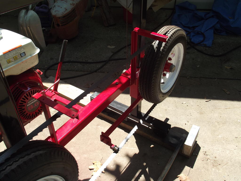

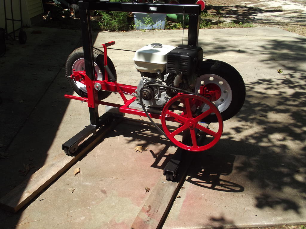

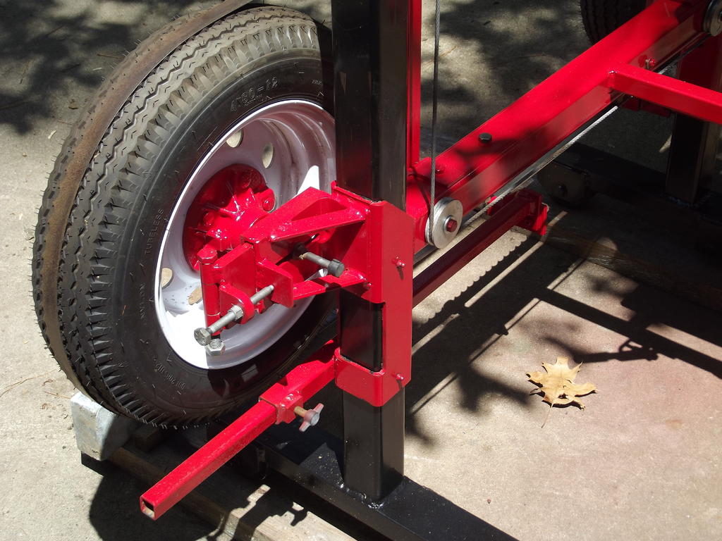

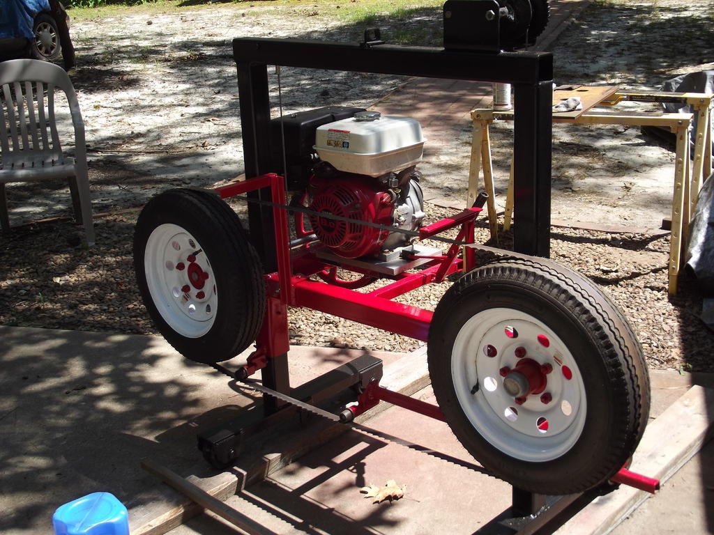

JAinVA 4,638 #26 Posted March 24, 2019 (edited) 11 hours ago, formariz said: @JAinVA That mill is awesome and looks easy to use. How wide is the blade? Are those regular tires? How do you adjust the tracking on blade? Wheel The mill uses a 1" band at 1.3 teeth per inch.Those are standard 15" trailer tires and rims.I have added some pictures of the mill during it's recent refresh.The tension and tracking are done at the idler.The engine is on a sliding plate that is moved by the right hand to increase belt tension.With all new materials this mill cost around $500 to build less engine.The engine is an 8 horse Honda.I get bands made to order by Country Saw and Knife and resharpen them with a Dremel tool.I can usually get 5 regrinds per band.The cost is about $11.00 per blade new. Edited March 24, 2019 by JAinVA 1 2 Share this post Link to post Share on other sites
