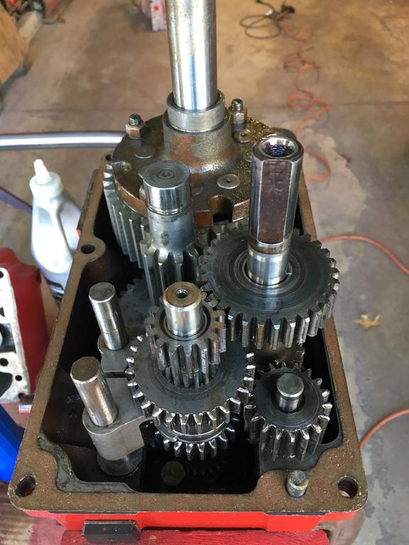

classiccat 548 #15 Posted March 17, 2019 32 minutes ago, squonk said: Brake brake drums are usually held on w / snap ring 8 minutes ago, ebinmaine said: The Woodruff key that is between the output shaft and the brake drum itself. My 5091 doesn’t use a key or split ring. The shaft has opposing flats in it and the drum fits over that and held in place with a bolt/washer. 2 Share this post Link to post Share on other sites

troutbum70 858 #17 Posted March 17, 2019 Classiccat mine is exactly the same setup, I was thinking the shaft had opposing flats and maybe tapered as well. I can see by your picture there is no tapper, so I will continue to work with it till it gives in. Thank you for the picture. 1 Share this post Link to post Share on other sites
doc724 925 #18 Posted March 17, 2019 The brake drum is not tapered. There is a D shape on the drum and a flat on one side of the shaft. Go buy a can of Kroil. Best thing out there for removing stuck parts. Spray the interface between the drum and the shaft every day for a week, then try your puller. Share this post Link to post Share on other sites
troutbum70 858 #19 Posted March 17, 2019 Classiccat provided a very good picture of the transmission split showing the flat side on the shaft. Pullstart recommended heating and melting wax to lubricate it. I guess I need to pickup some kroil I keep hearing good reports on it. 2 Share this post Link to post Share on other sites
