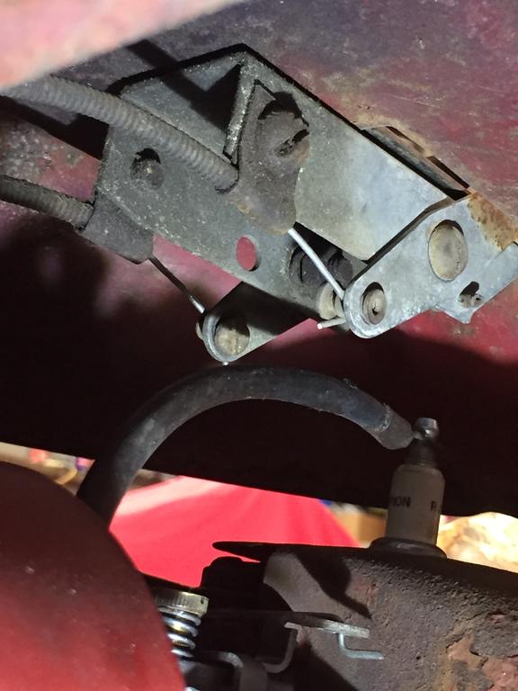

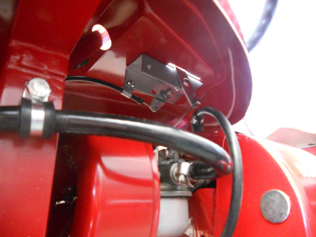

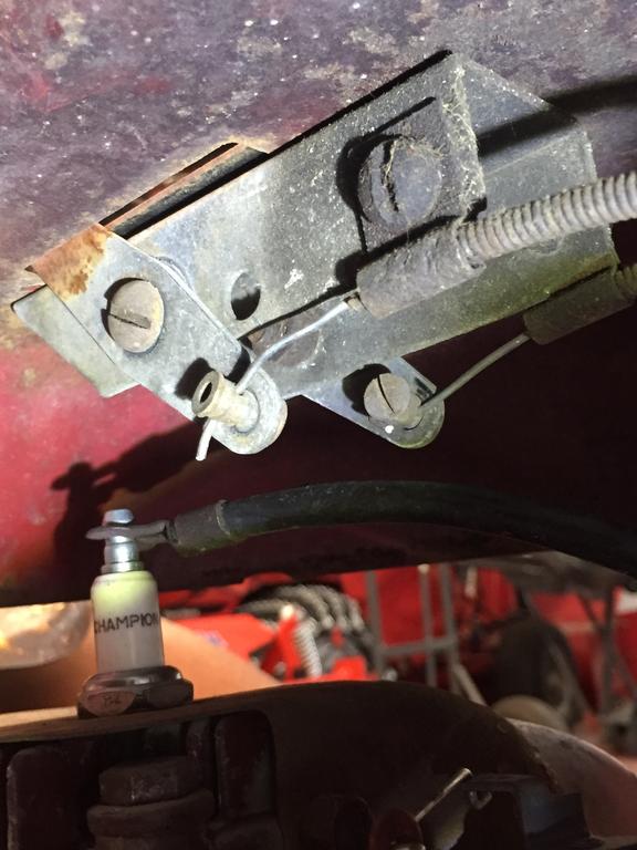

WHX?? 54,636 #2 Posted March 15, 2019 I had that same question a few years ago Denny @Racinbob can maybe chime in here. I had originally thought that the throttle cable was long enough to hit the spark plug for a kill. My 400 with a Clinton I went a different route. Clinton or Kohler Denny? Share this post Link to post Share on other sites

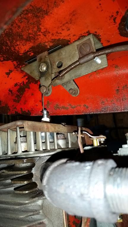

WHX?? 54,636 #3 Posted March 15, 2019 (edited) Here we go Denny...I had originally thought the same but could be dead nuts wrong. Bob will know fer sure I thought the tail hung down to short. but not so sure .. this is what I ended up with but again a Clinton. This is eventually what I ended up with but again a Clinton. Edited March 15, 2019 by WHX22 2 1 Share this post Link to post Share on other sites
dclarke 4,116 #4 Posted March 15, 2019 20 minutes ago, WHX22 said: I had that same question a few years ago Denny @Racinbob can maybe chime in here. I had originally thought that the throttle cable was long enough to hit the spark plug for a kill. My 400 with a Clinton I went a different route. Clinton or Kohler Denny? Mine’s a Kohler, Jim. I’m not sure it’s original tho and there’s a wire hanging from the points. I just thought it might connect to the throttle bracket somehow to kill the engine but I don’t know much at all about these Suburbans. Thanks for the pics, I never thought about a wire touching the spark plug. 1 Share this post Link to post Share on other sites

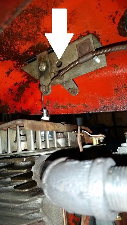

wallfish 19,096 #5 Posted March 15, 2019 (edited) A plastic insulator goes in that hole to isolate the screw which the kill wire connects to and then the lever makes contact with the screw head to ground it. I'll see if I can find a pic with the insulator and screw. Edited March 15, 2019 by wallfish 3 Share this post Link to post Share on other sites
WHX?? 54,636 #6 Posted March 15, 2019 It looks deceiving Denny... Is that right 'Fish ... I often wondered about that but had nothing to go off of. Share this post Link to post Share on other sites
wallfish 19,096 #7 Posted March 15, 2019 2 minutes ago, WHX22 said: It looks deceiving Denny... Is that right 'Fish ... I often wondered about that but had nothing to go off of. Would I steer you wrong? Yes, that's how it goes but the problem was the ground connection. By the time it goes through the lever bolt, the assembly mounting screws on the hood, the hood mounts ect. ect. They eventually fail so people just disconnected them. Fine idea when the tractor is new but after some weathering and vibration over a few years, well.... 1 Share this post Link to post Share on other sites
dclarke 4,116 #8 Posted March 15, 2019 16 minutes ago, wallfish said: A plastic insulator goes in that hole to isolate the screw which the kill wire connects to and then the lever makes contact with the screw head to ground it. I'll see if I can find a pic with the insulator and screw. Thanks, John. I can understand it having trouble grounding. Maybe I should just leave well enough alone and continue using the button on the points cover. 1 Share this post Link to post Share on other sites

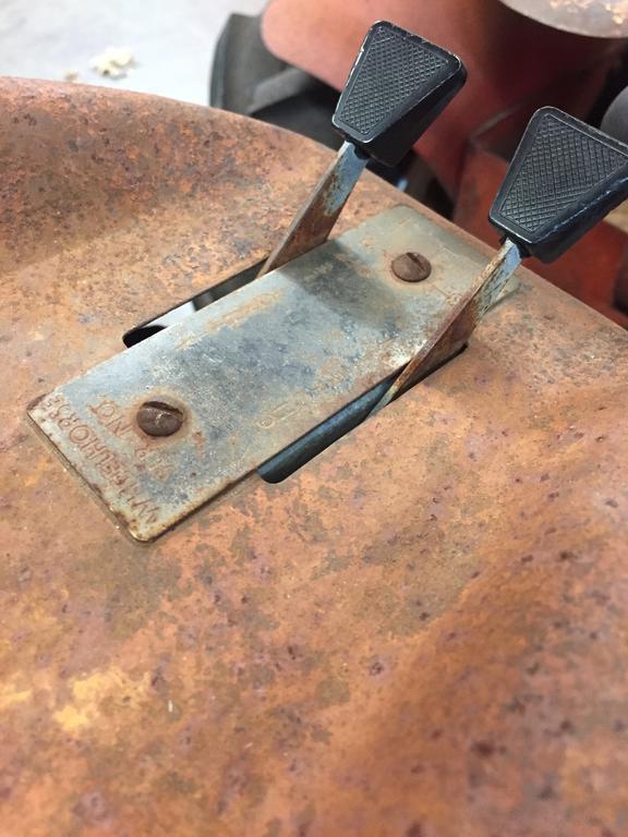

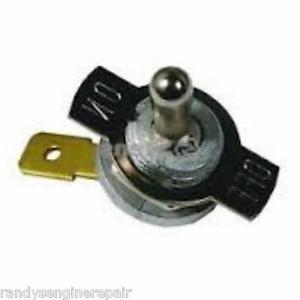

AMC RULES 37,254 #24 Posted March 15, 2019 You'll find them original single pole switches are a challenge to find though. Share this post Link to post Share on other sites
wallfish 19,096 #25 Posted March 15, 2019 1 hour ago, AMC RULES said: You'll find them original single pole switches are a challenge to find though. The one I thought was original on my RJ looks like this Share this post Link to post Share on other sites
