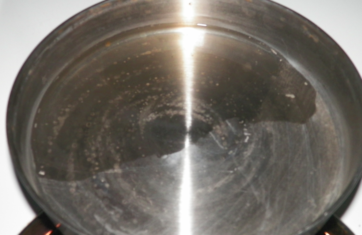

bc.gold 3,406 #106 Posted May 21, 2021 (edited) With the $105.00 penny find I purchased a one inch portable gas water pump, river water with dissolved gold will get passed through this filter packed with activated carbon. A buddy from Vancouver island sent me two liters of river water from Sooke not to far from Leachtown a well known gold producing area who's watercourse feeds into the Sooke River/ but after evaporating one liter down his water does not look near as promising as the location I discovered further north. I made a mistake using a metal pan to evaporate the water, any gold that may have been there has certainly reacted with the metal which caused it to be cemented out. The pan had a nice shiny bottom when it first started out now it's showing some black. Fortunately I have saved a sample for assay which will be mailed out tomorrow to a lab is Saskatchewan. Leechtown is a ghost town on the Southern end of Vancouver Island in British Columbia, Canada. On 18 July 1864 the Leech River was named and 'payable' gold was discovered by members of the Vancouver Island Exploring Expedition (VIEE), which led to a gold rush and the establishment of Leechtown. Edited May 21, 2021 by bc.gold Share this post Link to post Share on other sites
bc.gold 3,406 #107 Posted May 21, 2021 (edited) The residue line looks metallic. Edited May 21, 2021 by bc.gold Share this post Link to post Share on other sites
bc.gold 3,406 #108 Posted May 21, 2021 (edited) Going camping bring your own water you never know what is that fresh looking stream or brook water. Elements below iron will react with cookware containing iron and discolor your cookware with its precipitate. Aluminum cookware will react with elements below itself to precipitate those out of solution, fortunately aluminum being very reactive forms a passive layer but acidic foods easily break through this layer. When the results of the water assay have been returned we'll know all the elements in our river water and wither its safe for domestic use. As a youngster my father once told me to be careful in the woods what I used to wipe my butt with. Edited May 21, 2021 by bc.gold Share this post Link to post Share on other sites

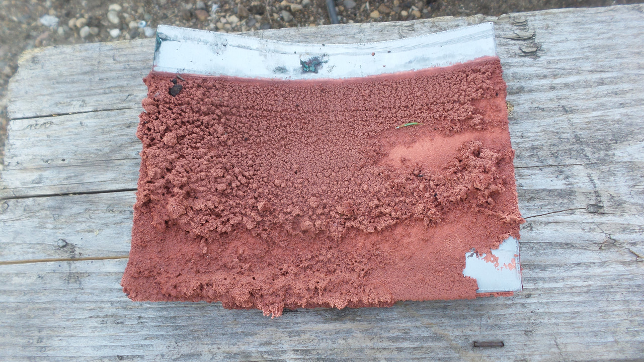

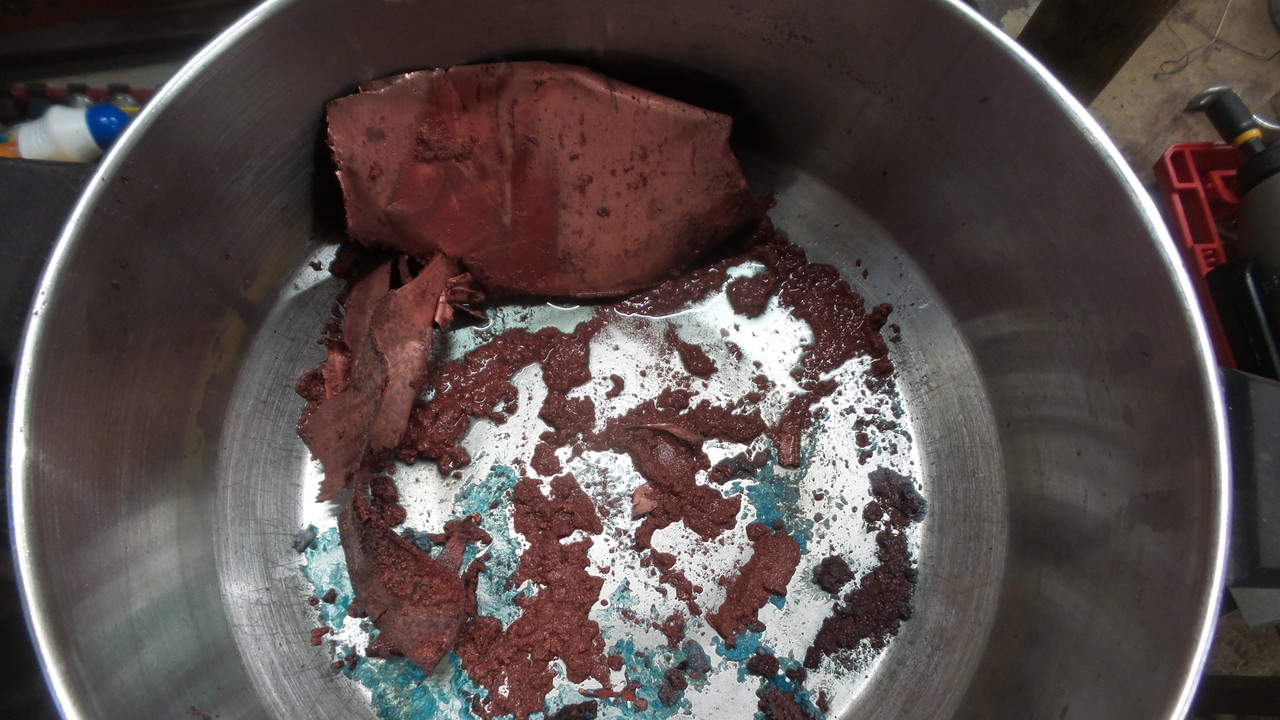

bc.gold 3,406 #114 Posted June 15, 2021 (edited) Day two the copper peeled away nicely from the stainless steel sheet and we have some sludge already forming in the cell this will be the silver I'm after. The blue crystals in the large pan will be taken up with hot water then returned the cell, the blue is home made copper sulfate. Edited June 15, 2021 by bc.gold Share this post Link to post Share on other sites

bc.gold 3,406 #121 Posted September 6, 2021 First copper harvest, one side of the stainless steel cathode had a nice sheet that peeled off while the side facing the anode was fluffy. 1 Share this post Link to post Share on other sites

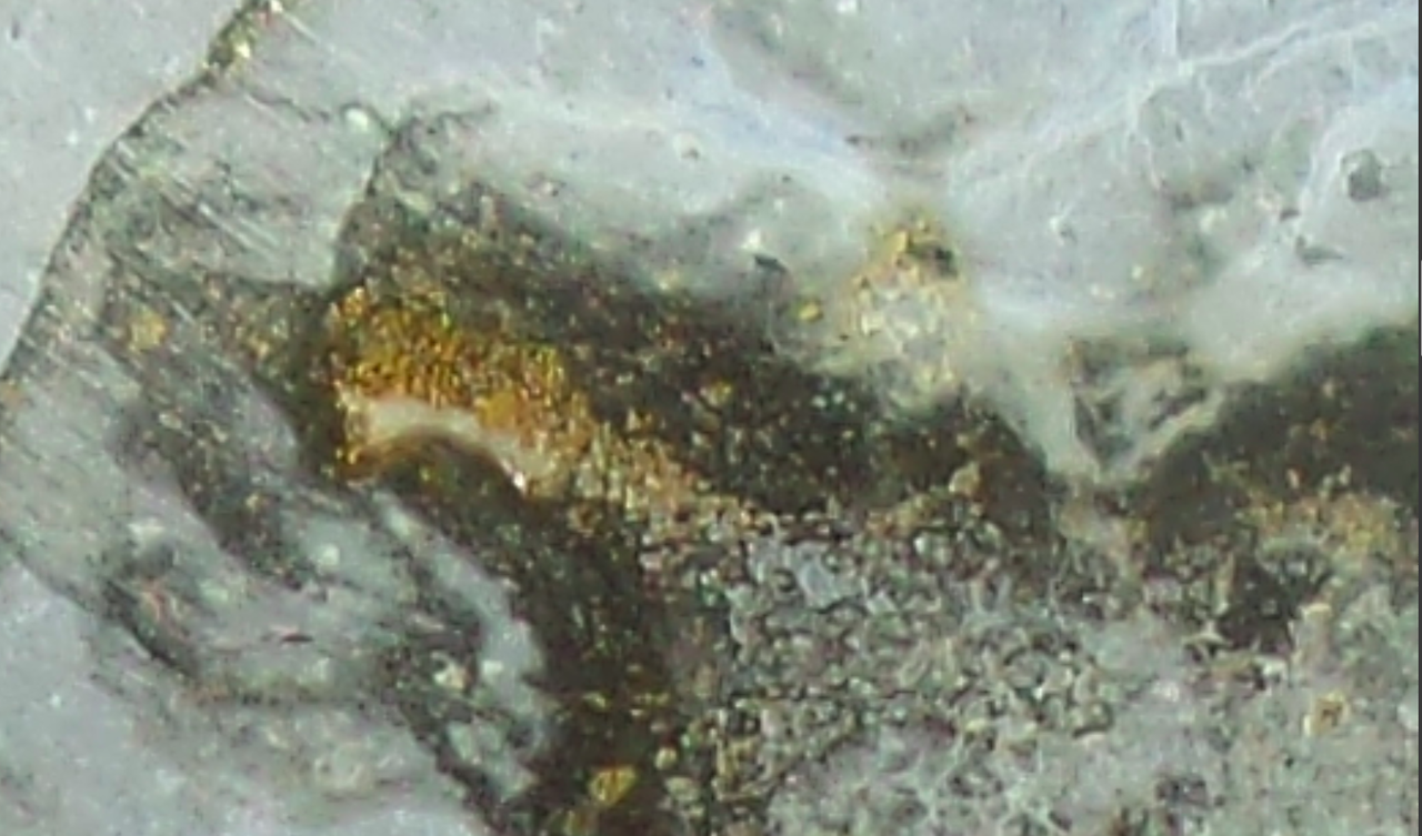

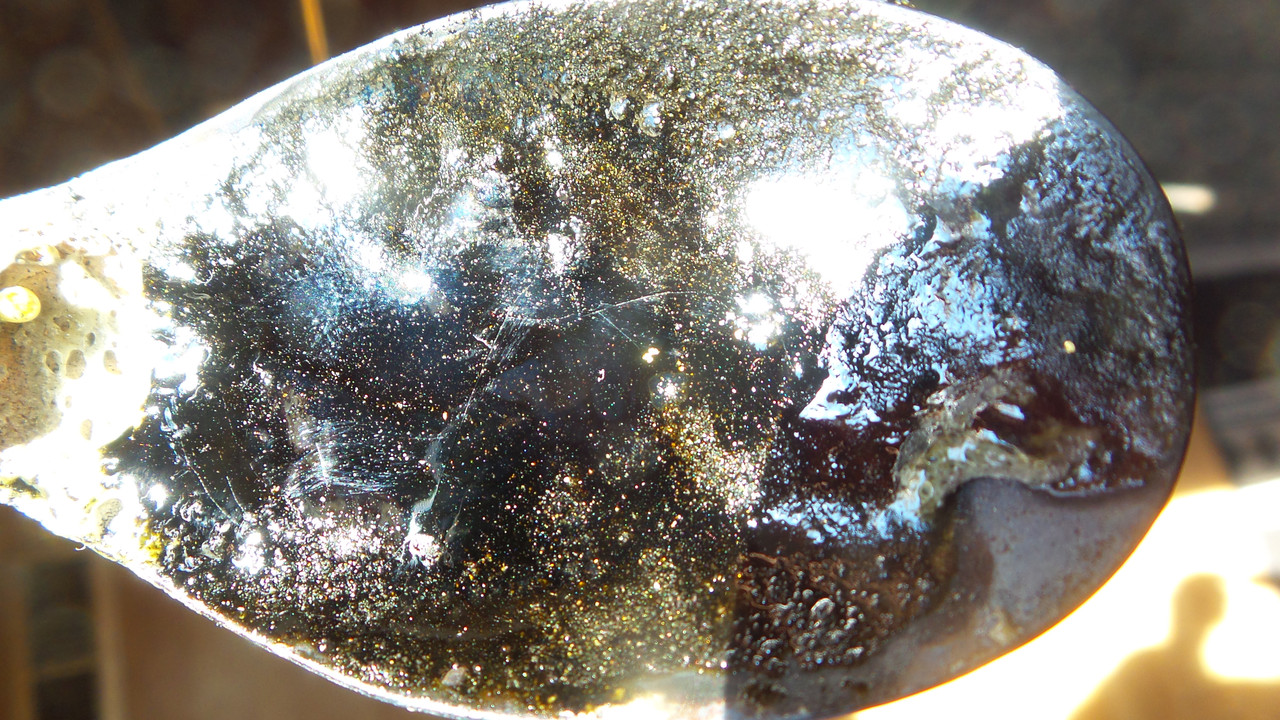

bc.gold 3,406 #125 Posted March 28, 2022 (edited) 7 hours ago, bc.gold said: Looks like I have a promising summer ahead of me. Tablespoon full of black sand mixed with flux, there was no visible gold to begin with. Had I added a collector metal the gold would have been scavenged by the collector. As it is I'm impressed with the results, I have 1kg of this sample to smelt, the other sample I had received from Rod tested barren for au. The flux I'm using is a home made recipe, Borax, Silica with some Fluorspar to make the flux more fluid. Edited March 28, 2022 by bc.gold 1 Share this post Link to post Share on other sites
