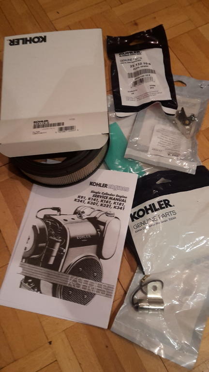

Konrad 6 #1 Posted March 8, 2019 This little box of goodies turned up from my Kohler dealer here in the UK today. So, I'll be undertaking my first service of my C-120s K301 engine this weekend. Its not been running especially well since we brought it, and I'm hoping that a new set of points/condenser, spark plug and air filters will have it running smoothly. I don't have a timing light - will I be able to set the timing sufficiently through the use of feeler gauges and a multi-meter? Any thoughts and guidance welcomed Share this post Link to post Share on other sites
