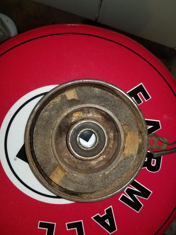

TyH 13 #1 Posted March 6, 2019 I'm trying to figure a way out to separate the wire without destroying anything. I know from talking to the electricians at work that its probably impossible to repair a break if I find it. Rewinding is a possibility if I can find someone. Or finding another field from another. But either way I'd like to keep it original as possible. I've seen YouTube videos but nothing about proper tension and turn count. Share this post Link to post Share on other sites
953 nut 69,557 #2 Posted March 6, 2019 I ran into the same problem a few months back, here is the only reply I got where it had been repaired. Howie Senior Member Supporter 301 334 posts Joined: February 22, 2013 Member No:9616 Military Member: Army Location: Rochester, IN Report post #4 Posted November 2, 2018 I fixed one off an Ariens with that problem, ground the epoxy out around the wire repaired it . Verified it worked. Share this post Link to post Share on other sites
TyH 13 #3 Posted March 6, 2019 That's what I'm after, thankyou Share this post Link to post Share on other sites
