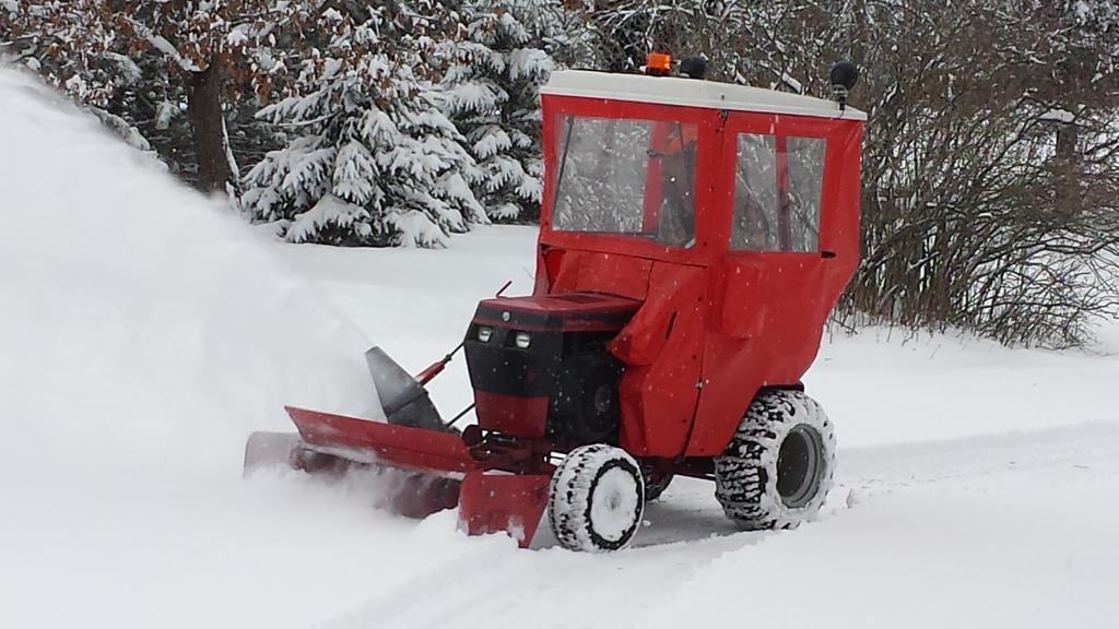

formariz 12,352 #1 Posted March 4, 2019 Finally there was enough snow to use newly acquired 520 with blower and snow cab. A little intimidating at first specially by being enclosed and not having lot of visibility since its a little tight around here. It absolutely awesome. Makes plowing afterwards so much easier since I get rid of most of snow rather than just pile it on the sides. It looks like the big Ariens is going to be retired. IMG_5831.MOV 4 7 Share this post Link to post Share on other sites

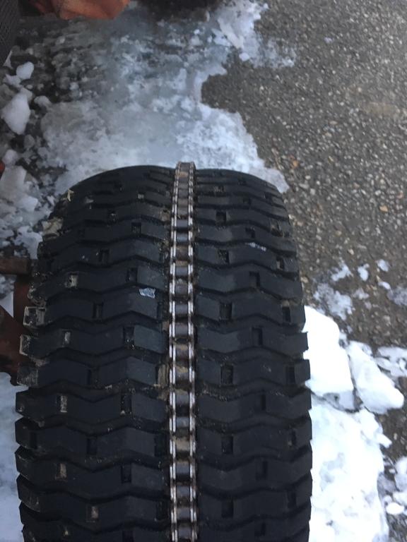

formariz 12,352 #3 Posted March 5, 2019 Yeaph. There is no going back from this one. After using it for a while today, I can see already a few more improvements in the near future. The glass and wiper kit will be next. I am thinking about some good mirrors also. That will make it safer up on the street when backing up or turning. A little frustrated with the roller chains on the front tires. Sooner or later eventually they pop off regardless how much pressure I put in tire. I wonder if a tri rib tire will have the same effect? It will have a narrow contact point, therefor more downward pressure, but it wont have the friction of the roller chain? 1 1 Share this post Link to post Share on other sites
wallfish 18,677 #4 Posted March 5, 2019 Glad you got to go out and test it! Your front chains are too long. take a link or 2 out. They should go on a deflated tire pretty tight . On mine you can see a curve in the tire where the chains are, they don't budge. Took me a little while to get used to the cab because of the restricted vision thing as well but just used to it now. 3 Share this post Link to post Share on other sites
formariz 12,352 #5 Posted March 5, 2019 14 minutes ago, wallfish said: Your front chains are too long. take a link or 2 out. They should go on a deflated tire pretty tight I did that to the point that I have to totally deflate tire to get them on and that is hard to do. Then I filled tires to 30Lbs. Perhaps more pressure? Share this post Link to post Share on other sites
WHX?? 53,081 #6 Posted March 5, 2019 Tri ribs won't help Cas.. I went to V61s thinking that would be the cats's meow but they still just skid on well packed snow or ice. I can't run chains due to driveway damage. Just lift a bit on the blower and things straiten out. My kid had the cab off on his 416 and was whining about the visibilty. I have no idea what you guys are talkin about as I have no problem with vis even when the front gets covered with blow but somtimes could see the usefulness of the hard front and wiper. Just remember when in the cab keep your head on a swivel. Especially with that beast in tight quarters. Good topside lighting is a must after dark. Do you have Matts pedal kit? Another must as it leaves a hand free for othe duties and a wheel spinner is a must. I have been long hooked on blowing with these rigs! Have fun! 9 Share this post Link to post Share on other sites
wallfish 18,677 #7 Posted March 5, 2019 (edited) Don't over pressure the tire. It could blow! Remove the valve core from the valve stem which makes it quicker and easier. You can get a little tool to take them out. https://www.amazon.com/Slime-20088-4-Way-Valve-Cores/dp/B0020T17J2/ref=asc_df_B0020T17J2/?tag=bingshoppinga-20&linkCode=df0&hvadid={creative}&hvpos={adposition}&hvnetw=o&hvrand={random}&hvpone=&hvptwo=&hvqmt=e&hvdev=c&hvdvcmdl={devicemodel}&hvlocint=&hvlocphy=&hvtargid=pla-4583795260686221&psc=1 Edited March 5, 2019 by wallfish Share this post Link to post Share on other sites

wallfish 18,677 #18 Posted March 5, 2019 You can see how tight the chain is by the curve of the tire around the chain. Another style tire beside the Ag is walk behind snowblower tires which seem to do fairly well too. Had them on the FEL tractor when that was a snow removing machine. (Now has tri ribs). But my preference is the roller chain since it works best for my situation. It appears from the video you're not scraping the driveway with the blower scrape bar and have the skids down low, so you can raise the blower just a little bit and steering is vastly improved because of the weight. 2 1 Share this post Link to post Share on other sites
formariz 12,352 #19 Posted March 5, 2019 I kept it up about 1/2" but still have a few issues on the steep part specially if I am not going straight up. I am going to take up your suggestion and remove one more link. Even with the 30Lbs inflation mine did not bulge around chain so my chain has to still be a bit too long. Share this post Link to post Share on other sites
wallfish 18,677 #20 Posted March 5, 2019 Well, you know how hard they are to move on the tire now, so imagine the force required to push them off the tire. Can't clearly remember but think I ground a chisel to dull the end and used that to pry them on. Once past the edge they moved to the center easier. Share this post Link to post Share on other sites
1995 520H+96+97 937 #21 Posted March 5, 2019 @formariz I deflated tire, wrap chain on tire, put a wire tie through each ends, pull on wire tie, install master link, 25 # air. 1 Share this post Link to post Share on other sites
