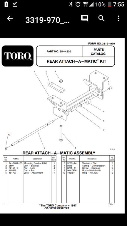

gwest_ca-(File Mod) 12,455 #2 Posted March 4, 2019 The parts illustration may help Garry Share this post Link to post Share on other sites

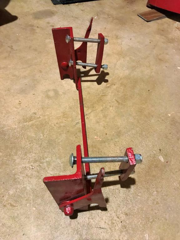

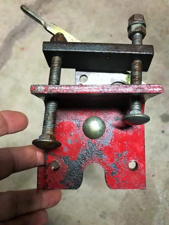

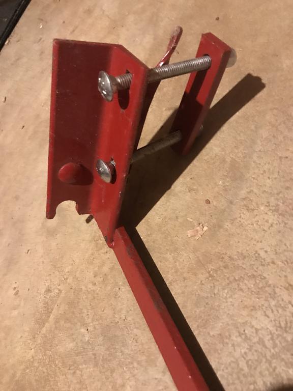

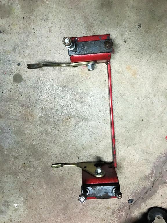

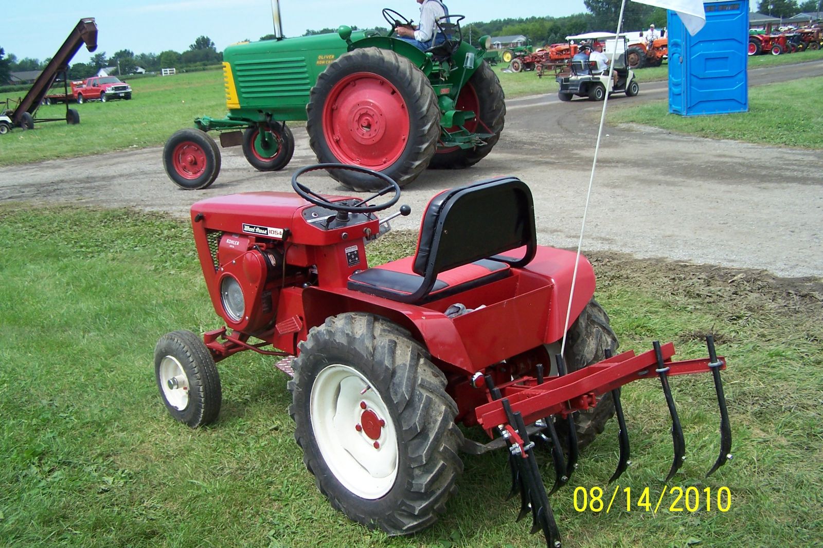

Lane Ranger 12,092 #5 Posted March 5, 2019 Jim: Here are two versions of the rear axle bracket used for snowplows, mid-grader blades and tiller attachments. The first two photos are the type I think you are asking about. We used that type on a 953/1054 tractor for the 54 inch snowplow. My dad made three drawbar hitches that attached to the front angle iron from the rear side to pull much like on a Farmall drawbar hitch. Several holes for a ball, clevis, chain or pin to pull a wagon were on it. The hydraulic lift rear slot hitch would also clear the hitch for continued use. You can see drawbar with the cultivator on the rear in the slot hitch on this 1054 picture. You could easily make to other angle iron brackets for the outside/backside of the hitch to hook up a tiller etc. 2 Share this post Link to post Share on other sites
