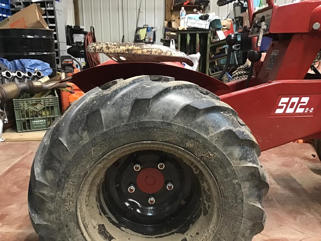

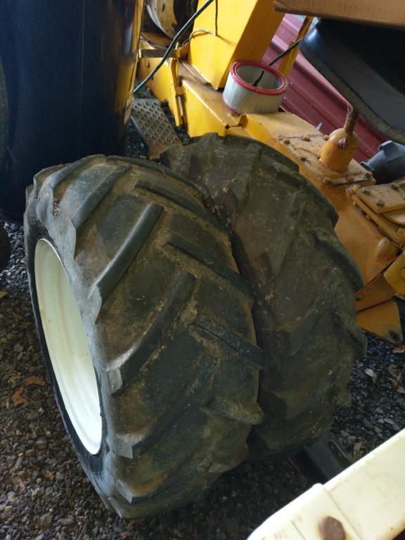

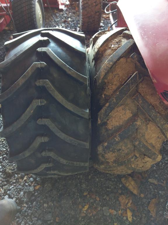

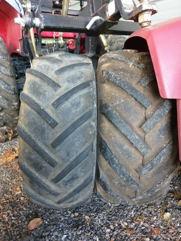

WVHillbilly520H 10,378 #2 Posted March 1, 2019 @The Tool Crib, I like my OTR Lawn Trac R1s, on my 520s with 8.5" wheels, excellent traction wet dry cold or warm...i had Nanco AGs as well on the same wheels they run small like the Deestones traction not as good in winter snow vs the OTRs...1st pic 23x8.50 Duro and 23x10.50 Nanco...2cd OTRs...23x10.50 OTRs and 23x10.50 Nanco...hope this puts at least these 3 brands in perspective. 3 Share this post Link to post Share on other sites

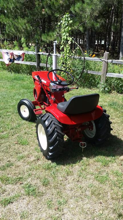

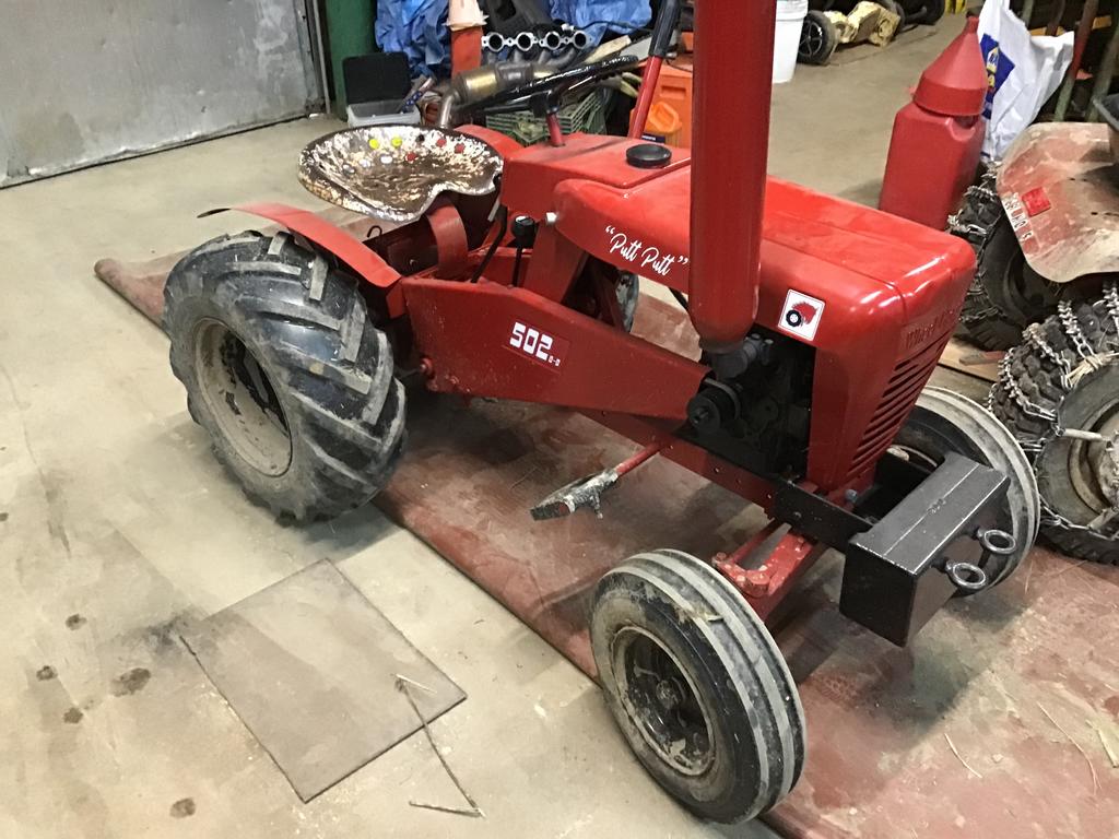

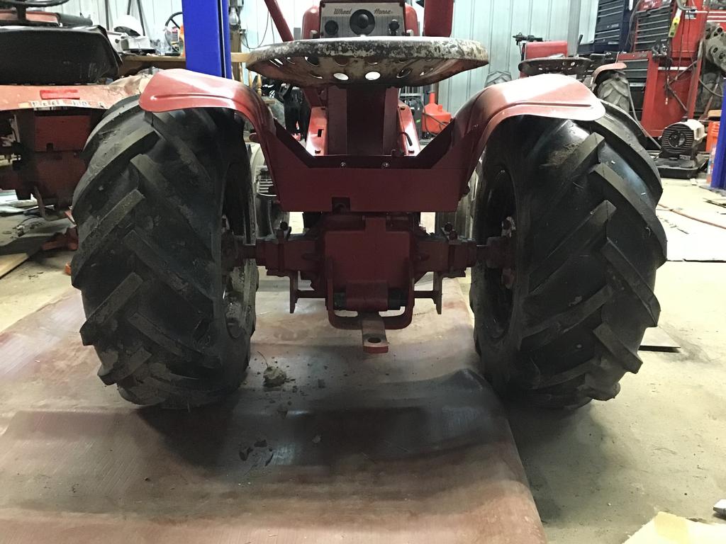

Pullstart 69,601 #4 Posted March 1, 2019 Deestone 10.5’s are more like 8.5’s in reality. These 23-10.5’s are on 6 or 6.5” wheels, whatever is on a C-101. If they were loaded, they’d surely have better grip in the muddy field and deep snow. Otherwise they work great! My loaded 8.5’s are out on loan and have a ton more grip. I think that’s due to the weight, not as much the size. 5 1 Share this post Link to post Share on other sites

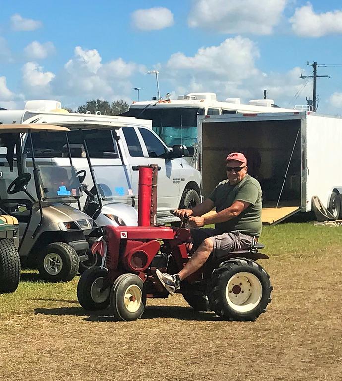

Lane Ranger 11,935 #7 Posted March 1, 2019 Wider ones look good even on the older tractors like the 702! 5 Share this post Link to post Share on other sites

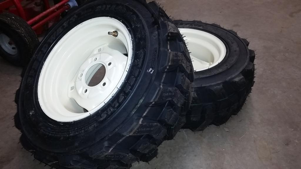

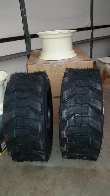

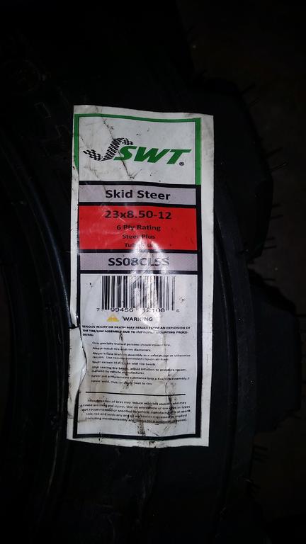

WHX?? 55,993 #9 Posted March 1, 2019 (edited) Tru Powers in 23-10.5 Crib... almost strait sidewall. Generic R-4s in 23-8.5 if you like the industrial look. Very heavy 6 ply. 'bout the same $$ as 10.5 Tru Powers. Edited March 1, 2019 by WHX22 2 1 Share this post Link to post Share on other sites

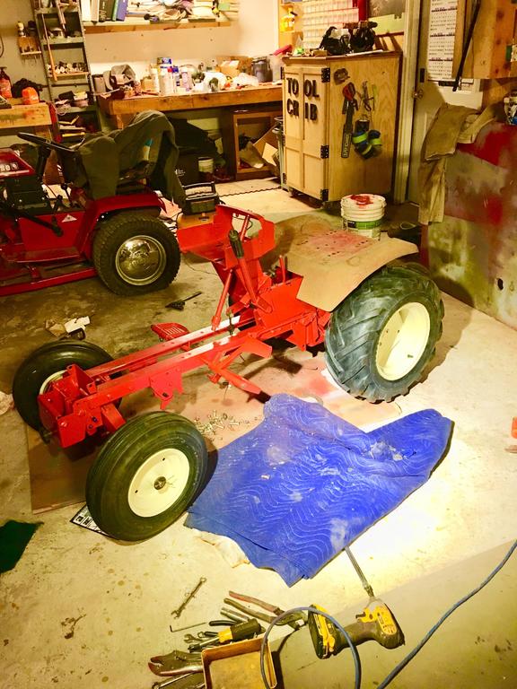

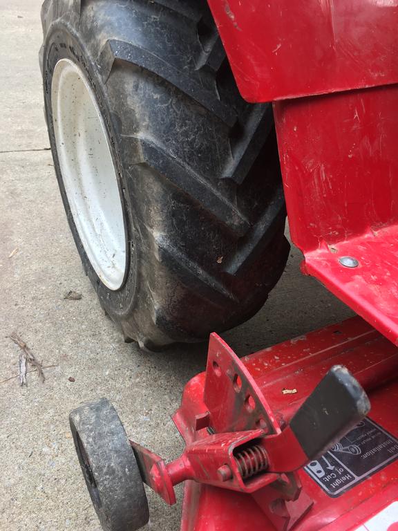

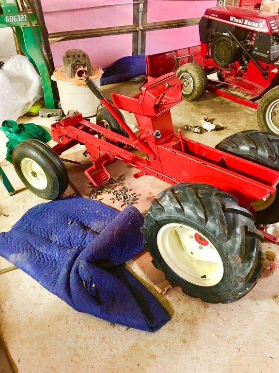

The Tuul Crib 7,353 #13 Posted March 6, 2019 I just got these10.50s yesterday and stretched them on the rims.I must say they fit and look better than I first thought! Fact I may buy another pair for my 414-8. 2 Share this post Link to post Share on other sites
WVHillbilly520H 10,378 #14 Posted March 6, 2019 2 hours ago, The Tool Crib said: I just got these10.50s yesterday and stretched them on the rims.I must say they fit and look better than I first thought! Fact I may buy another pair for my 414-8. Which brand did you finally decide on? Share this post Link to post Share on other sites
WHX?? 55,993 #15 Posted March 6, 2019 Looks to be the dees... 23-8.50?? 10.5s have the bigger bulge on the sidewall. They are a good tire for the money. I wouldn't be afraid to try them out. Share this post Link to post Share on other sites
The Tuul Crib 7,353 #16 Posted March 6, 2019 (edited) 36 minutes ago, WVHillbilly520H said: Which brand did you finally decide on? Deestone . They don’t bulge out too bad . Edited March 6, 2019 by The Tool Crib Share this post Link to post Share on other sites
Pullstart 69,601 #17 Posted March 6, 2019 I’m glad to see the tools scattered, and (we’ll stick with) organized khaos in the background. Oh and your progress looks great today! Share this post Link to post Share on other sites

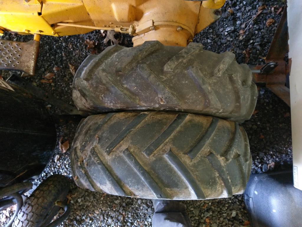

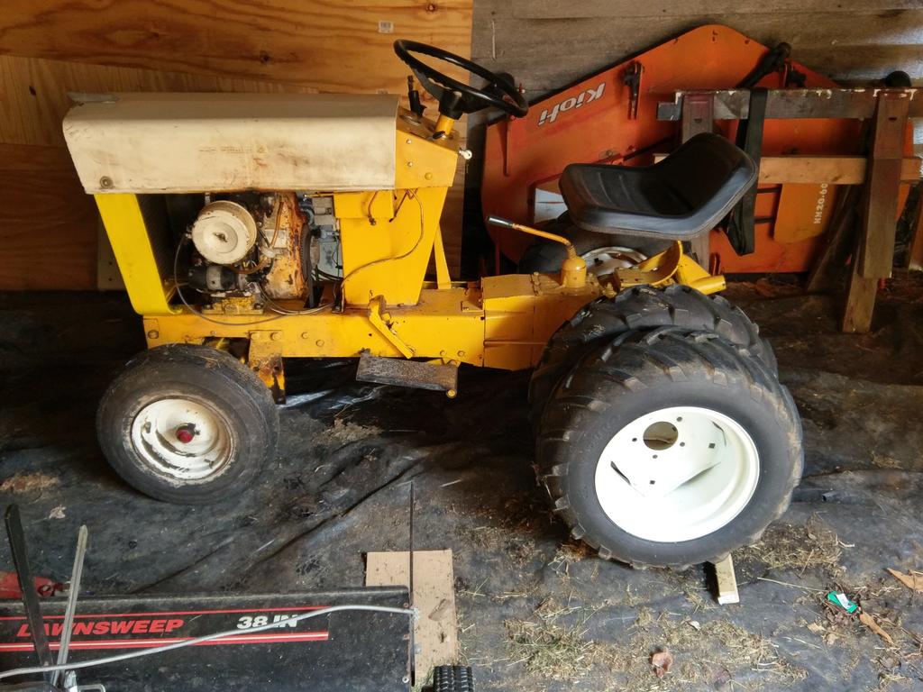

WVHillbilly520H 10,378 #20 Posted March 12, 2019 I think you would be just fine here the 6-12 on my dad's OCC and a pair of 8.50s side by side... Share this post Link to post Share on other sites
The Tuul Crib 7,353 #21 Posted March 12, 2019 I’m just worried about these being too wide for the narrow rims but at the same time thinking that the deestones do run a bit narrower than actual said size. Share this post Link to post Share on other sites
WVHillbilly520H 10,378 #22 Posted March 12, 2019 Just now, The Tool Crib said: I’m just worried about these being too wide for the narrow rims but at the same time thinking that the deestones do run a bit narrower than actual said size. I can't tell you wheel width sizes for certain but I would guess 7" wrapped by the 8.50s and 5" the 6-12s. Share this post Link to post Share on other sites
The Tuul Crib 7,353 #23 Posted March 12, 2019 50 minutes ago, WVHillbilly520H said: I think you would be just fine here the 6-12 on my dad's OCC and a pair of 8.50s side by side... I’m thinking that they would be fine on the narrow rims . I’m also wanting to get 10.50 ags for my 312-8. I like the way they look on my 1067 1 Share this post Link to post Share on other sites
