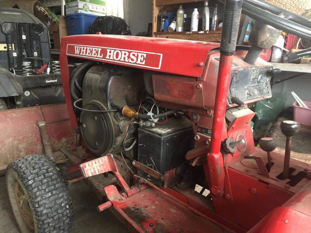

austin joe 11 #16 Posted March 2, 2019 First I would like to thank everyone for the advice and suggestions. After talking to Overnight Solutions and Jacks Small Engine Repair it seems the ignition coil on this "lasts forever". Their suggestion it was in the ignition switch or wiring. So we put a new switch in and replaced any connection plugs and wrapped wires in electrical tape and made sure no wires were touching the engine. This is a working tractor I use to move feed, fence panels and manure with on a ten acre small farm. I went out today and did all of that and drove about 1-1.5 hours and ran perfectly. Previously it would run 15 minutes at most. So long story short success I would not have been able to get this done without this forum. I would not hesitate to use Overnight for a replacement or Jack's for a used one if needed both are very knowledgeable . Below is a picture of the old girl after a workout I taped the wires afterward just for insurance. 1 Share this post Link to post Share on other sites
