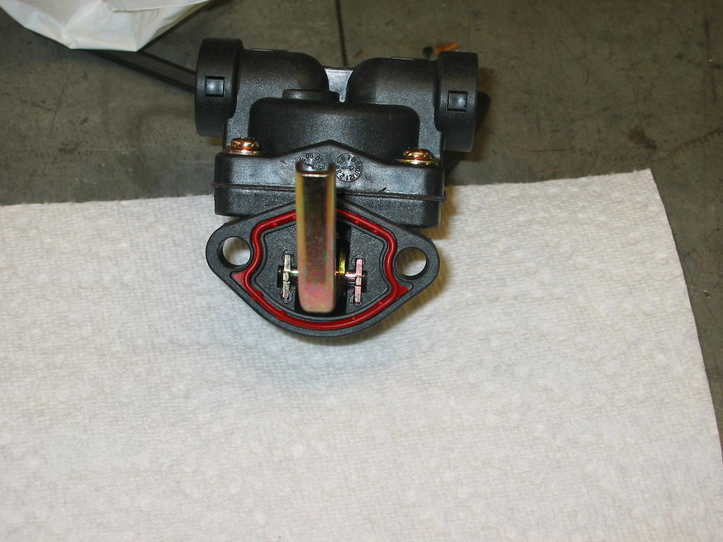

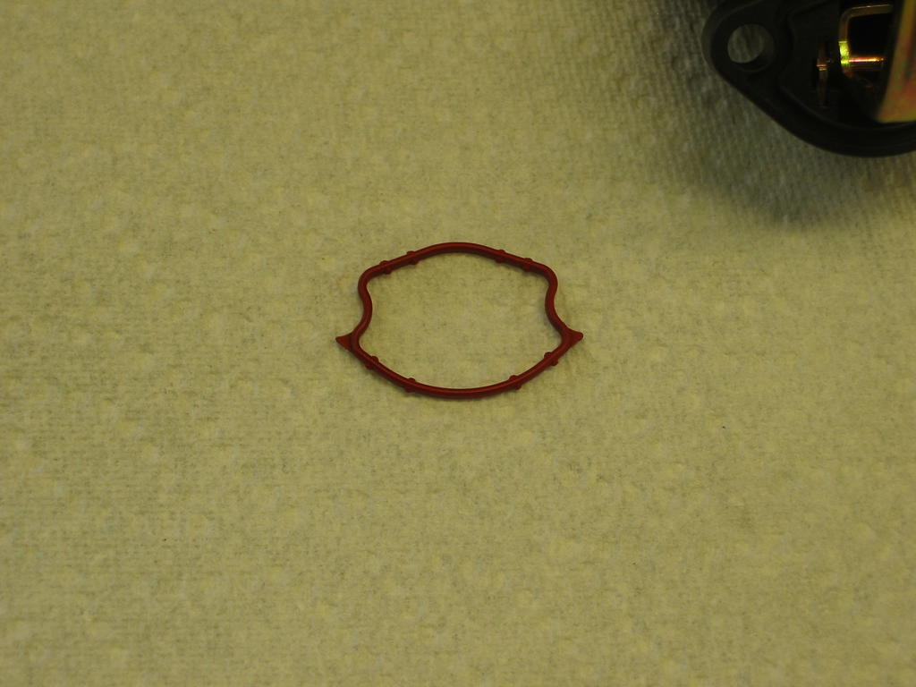

pfrederi 21,184 #2 Posted February 26, 2019 (edited) Don't the plastic pumps have red plastic gasket (round cord like materiel) ? Shouldn't need any sealant. Edited February 26, 2019 by pfrederi 2 Share this post Link to post Share on other sites
The Tuul Crib 7,354 #3 Posted February 26, 2019 Eric the gasket alone should seal it unless there is a chunk of poo in the way. Check the surface of the pump to make sure it is perfectly flat. IMO see what others say. Share this post Link to post Share on other sites
ebinmaine 80,772 #4 Posted February 26, 2019 @pfrederi I'm thinking this one was a flat flange. I'll double check that. Share this post Link to post Share on other sites

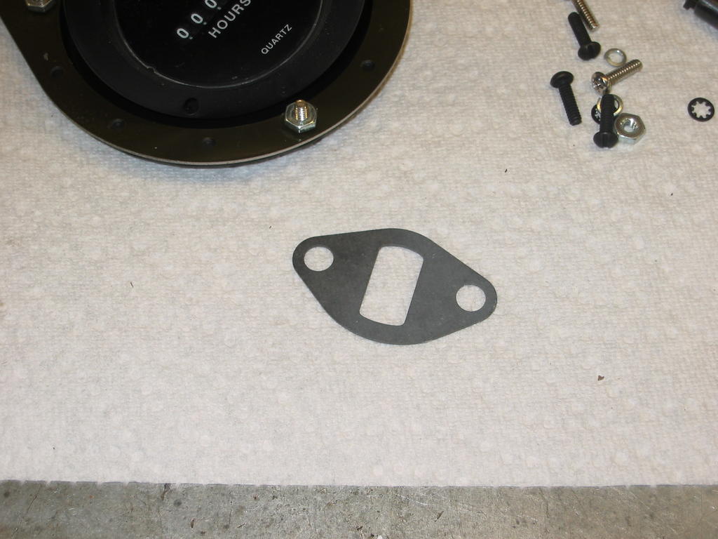

pfrederi 21,184 #5 Posted February 26, 2019 If it has a flat flange wassn't there a gasket? Like this used on the old metal pumps 1 Share this post Link to post Share on other sites
Herder 2,356 #6 Posted February 26, 2019 I have never been able to make those little red rubber thingamajigs seal properly. I have even tried a light coating of silicone and still on luck. I stick with the standard flat gaskets. And i have used them on all types of fuel pumps. Good to go! Share this post Link to post Share on other sites

ebinmaine 80,772 #8 Posted February 26, 2019 43 minutes ago, pfrederi said: If it has a flat flange wassn't there a gasket? Like this used on the old metal pumps I don't know if it has a Groove in it or not. I took it off the spare parts Shelf and it never occurred to me that it would have had one of those rubber seals. 2 minutes ago, pfrederi said: Another reason why I no longer buy the plastic pumps...If i have a fuel pump issue she gets an electric. Even a US made Facet electric is cheaper than the plastic ones (which who knows where they are made??) I had already been thinking about changing over to one of these. What do you use as a block off plate for the fuel pump hole in the front of the engine? Share this post Link to post Share on other sites

classiccat 548 #11 Posted February 27, 2019 I wonder if 3M #847 would be suited for that rubber seal. I use it on outboard waterpump spaghetti seals per the Evinrude/OMC service manuals. Link: https://www.3m.com/3M/en_US/company-us/all-3m-products/~/3M-Nitrile-High-Performance-Rubber-and-Gasket-Adhesive-847/?N=5002385+3293194226&rt=rud Share this post Link to post Share on other sites
