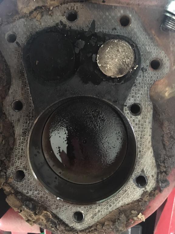

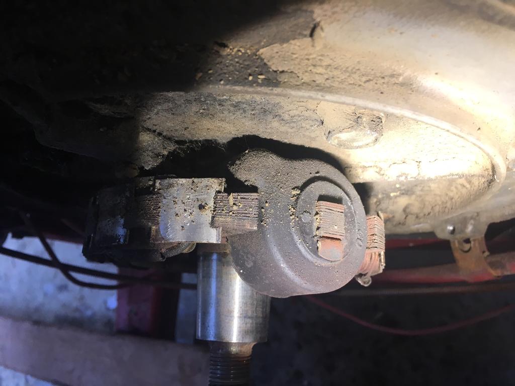

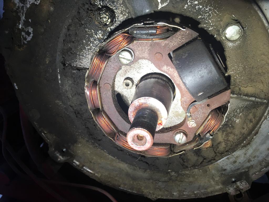

12 hp Kohler 1,020 #1 Posted February 21, 2019 The 12hp kohler k301s on my charger 12 has been running on and off for the past month now. Sometimes i will go to start it and it will fire right up and run great, then i will get it out and drive it around a little bit. while i am driving it it will randomly just cut out and stop running. After it cuts out it is almost imposible to get it to start again. Other times i will go to start it and i will have to crank it so long that it kills the battery. Sometimes when it starts it will do this half running sputtering miss firing thing and will sometimes fire up but other time stall out. So far i have rebuilt the crab and reset the carb screws, i have adjusted the points and put a new condenser in, and put a new spark plug in. The engine seems to have decent compression and good spark. I took the head off the other day and other than a lot of carbon build up it seemed okay but there did seem to be more oil on the piston than usual, the head gasket looked wasn't leaking at all. Any Opinions or thoughts on what the problem might be ? Picks of Magneto and Carbon on piston. Share this post Link to post Share on other sites
formariz 12,381 #2 Posted February 21, 2019 Oil is definitely leaking past your rings hence not only the visible oil but also the "clean" part of piston. That I don't think will prevent it from running. Did you check for spark when it stalls and wont start back up?Did you check condition of points and condenser? 2 Share this post Link to post Share on other sites
Mike'sHorseBarn 3,605 #3 Posted February 21, 2019 Sand your contacts on the magneto, coil, and flywheel. Check your points and condenser as well, if they haven't been checked in a while, I'd just go ahead and replace them just to be safe. I had this trouble on k91 that has the same type of setup and it ended up being the coil though. 1 Share this post Link to post Share on other sites

squonk 47,423 #5 Posted February 21, 2019 How clean is the plug when it starts running bad? I had a k301 that didn't smoke but pushed so much oil and crap out it would foul out the plug in 5 minutes. 1 Share this post Link to post Share on other sites
12 hp Kohler 1,020 #6 Posted February 21, 2019 Thanks for the info guys, I did forget to Say that is does foul the plug a lot and also sometimes puffs smoke. It may need rebuilt. Share this post Link to post Share on other sites
953 nut 67,500 #7 Posted February 21, 2019 2 hours ago, 12 hp Kohler said: Thanks for the info guys, I did forget to Say that is does foul the plug a lot and also sometimes puffs smoke. It may need rebuilt. Robbie, that shiny cylinder wall and oil wash on the piston do look like a little refresh is in order. Prior to pulling it apart I would suggest cleaning up the points, flywheel and coil like Mike @Mike'sHorseBarn suggested so you know the condition of your ignition system. 2 Share this post Link to post Share on other sites
richmondred01 2,383 #8 Posted February 24, 2019 (edited) Where there’s smoke there’s fire....that’s an ugly cylinder, piston and valves. I can see the piston gap. my guess is at minimum it needs to be bored and valves seats ground. I also suspect the crank will need to be ground. Do it once correctly and don’t look back. Edited February 24, 2019 by richmondred01 4 Share this post Link to post Share on other sites
12 hp Kohler 1,020 #9 Posted February 27, 2019 Over the weekend I cleaned up the carbon on the head and piston and around the valves. Also sanded the surfaces on the mag and the inside of the fly wheel. Put it back together and tried it out. It runs a little better now but still smokes like crazy when I throttle it up. Also has a lot of trouble starting and staying running on low idle. Looking like it needs a good rebuild. 1 Share this post Link to post Share on other sites
Rob R 989 #10 Posted February 27, 2019 The 301 is a great engine, the Kohler manual has the min and max stats many times the block and bore is good all that is needed is a good cleaning and honing (to restore cross hatching on the bore) along with a new piston and set of rings. 1 Share this post Link to post Share on other sites
