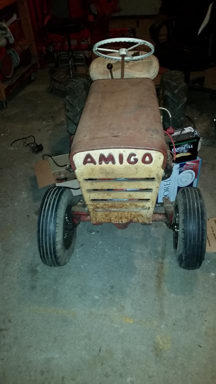

WHX?? 52,925 #2 Posted February 21, 2019 (edited) K160 Jabel? Sure it's not a 161? No matter a good non WH to have in yer herd. Not to steal your thread guy but I haunt GTalk the same as you.... but lookit what I scored... I KNOW you been lookin!! Seems I got your penchant for picking the worst project tractors tho! Edited February 21, 2019 by WHX22 2 1 Share this post Link to post Share on other sites

WHNJ701 4,167 #6 Posted February 21, 2019 58 minutes ago, WHX22 said: K160 Jabel? Sure it's not a 161? No matter a good non WH to have in yer herd. Not to steal your thread guy but I haunt GTalk the same as you.... but lookit what I scored... I KNOW you been lookin!! Seems I got your penchant for picking the worst project tractors tho! yeah buddy those amigo's got one cool drive set up on them. Share this post Link to post Share on other sites

oliver2-44 10,978 #11 Posted February 21, 2019 1 hour ago, WHX22 said: Seems I got your penchant for picking the worst project tractors tho! I resemble that remark! Both of you have cool project we want to see more pictures of. A round nose Bolens is on my list. The Amigos are also really cool. I thankfully walked away from one for sale on GT talk a few years ago...missing way to many pieces. 1 Share this post Link to post Share on other sites
WHX?? 52,925 #12 Posted February 21, 2019 10 hours ago, oliver2-44 said: ...missing way to many pieces Agreed Jim & always the problem when you have that cool odd ball tractor in your herd....and the fact that there are no dedicated sites like RS here to find the pieces to the puzzle. Best one can do is wander the flea markets at shows hoping you find something or make your own parts. Share this post Link to post Share on other sites
