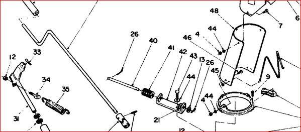

Jason Hunt 3 #35 Posted December 4, 2023 @lynnmor I have a question regarding these. Do they help the chute stay centered so as the gear notches on the chute stay engaged with the gear that turns the chute? Share this post Link to post Share on other sites
lynnmor 9,050 #36 Posted December 4, 2023 25 minutes ago, Jason Hunt said: @lynnmor I have a question regarding these. Do they help the chute stay centered so as the gear notches on the chute stay engaged with the gear that turns the chute? If your old ones are severely worn or cracked, then gear engagement would be improved with new ones. My guides have a bit more surface to center the chute. You might be able to adjust the amount of clearance for the gears by moving the worm bracket #6. Share this post Link to post Share on other sites
Jason Hunt 3 #37 Posted December 5, 2023 I actually moved the worm gear as close as possible and shimmed the right side of bracket #6 and it works so far. Just dont know how it will hold up when the white stuff starts flying. I appreciate your response and will keep your product in mind and may oder some in the future if you have em on hand. Again, thank you for your time and input. Greatly appreciate it! 1 Share this post Link to post Share on other sites

OldWorkHorse 3,156 #41 Posted February 3, 2025 (edited) Thanks for the tag @ebinmaine! Hello @lynnmor I was looking to see if you had any sets of the tall chute snowblower guides mine are seeming a bit worn! Thank you. Edited February 4, 2025 by OldWorkHorse 1 Share this post Link to post Share on other sites
lynnmor 9,050 #42 Posted February 3, 2025 4 hours ago, OldWorkHorse said: Thanks for the tag @ebinmaine! Hello @lynnmor I was looking to see if you had any sets of the tall shoot snowblower guides mine are seeming a bit worn! Thank you. I sent you a PM. Be aware that the guides have plenty of clearance from new, I make them with the same clearance. 1 Share this post Link to post Share on other sites
OldWorkHorse 3,156 #43 Posted February 4, 2025 2 hours ago, lynnmor said: I sent you a PM. Be aware that the guides have plenty of clearance from new, I make them with the same clearance. That's fine worse case I have a spare set. Mine have sum pretty good groves cut into them from wear and allow the chute to move around to point gears won't engage. 2 Share this post Link to post Share on other sites

Lagersolut 806 #50 Posted November 13, 2025 When I restored the tall chute in my profile pic in 2019 one thing I forgot was the chute guides and washers on the worm gear - 2 winters my worm gear would lose contact with the chute teeth - after replacing the guides and the washers worn and rusted away on the worm gear it was a 100% success - 13 and 21 - after looking at this parts list realized my spring washer left the chat . https://www.toro.com/en/parts/partdetails?id=5616&iid=304428&pid=313959 Share this post Link to post Share on other sites
