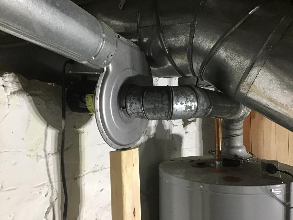

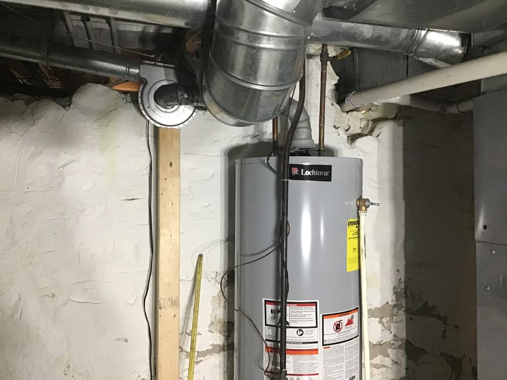

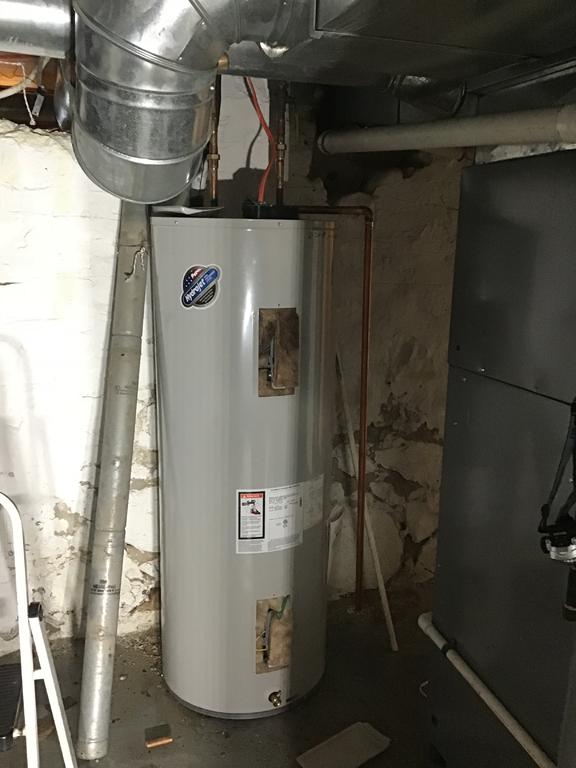

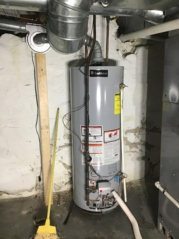

Pullstart 71,452 #1 Posted February 20, 2019 Hey Jim @WHX22 how da’ya like this power venter? We’ve replaced the pilot trying to get enough millivolts to run the valve, but the draft is too weak to sustain even a pilot. Today’s fix... a Bradford White light duty commercial electric water heater. I’ll wire it to run non-simultaneous and we’ll never have a draft issue again. 4 1 Share this post Link to post Share on other sites
953 nut 69,917 #2 Posted February 20, 2019 The unsecured 2X4 brace under the fan fits Murphy's Law perfectly! 1 3 Share this post Link to post Share on other sites

Pullstart 71,452 #4 Posted February 20, 2019 Surefire KISS. Keep it simple stupid. It’s slow to recover, but reliable. Kinda like me lately! 1 Share this post Link to post Share on other sites
ericj 1,580 #5 Posted February 20, 2019 it never stops to amaze me at some of the things people do, was this another contractor or the home owner jerry rig I probably would have put in a real power vented water heater, but they are expensive, the electric water heater is definitely cheaper eric j 1 Share this post Link to post Share on other sites
953 nut 69,917 #6 Posted February 20, 2019 You may want to consider a tankless demand water heater in the future. I installed a Navien Tankless gas water heater and it saves a lot of money on gas by only running when there is a demand. The up front cost is higher, but you will never run out of hot water and the gas cost savings will pay for it during it's useful life. 1 1 Share this post Link to post Share on other sites
Pullstart 71,452 #7 Posted February 20, 2019 I was helping out a friend in need. They bought the house this way, the previous owner installed this to close the deal. A joke if you ask me! Power vent would have been a viable option, but this was the cheapest option available and still much more reliable than the previous unit. 2 Share this post Link to post Share on other sites
