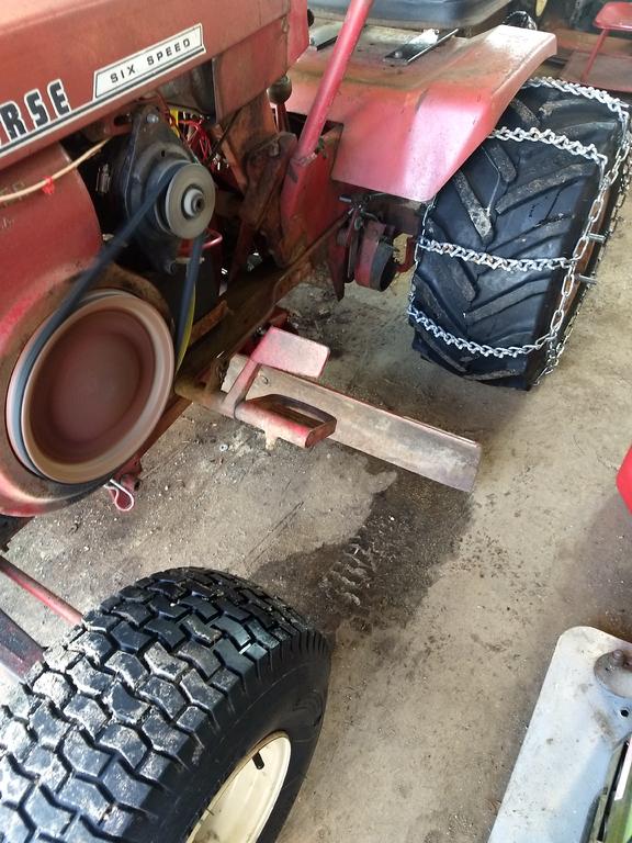

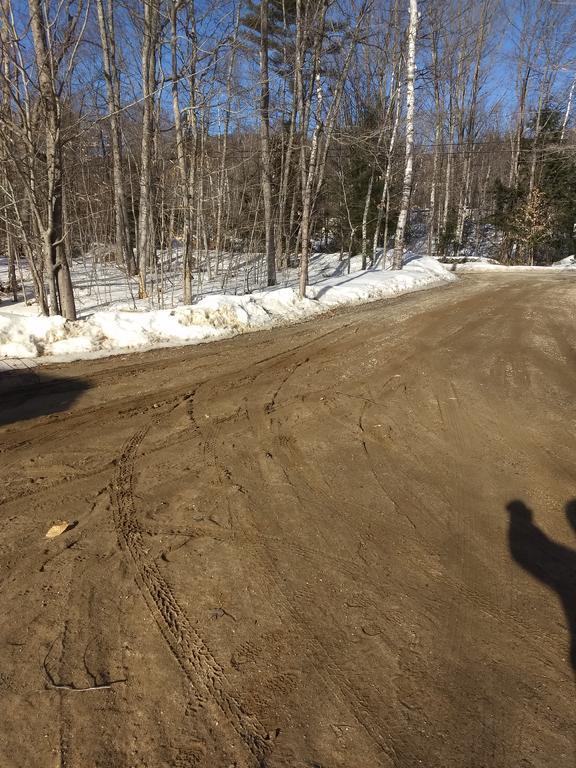

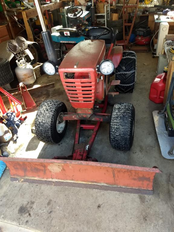

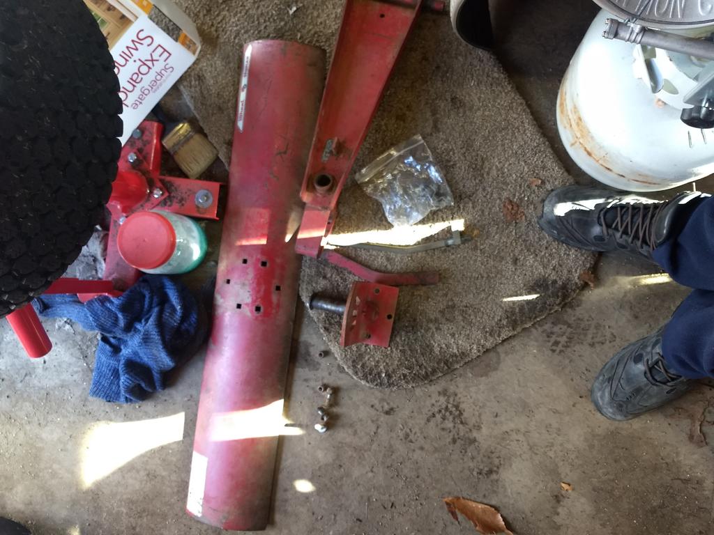

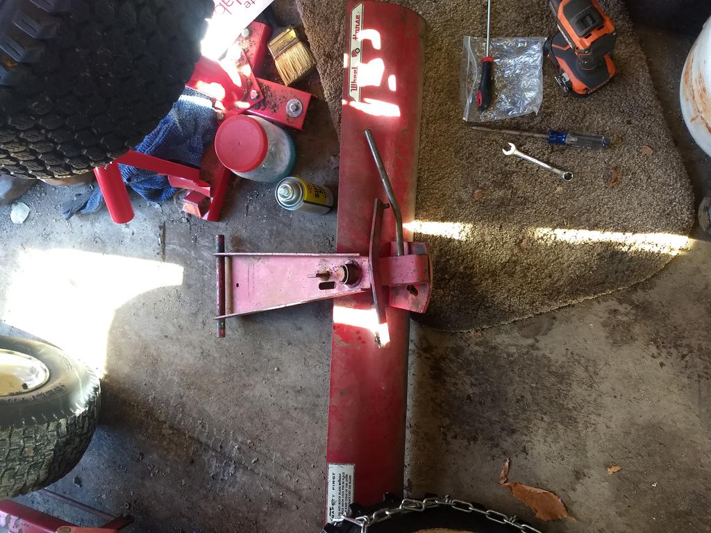

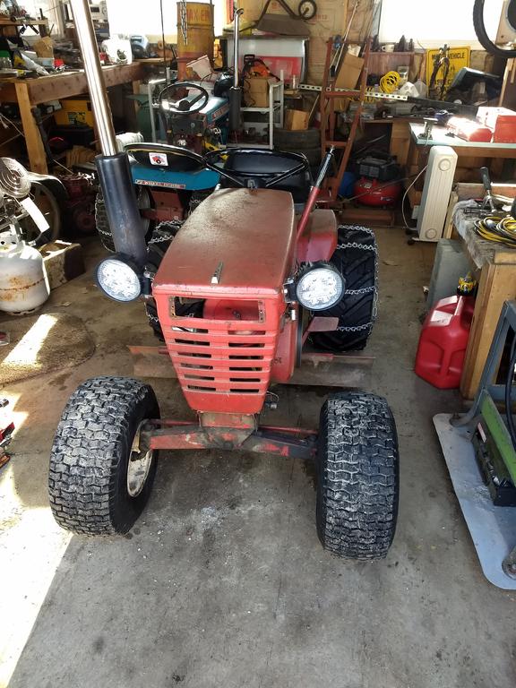

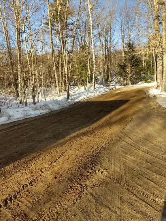

ebinmaine 80,974 #1 Posted February 10, 2019 We had a nice little thaw this past week and that made for some nice little ruts in the driveway. We have another significant snow storm coming in 2 days so I decided to scrape down the driveway a little bit. I would like to say thanks again to @Herder Adam for getting this grader and sending it to me. I assembled the grader using the owner's manual. Removed the snow plow from the 1267. Hung the grader under that and off I went..... Here's a few pics of the grader and tractor and a before and after of the driveway. 13 7 Share this post Link to post Share on other sites
PeacemakerJack 11,074 #2 Posted February 10, 2019 Well done Eric! Looks like a great attachment to have handy for leveling out the drive and seems fairly quick and easy to install even when having to remove the blade first. 1 Share this post Link to post Share on other sites
ebinmaine 80,974 #3 Posted February 10, 2019 3 minutes ago, PeacemakerJack said: Well done Eric! Looks like a great attachment to have handy for leveling out the drive and seems fairly quick and easy to install even when having to remove the blade first. As most of you are aware we just started using implements here on our acreage only in the past 3 months since we decided to try a plow for snow. I've read multiple times about how quick and easy it is thanks to the Pond family to change implements from one to another. Remove Dozer / snow plow. Four pins, two levers, one bolt. Install mid-mount grader. Two pins. Now all that said. That absolutely DOES NOT MEAN that I have any intention of swapping implements because I fully believe that we should all be allowed ONE TRACTOR PER IMPLEMENT, minimum. 6 2 1 2 Share this post Link to post Share on other sites

WHX?? 58,307 #8 Posted February 11, 2019 I woulda thought the ground was frozen solid?? Mid mount use is a summertime sport only around here. It is amazing how well they work. Not one shovel was hurt in the making of this driveway! 2 3 Share this post Link to post Share on other sites

ebinmaine 80,974 #11 Posted February 11, 2019 49 minutes ago, WHX21 said: woulda thought the ground was frozen solid In the sunny areas only, it was thawed for a few inches on the surface. 1 Share this post Link to post Share on other sites
Sarge 3,473 #12 Posted February 12, 2019 I just noticed - your 1267 has a headlight opening - is that the original hood by any chance? Almost all '67 year models had a 7-slot grill and no headlight, but it seems some late model year units were shipped with the '68 headlight-equipped hoods. Just wondered... Sarge Share this post Link to post Share on other sites
WHX?? 58,307 #13 Posted February 12, 2019 If I'm not mistaken Sarge the '67 six speeds had the headlight & 6 slot. My 1067 does but I do not know if it was a late '67 model. Might have been a late year 67 thing? The 3 speed 67's did not nor does my 10 & 1277's autos. I guessing so WH could sell the optional HL kit?? Share this post Link to post Share on other sites
ebinmaine 80,974 #14 Posted February 12, 2019 8 minutes ago, Sarge said: I just noticed - your 1267 has a headlight opening - is that the original hood by any chance? Almost all '67 year models had a 7-slot grill and no headlight, but it seems some late model year units were shipped with the '68 headlight-equipped hoods. Just wondered... Sarge Sarge, I've only had it since last August so ... I have no way of knowing. Sometimes you can look at a machine of any given type and decide for yourself that it "probably might be this" or "probably might be that." This particular machine has a 1970 model 8-speed instead of the original 6 speed, and also had the later vintage heavy duty hubs installed. Other than the non Wheelhorse replacement generator that was in it the rest of the tractor did not appear to be altered and had a similar patina. My guess would be that it likely is the original Hood. 1 Share this post Link to post Share on other sites
Sarge 3,473 #15 Posted February 13, 2019 Ah, no problem. As I've found - seems the later built '67 1077 & 1277 models had the headlight opening, some were even blocked off with a metal plate, some actually had the light and a different dash panel with the switch. The second 1277 I had came with the opening in the hood and the metal plate - my early serial number 1277 I've had for the longest of all the WH models has the original 7-slot grill and no light opening, as most of the '67 models that had the hydro. I forgot the manual transmission models had the later style hood - no idea why they did that but then again in the '60s WH did some odd things to use up old inventory. It is fun to see what the differences were and the somewhat oddballs we find out there. The history of unknown owners doing things to these tractors adds to the fun - trying to decipher what someone did in the past can be interesting, to say the least. Sarge 1 Share this post Link to post Share on other sites
