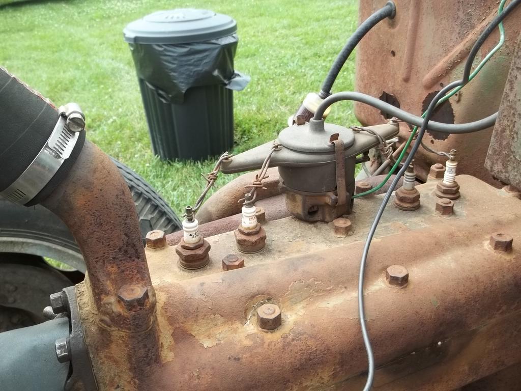

WHX?? 57,470 #9 Posted February 5, 2019 Don't lookit me Squonk... I used a piece of 18 ga thermostat wire once in a pinch... 1 4 Share this post Link to post Share on other sites

squonk 47,423 #14 Posted February 5, 2019 8 hours ago, WHX21 said: Don't lookit me Squonk... I used a piece of 18 ga thermostat wire once in a pinch... Did you use red or commom? 2 Share this post Link to post Share on other sites
