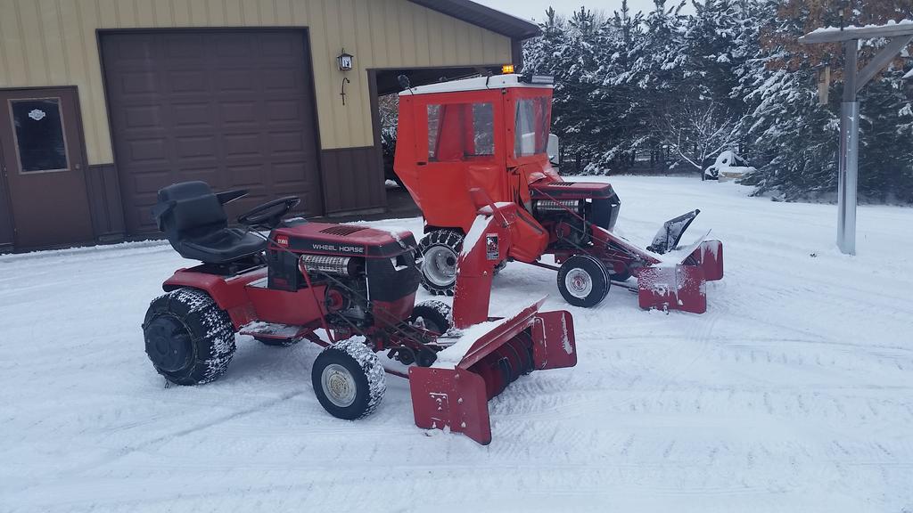

WHX?? 58,307 #7 Posted January 30, 2019 (edited) I have one of each and both have their place. The short chute is good for light snows and you don't have to throw it far. Heavy snow it poorly performs and slushy snow will rip the chute right off. I have welded mine up countless times. Then there is the cable turn on the short. Not the best invention and a real PITA to keep working as should. Very subject to freezing up. Tall chute will reach up over tall banks and throw much further and as Ed said and gear rotator is a much needed improvement. Adding a piece of pipe to inside of chute increases performance but will plug up worse in the wet stuff. Down side is the chute attaching blocks can break and replacements are $$. All said go for a tal chute if possible or convert a short to tall which is fairly easy if you can find a donor tall. One of these days I will swap blowers on these 520's. Edited January 30, 2019 by WHX21 Share this post Link to post Share on other sites

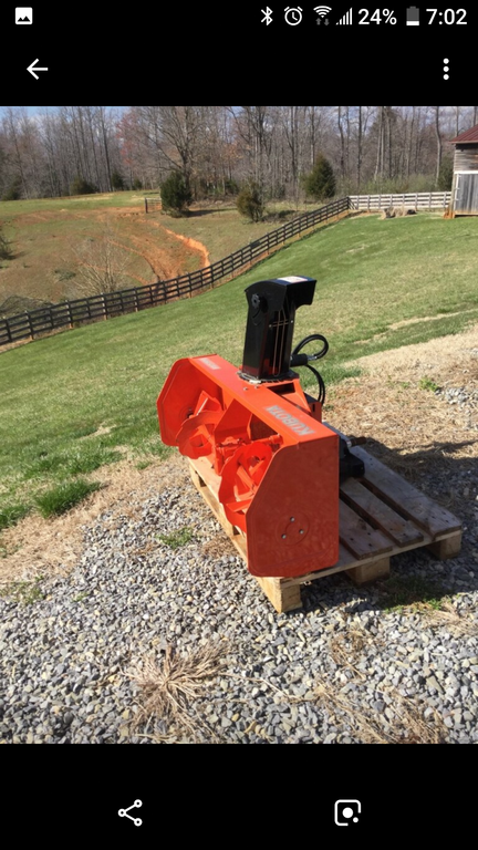

WVHillbilly520H 10,379 #10 Posted January 30, 2019 (edited) 7 minutes ago, WHGuy413 said: I have a 44" Ber-Vac 2 stage on my 416H I meant Ber-Vac which is now Berco... Which makes most of the snow blowers for the sub compact/compact tractors like my Mahindra or Kioti (I just bought a Kubota version to retrofit to my eMax) Edited January 30, 2019 by WVHillbilly520H 1 Share this post Link to post Share on other sites

Ike 94 #15 Posted February 2, 2019 On 1/30/2019 at 9:33 AM, WHX21 said: I have one of each and both have their place. The short chute is good for light snows and you don't have to throw it far. Heavy snow it poorly performs and slushy snow will rip the chute right off. I have welded mine up countless times. Then there is the cable turn on the short. Not the best invention and a real PITA to keep working as should. Very subject to freezing up. Tall chute will reach up over tall banks and throw much further and as Ed said and gear rotator is a much needed improvement. Adding a piece of pipe to inside of chute increases performance but will plug up worse in the wet stuff. Down side is the chute attaching blocks can break and replacements are $$. All said go for a tal chute if possible or convert a short to tall which is fairly easy if you can find a donor tall. One of these days I will swap blowers on these 520's. I have the same two snow blowers and I find the short chute to be a great blower. Mine handles big snow with no problem bolted on my 314h. The only thing I am not a fan of is the cable chute rotator. It does require constant adjusting. Share this post Link to post Share on other sites
