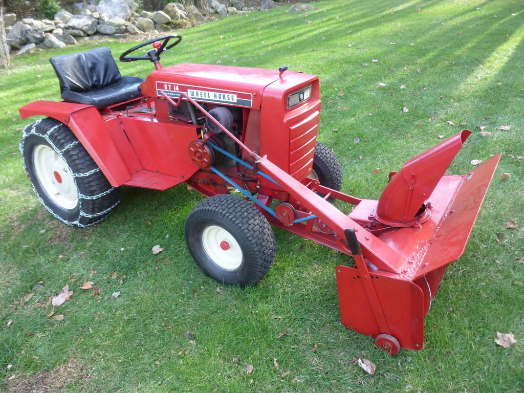

ztnoo 2,300 #2 Posted January 28, 2019 Well, on the back of my first year 1969 model 1-7441 GT 14 Owners Manual, it lists a 37" Snow Thrower (6-6212) with (6-9122). I would assume the last part number is the drive mechanism/carrier for the thrower/blower. So, one can deduce if the factory listed a snowblower for a GT 14, it could do the work. 1 Share this post Link to post Share on other sites

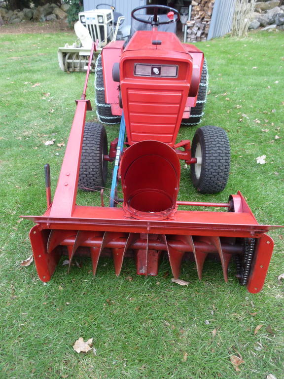

Rob R 977 #8 Posted January 28, 2019 Hi WVHillbilly, don't have a ton of $ so I fabri-cobbled a tach-0-matic on the front with a single stage and it works just fine. 3 2 Share this post Link to post Share on other sites

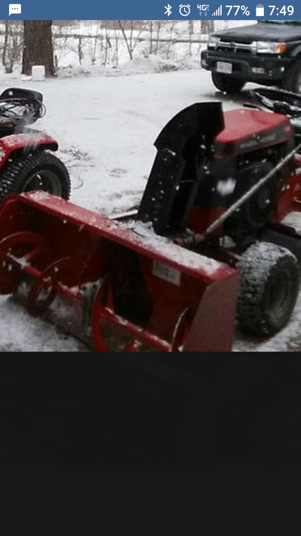

WVHillbilly520H 10,377 #9 Posted January 28, 2019 Here's what that 2stage made by Berco looks like... Share this post Link to post Share on other sites
ztnoo 2,300 #10 Posted January 28, 2019 I've been researching a little more. @Rob R, it might be helpful to know the model number of your snowblower for this discussion. The video is very helpful to judge the efficiency of the implement. Thanks. I'm unsure looking at it, the width of snowblower you have. I'd say that works pretty well given its a single stage Snowblower. Looks like maybe you are going through a snow depth of 6-8". The auger speed appears to be pretty high, so that would really help shoving snow through the chute. Obviously, wheel weights and chains (either metal or rubber) are likely a necessity. @RickF, From what I've discovered, the snowblowers designed to specifically go on a GT 14 are all single stage. The numbers I originally gave from my 1969, Model 1-7441 GT 14 are: Snow Thrower (6-6212) with Completing Package (6-9122), have manuals here at Red Square. In looking thru the snowblower manual choices here at Red Square, I do see many other 37" snowblowers that possibly might be adaptable to the GT 14, as long as they were specifically designed to fit on long frame tractors, and the had the appropriate Completing Packages, and with possibly some inventive, on site engineering by an owner. I just don't have any experience with these implements on a Wheel Horse tractor, so I'm just citing what I have found in the manual files here at Red Square. Hope you can arrive at something that is doable and workable for you. 1 Share this post Link to post Share on other sites
Rob R 977 #11 Posted January 29, 2019 ZTnoo the blower # is 6-6215 and is 36" . The snow I am blowing is 6-7 inches and it was very WET, when the snow is powder it blows it like there is nothing there.... You are correct you definitely need Chains and Weights are also the way to go. A plus also is that the chute does not clog I do wax it before ever usage with carnuba wax. 1 Share this post Link to post Share on other sites
