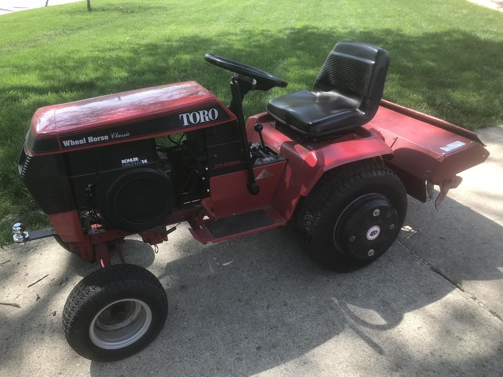

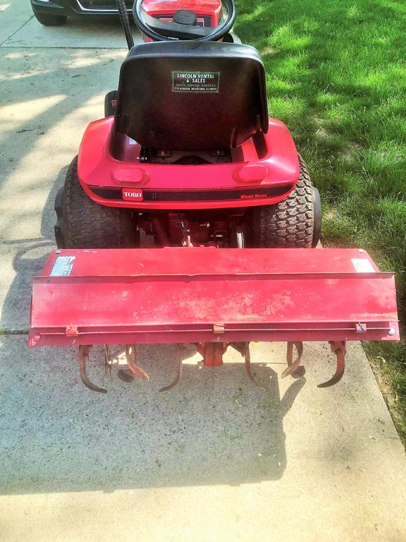

Ed Kennell 46,203 #7 Posted January 27, 2019 8 hours ago, MIGHTYMO said: Hey everyone. I'm new to the site and have a few questions. First a little info on my tractor. Have a 1996 314-8 that I bought for $10. Yall read that right, $10. Everything worked other than the drive belt to the deck wouldn't fully engage and the battery was dead so we jumped it to load it up. Charged it up when I got home and it fired right up. I have tightened the belt with the tensioner but it still won't engage. The guy I got it from said he bought a generic belt so I'm thinking its too big but at the same time the pulley slips on the clutch plate. It will hesitate but not engage. Here are my questions, 1. Do yall think its the deck drive belt or the clutch? As stated above, adjust the length of the PTO engagement rod to increase the pressure on the clutch plate. If the mule drive has enough adjustment range to tighten the belt, It is not too long. 2. Can a tiller be attached to a 314-8? Yes If so, where is a good place to look for one? Tillers are not too common, but they do show up on Craigs list occasionally. I have bought several over the past 20 years. 3. Where is a good place to look for parts in general? Like new belts or possibly a clutch I like Tractor Supply for belts. If the previous owner of the 314 has anything else he wants to sell i.e. cars, trucks, livestock, furniture, boats ,etc., Please let us know. I have a handful of ten dollar bills and a big trailer. And Mo, to the 6 Share this post Link to post Share on other sites

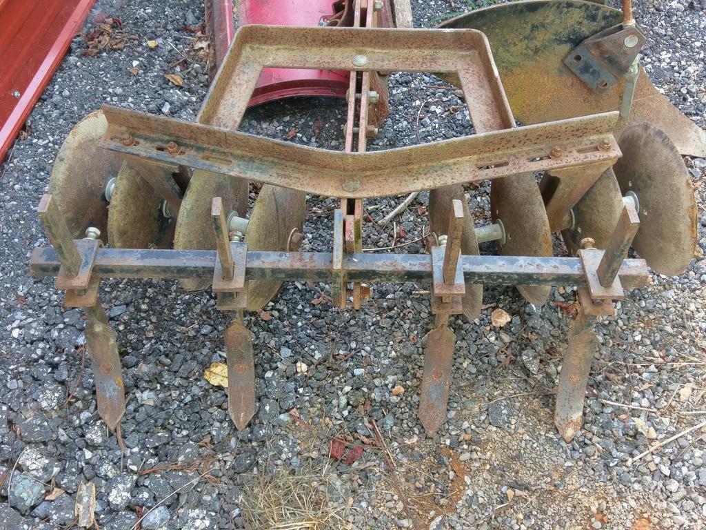

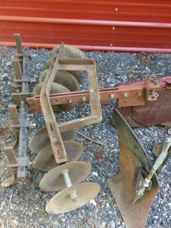

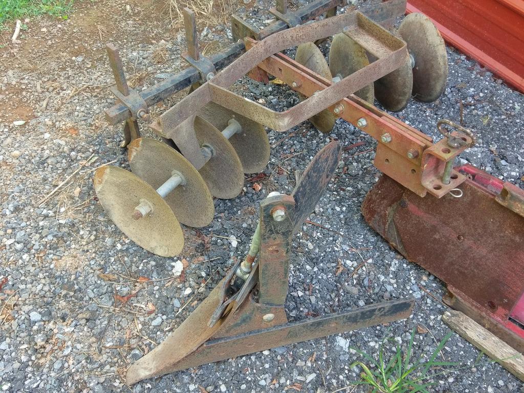

WVHillbilly520H 10,378 #9 Posted January 27, 2019 @MIGHTYMO, I could hook you up with all of your Wheel Horse gardening needs, a tiller as well as the rare "tool bar" culivators disc and moldboard plow, BTW to fellow Virginian. 3 Share this post Link to post Share on other sites
Lane Ranger 11,980 #10 Posted January 27, 2019 (edited) Love the 314-8 tractor. We have two of them and they are good all around tractors. One set up for snow duty this year and one always set up with the tiller for the annual vegetable garden. Edited January 27, 2019 by Lane Ranger 2 Share this post Link to post Share on other sites

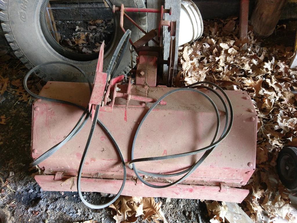

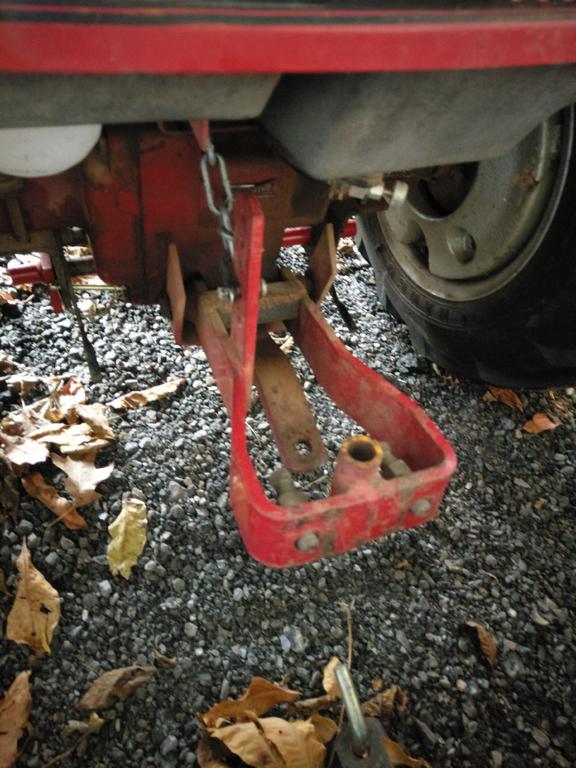

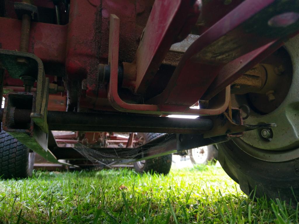

WVHillbilly520H 10,378 #15 Posted January 27, 2019 1 hour ago, MIGHTYMO said: @Lane Ranger and @WV Hillbilly, how does the tiller operate? Like how does it get power? From the same PTO that runs the deck, there's a belt (141") that runs back to the tiller, you need a rear axle bracket/hitch (that the snow plow also mounts into) as well a rear rockshaft and cable for rear attachment lift. 1 1 Share this post Link to post Share on other sites
JoeM 10,035 #16 Posted January 27, 2019 Mo, if you look on the video you will see a drive belt the runs from the PTO under the rear axle to power the tiller. 1 Share this post Link to post Share on other sites
