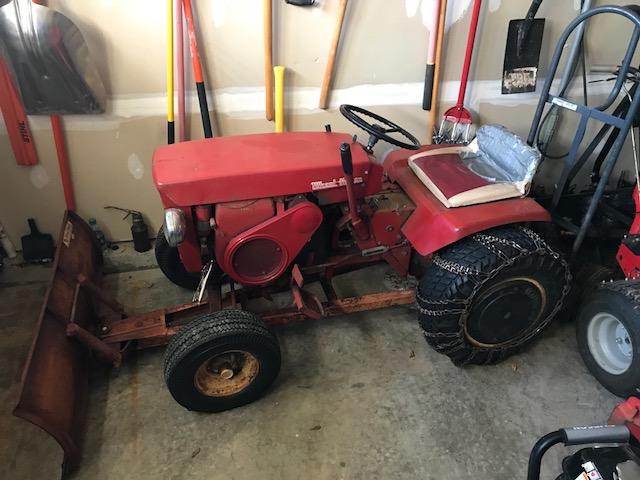

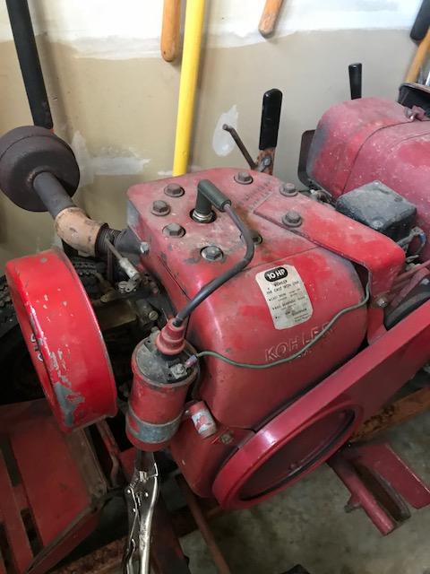

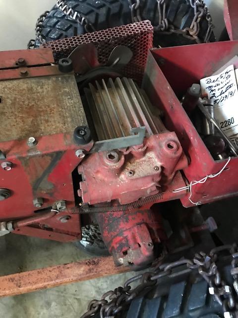

Dashunde 6 #1 Posted January 25, 2019 Hi all, first post here. For the past 12 years I've had my (RIP) Grandpa's WH 1075 hydro. I was with him in 1976 on the day he bought this tractor used. Its been the family "darling" for nearly 3 generations, besides his Starcraft boat this tractor was his prized - or at least most cared-for - possession. Over the recent years the paint has faded quickly despite being garaged, but cosmetics are my secondary concern. Its been my trusty plow tractor for a decade or so, the mower deck rotted/discarded long ago (I have a Gravely WB for mowing) it has amazing torque for pushing big piles of snow but the hydro is getting a bit tired and requires much more throttling nowadays, especially reverse. I need advice for correcting the following: - 10 hp Kohler runs great, always starts, but the governor quit, it'll rev to the moon if allowed. Carb float sticks occasionally, leaks a little fuel (even has dings on the bowl from Gramps tapping it). And I might rebuild it from the bottom up if you all can point me in the right direction of a reliable parts/gasket kit and manual. - The hydro drive is getting a little weak, what are my rebuild options? Would prefer a knowledgeable local St Louis shop, anyone know of a good option? - Once the mechanicals are up to snuff I'll move onto a partial (not full tear-down) sandblast and refinish. Anything I need to be aware of here? Seems simple enough.. blast and basic refinish with single-stage red.. Anyway.. this is where I start. Your thoughts are greatly appreciated. Thanks, Rob Ps.. I'm good with my hands, have tons of quality tools and a space to work, so other than diving into the hydro transaxle I'm good to go. 4 Share this post Link to post Share on other sites

pfrederi 19,874 #5 Posted January 25, 2019 Kohler parts both OEM and knockoffs are widely available Hydro parts for the tune up portion can be had used.from places like A-Z tractor (look in our vendors section) O rings and seals are cross-referenced in a pinned post on the transmission forum The hydro was built by Sundstrand. If new fluid/filter and tune up don't resolve the hydro issues there are some other options but lets cross that bridge if we get to it. 2 Share this post Link to post Share on other sites

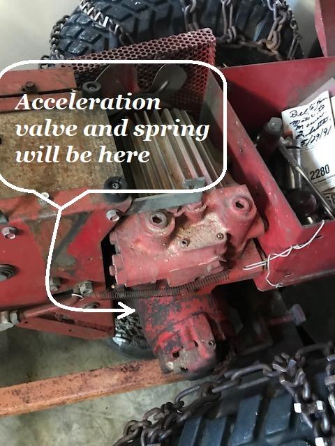

953 nut 64,108 #10 Posted January 26, 2019 17 hours ago, Dashunde said: hydro is getting a bit tired and requires much more throttling nowadays, especially reverse. I too would love to see some early photos of this family treasure, love to hear of third generation owners, As Paul said, begin bu changing the transmission fluid, if the color is Pink/red it is ATF, if it is amber it was changed to 10 W 30, stick with what you find. Your transmission filter would be a NAPA 1410. If the problem persists it may be your Acceleration Valves and their springs. The valve for reverse is at the front on the left side. You will see the valves and springs in the manual. Keep on posting and we will help all we can. 1 Share this post Link to post Share on other sites

Dashunde 6 #13 Posted February 16, 2022 When I said I was "in the beginning of restoring" I meant it lol.. life/wife/kid have all conspired to ruinate my fun. Plus there hasn't been much snow in the past couple of years, until last week, which prompted me to fire up the ol tractor and plow the drive, which in turn prompted me to finally order some parts for it: Governor shaft - mine spins all the way around, I can only assume the flag/tab part is broken off. Governor gear - might as well while I'm in there New carb from isavetractors - it still runs good once started, but float sticks/floods after its been sitting a year or so, plus the throttle shaft rattles around a little. New complete gasket kit - self explanitory. So.. here goes, wish me luck 2 Share this post Link to post Share on other sites
ebinmaine 77,323 #14 Posted February 16, 2022 1 hour ago, Dashunde said: When I said I was "in the beginning of restoring" I meant it lol.. life/wife/kid have all conspired to ruinate my fun. Plus there hasn't been much snow in the past couple of years, until last week, which prompted me to fire up the ol tractor and plow the drive, which in turn prompted me to finally order some parts for it: Governor shaft - mine spins all the way around, I can only assume the flag/tab part is broken off. Governor gear - might as well while I'm in there New carb from isavetractors - it still runs good once started, but float sticks/floods after its been sitting a year or so, plus the throttle shaft rattles around a little. New complete gasket kit - self explanitory. So.. here goes, wish me luck On that carb you're likely better off to clean/rebuild the OE carb than replace. Can you post a video of just how loose the shaft is? That may be repairable. 1 Share this post Link to post Share on other sites
