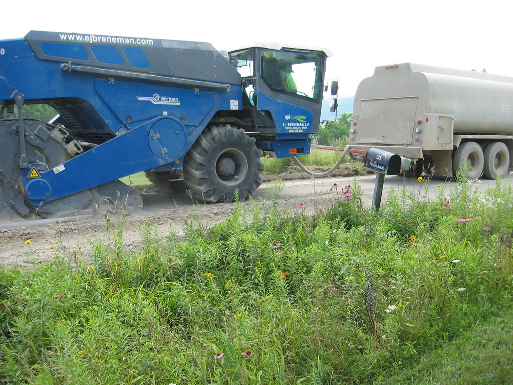

pfrederi 21,246 #9 Posted January 25, 2019 Rent one of these!!! 3 1 Share this post Link to post Share on other sites
Cetan08 311 #10 Posted January 25, 2019 2 hours ago, pfrederi said: Rent one of these!!! Now there is a good idea. They don't have a noise law where I live so I could start working about 5am so I could avoid blocking the neighbors from going to work. Not sure I could even find something like that around my neck of the woods. I like it. 2 Share this post Link to post Share on other sites

Sarge 3,473 #16 Posted January 26, 2019 That's just a modified surface grinder - there are some versions that have a built-in hopper used to mix in different rock types or in your case, cement. Again, it all goes back to soil type and what you have to work with. Asphalt millings are good, but they must be properly bladed after being laid - especially if the temperature is hot outside as they will easily lock back together and start forming hardened chunks that will create bumps and holes. Geo-tex is a great product, but if it is used on the wrong base rock layer without proper compaction its a waste of time and will actually cause problems. We had to build a network of roads in a corn field for a solar plant on a job a few years ago - that took 4 different types of rock, 2 layers of Geo-tex, silt fabric and a lot of time with heavy rollers to get the compaction correct. Once it was all done, that held up perfectly despite a lot of flooding rain and heavy equipment traffic while we built the plant - a total of a 2yr job. Roads are still there and look just as good as when we built them. You really have to identify your soil type. I'm no expert on the subject by any means, but the wrong type of black dirt cannot be used as a base of any sort. The right types, like around my area will compact nearly as good as concrete and last a long time if properly covered. It's all about sand and clay content, but more specifically what types of each. If it cannot be compacted, that will require removing a certain depth to be able to build a proper base, then a top layer of choice - such as asphalt millings. Most areas now recycle those millings back into the local roads and are highly valued by the asphalt companies since it saves them a lot of money on raw materials. Around here, its nearly impossible to get ahold of any more than a straight truck sized load. Years ago, we couldn't find enough places to dump the stuff as the State wouldn't allow it to be re-used - we built up one farmer's gravel road up nearly 18" deep and graded/rolled it in for free just to get rid of the material. Now, its recycled, go figure. Sarge 1 Share this post Link to post Share on other sites

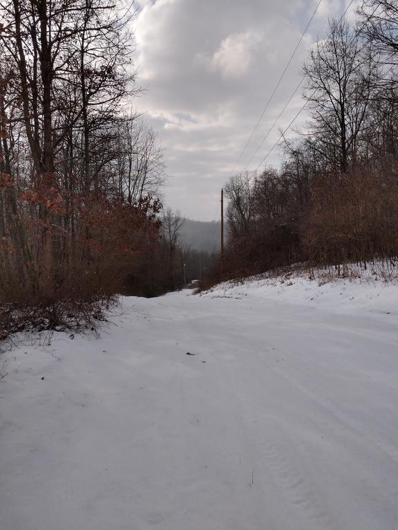

Cetan08 311 #20 Posted January 26, 2019 Just a couple of pics. of the road today. Sorry it is snow covered but just for perspective. Only three homes up top, mine, a neighbors that is onle here in the summer and a rental. The one picture is just the first drop and then the road drops two more times before getting to the state road. All the drops are about the same incline. Share this post Link to post Share on other sites
AMC RULES 37,260 #21 Posted January 26, 2019 Looking like you have no consideration for drainage there. Share this post Link to post Share on other sites
Digger 66 3,530 #22 Posted January 26, 2019 What do the other homeowners along the road do ? Share this post Link to post Share on other sites
Sarge 3,473 #23 Posted January 27, 2019 Your biggest problem is drainage - it either needs to have a proper ditch on both sides or build the road up until it is higher than the surround banks. Otherwise, it will just collect water and get saturated, which is why it keeps creating holes. With those current elevations - that will require a lot of material to say the least. If the wet areas are not cored out and addressed before trying to fix it, you'll lose the battle with soft spots and holes. I'd say you're pretty much stuck with it as-is, the cost to repair it correctly is astronomical, to say the least. The only other option other than building it up or ditching the sides is to dig down and add French drains to take the water away or tile it heavily - in the long run, it still doesn't work as they silt in and fill up with debris. Sarge 1 Share this post Link to post Share on other sites

Cetan08 311 #25 Posted January 27, 2019 43 minutes ago, Sarge said: Your biggest problem is drainage - it either needs to have a proper ditch on both sides or build the road up until it is higher than the surround banks. Otherwise, it will just collect water and get saturated, which is why it keeps creating holes. With those current elevations - that will require a lot of material to say the least. If the wet areas are not cored out and addressed before trying to fix it, you'll lose the battle with soft spots and holes. I'd say you're pretty much stuck with it as-is, the cost to repair it correctly is astronomical, to say the least. The only other option other than building it up or ditching the sides is to dig down and add French drains to take the water away or tile it heavily - in the long run, it still doesn't work as they silt in and fill up with debris. Sarge I totally agree. When I first moved up here the phone company had buried the phone cable down the middle of the road so when you grade it you cut the cable. And like I mentioned, all the know it all's would dozer the road flat and cut it lower rather than fill the holes and smooth it off. Then we get the renters that when told they must have 4x4 to live up here, they put bug mud tires on a two wheel drive and cut ruts making water channels. Good thing is, they are the ones walking now. Karma has no respect. I am just hoping that the dead beats sell out and then I can school the new people on getting the road fixed right. Share this post Link to post Share on other sites
