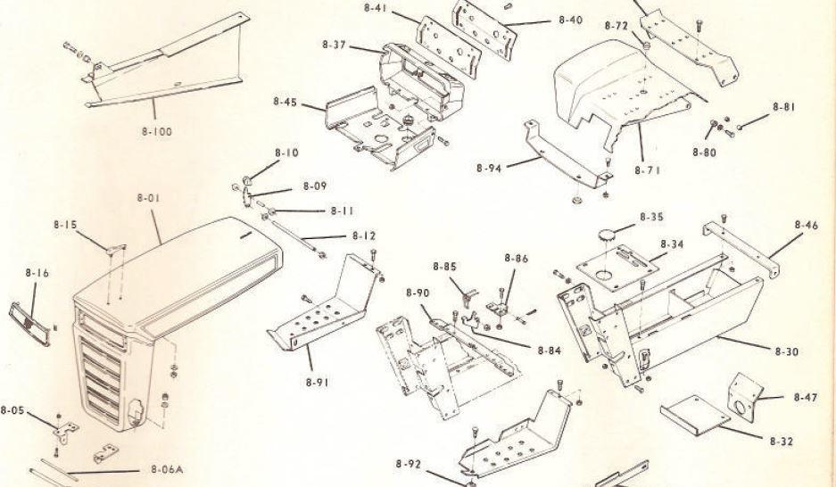

ebinmaine 79,136 #1 Posted January 24, 2019 (edited) There's a bracket that has three bolt holes and is maybe 10 in Long? 1 end is shaped like a c channel. I'm not sure exactly where and how that bolts in and I can't look at my other tractor that has that because it's under a tarp which is under a bunch of snow. Thank you in advance Edited January 24, 2019 by ebinmaine Added correct year Share this post Link to post Share on other sites

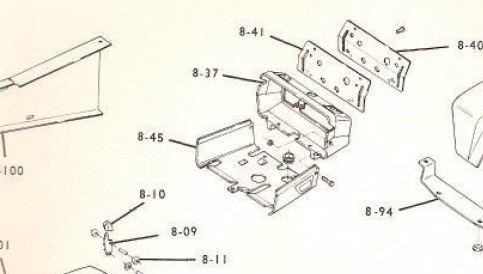

pfrederi 20,668 #4 Posted January 24, 2019 #8-45??? 1 Share this post Link to post Share on other sites
ebinmaine 79,136 #5 Posted January 24, 2019 It's actually underneath that. I'm supposing it's a support that bolts at the front of that piece and then at the top of the steering column support where those two bolts hold to the bottom of part number 8 - 37. on this particular tractor the wiring harness was held in that c channel as it came out from underneath the gas tank tray. Share this post Link to post Share on other sites

ebinmaine 79,136 #7 Posted January 24, 2019 4 minutes ago, pfrederi said: Only C I have from that vintage is asleep for the winter. Don't see what you are describing on my snow horses Charger Electros but they have similar hood stand Instrument panel gas tank support.... Yeah I don't think the older ones had it. Trina's 867 is sitting beside this tractor and it does not have that piece. I think what I'm looking for in the diagram above is cut off at the bottom of the page. I don't have the same diagram at home but both mine and this one are so exploded it doesn't show how that goes on. I very much appreciate your effort. I may have to just dig the other one out of the snow. Share this post Link to post Share on other sites

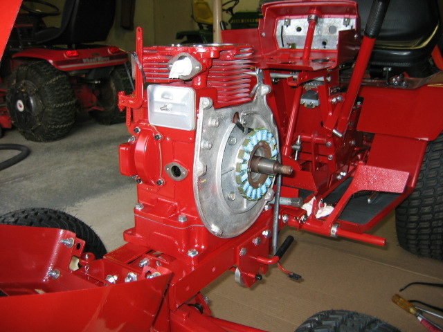

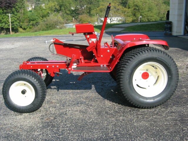

Wishin4a416 2,594 #8 Posted January 24, 2019 (edited) Not a very good picture but you can see the channel under the tank holder. Edited January 24, 2019 by Wishin4a416 1 1 Share this post Link to post Share on other sites
ebinmaine 79,136 #9 Posted January 24, 2019 2 minutes ago, Wishin4a416 said: Not a very good picture but you can see the channel under the tank holder. Yeah that's it. I'm trying to figure out how that thing bolts on. Share this post Link to post Share on other sites
Wishin4a416 2,594 #10 Posted January 24, 2019 If I remember right Eb, 2 bolts through the side into dash stand and tank support. I sold tractor or I would get you better pics. Share this post Link to post Share on other sites
Wishin4a416 2,594 #11 Posted January 24, 2019 I think you can see the 2 shiny bolts. 1 Share this post Link to post Share on other sites
Wishin4a416 2,594 #12 Posted January 24, 2019 You can see the 2 bolts in this picture. 1 Share this post Link to post Share on other sites
ebinmaine 79,136 #13 Posted January 24, 2019 9 minutes ago, Wishin4a416 said: You can see the 2 bolts in this picture. Sure can. See, that's what I was thinking as well but they don't seem to line up right. I'll have to see if I can find a very large heavy duty Hammer that's made out of a lot of metal and fix my problem. 1 Share this post Link to post Share on other sites
Lee1977 7,638 #14 Posted January 24, 2019 That channel was used for the wiring. 2 1 Share this post Link to post Share on other sites
ebinmaine 79,136 #15 Posted January 24, 2019 17 minutes ago, Lee1977 said: That channel was used for the wiring. Yeah that's the one. I guess my source of confusion is that you can see there is a bolt hole near the end of it ... and for some reason mine had about a 1.5 inch bolt sticking out. Maybe some previous owner was using it to hang something from. Share this post Link to post Share on other sites
Wishin4a416 2,594 #16 Posted January 24, 2019 I think that front hole is for a gas line clamp Eb. 1 Share this post Link to post Share on other sites
ebinmaine 79,136 #17 Posted January 24, 2019 1 minute ago, Wishin4a416 said: I think that front hole is for a gas line clamp Eb. Okay okay okay. That makes sense. I don't really understand why the bolt was so long but maybe it was one of those... Use what you have... Situations for a previous owner. Share this post Link to post Share on other sites
Wishin4a416 2,594 #18 Posted January 24, 2019 (edited) Can you see the gas line and clamp in this picture. Edited January 24, 2019 by Wishin4a416 1 1 Share this post Link to post Share on other sites
ebinmaine 79,136 #19 Posted January 24, 2019 7 minutes ago, Wishin4a416 said: Can you see the gas line in this picture. Absolutely. Perfect. Thanks people. Share this post Link to post Share on other sites
