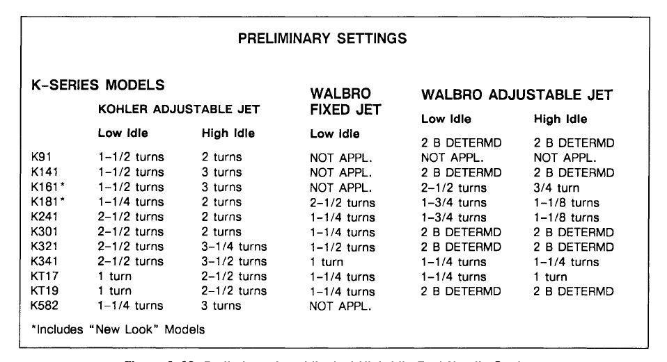

Howie 900 #6 Posted January 23, 2019 Initial settings on that carb is, 2 1/2 turns out on idle screw and 2 turns out on the high speed screw. High speed screw on top of carb, idle screw on side at an angle. Check point setting also. 3 Share this post Link to post Share on other sites
Mikey the Monkey 701 #7 Posted January 23, 2019 1 4 Share this post Link to post Share on other sites
953 nut 63,119 #8 Posted January 23, 2019 @Mikey the Monkey has provided the proper information on carb settings. If your engine has a battery ignition system with points they may also need attention, the points setting will also set your ignition timing. If tuning the carb does not clear the problem up let us know and we will fill you in on the points procedure. 2 Share this post Link to post Share on other sites
