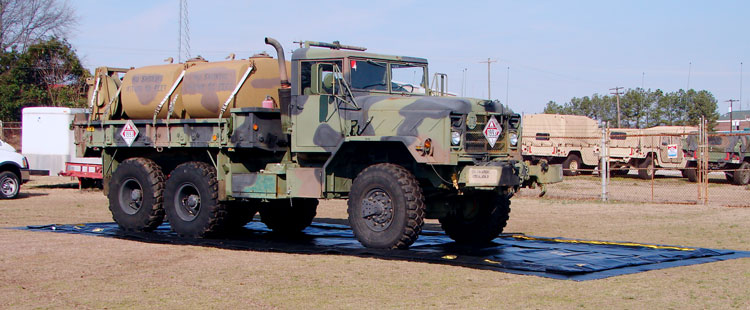

C-85 817 #18 Posted January 22, 2019 The fuel trucks we had in the US Army had a separate ground cable that we hooked to the vehicle being fueled. I always thought this was overkill, but maybe not. We had 5 Tons with fuel pods, similar to this but older. C-85 2 Share this post Link to post Share on other sites
