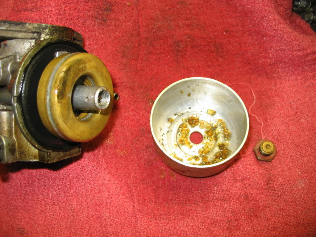

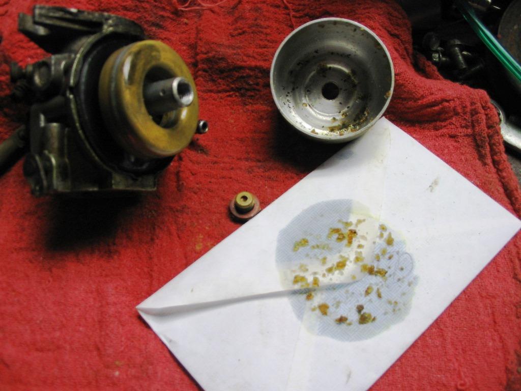

daveoman1966 3,884 #6 Posted January 20, 2019 Here is the result of ethanol gas... looks like corn is starting to grow in the carb bowl. Just imagine how the tiny jets get plugged with this sh... I tried using Stabil, but to no avail. Finally located a local Sheetz with ETHANOL-FREE gas. 4 Share this post Link to post Share on other sites

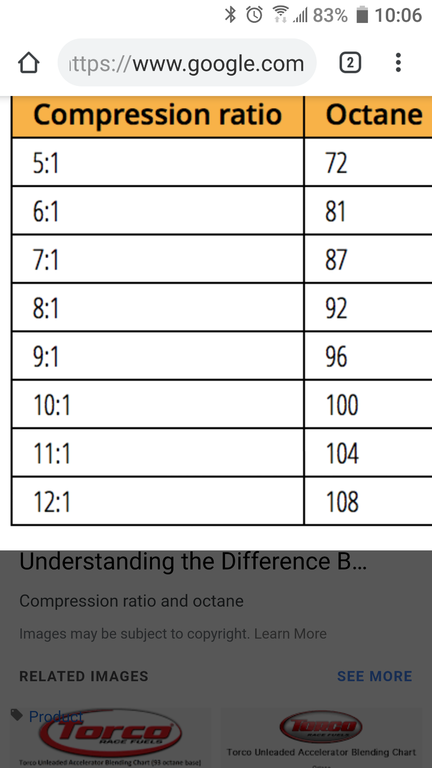

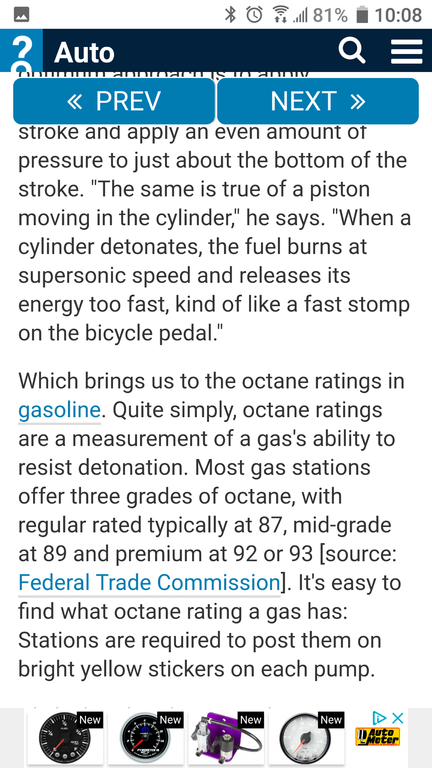

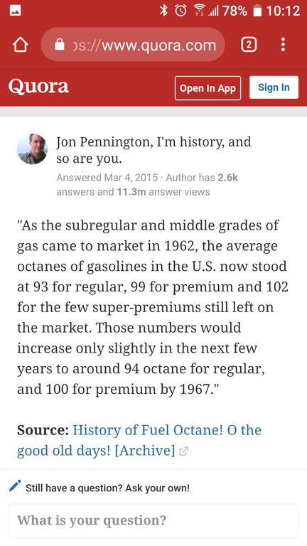

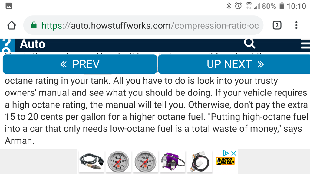

WVHillbilly520H 10,379 #11 Posted January 20, 2019 35 minutes ago, Eric S. said: Can not find ethanol free near me , Hunter don county NJ , but sky manor airport is only 8 miles . Some say too high of octane for the k Motors but that's what it was in the 60's and my horses have never run better . Hopefully they stay that way for the future . Also just food for thought , l have read numerous stories that the percentage of ethanol marked on pumps at gas stations are not always accurate and sometimes the so called ethanol free is not accurate . No issues at the airport . As they say today " Just Saying " Octane rating just means the ability of the fuel to resist detonation, whether is compression ratio ignition timing ect...i would prefer to only spend 1/2 as much for the fuel and still receive the same benefits. 4 1 Share this post Link to post Share on other sites
