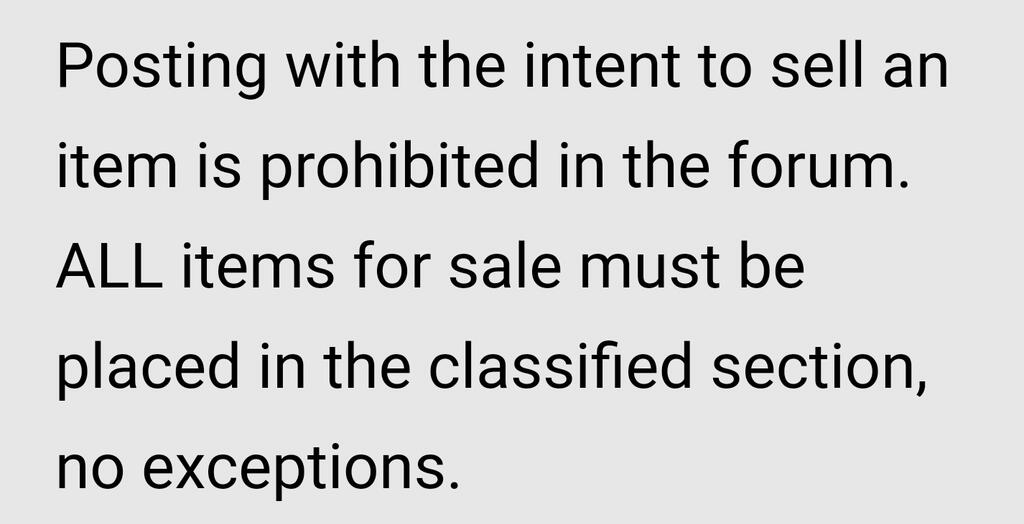

AMC RULES 37,259 #17 Posted September 18, 2020 (edited) Just phishing people. Reported to the moderators. Edited September 18, 2020 by AMC RULES Share this post Link to post Share on other sites
WHX?? 58,218 #18 Posted September 21, 2020 Me thinks @International Harvester works at Marine Surplus and is trying to move some inventory? Share this post Link to post Share on other sites
AMC RULES 37,259 #19 Posted September 21, 2020 Here's thinking they haven't read our forum rules. https://www.wheelhorseforum.com/guidelines/ Share this post Link to post Share on other sites
